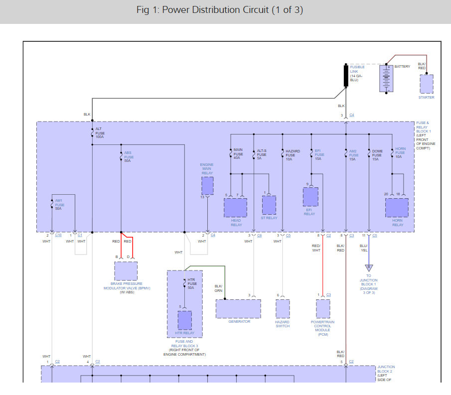

Finally, it started checking fuses. The 100-amp fuse was blown. Replaced that. Still would not start, but now we had power to most things but not all. The radio and dome light didn't work.
I went looking at more fuses and found the fuel injection fuel was bad - I think - it was a 15A fuse slot by the battery, and the cover said "EFI or F-HTR." Replaced that with a spare that was in the box.

We have a multi-meter and a test bulb. I don't know the proper way to use the meter. Or the bulb for that matter. I connect it to the ground on the battery and poke the little metal pins on the fuses.
For the bulb, it's weird. In the fuse box that is in the car, behind the change bin on the left of the steering wheel, there is a 15A fuse in there that doesn't light up. So, we replaced it with a fuse from under the hood that we know lit up.
Then, it didn't light up when we replaced it. Putting it back under the hood, it lit up.
Some fuses in the coin box fuse area do light up, but most don't. Does that mean they're bad fuses, or is there some sort of master fuse, that powers some of the box but not all of it.. Or do some of those fuses just not have power unless the car is on running, even if it has power?
There are lots of fuses that aren't lighting up with the light, but do not seem bad when you visually look at them. Again, I don't understand if they should all light up, or only some...

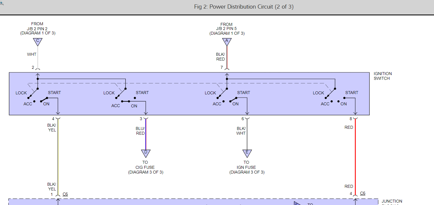

Can the anti-theft be causing this? It is not the type that uses a key fob. It is some kind of RFID thing that you hold up to a space under the steering wheel, wait for it to beep, and then you can start the car. The security system I mentioned is the ilock system. But I have no key fob with buttons and never have.
