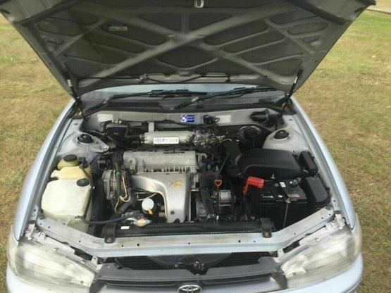

Car stalls while driving. Usually when doing under thirty seven miles per hour. No lights come on dashboard only when it stalls. Gives no warning that it is going to stall. I have to glide car to side of road. It does not do it all the time. It may stall then after thirty seconds I get it started then put it in drive, then stalled. I wait another thirty seconds and I have no problems, starts and drives no problems.

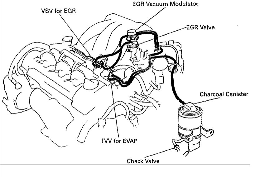

Does a 1996 Toyota Camry, four cylinder, 2.7 liter engine have a EGR Valve?
Sep 29, 2017 at 7:40 AM
  • 55,743 POSTS
Sure does.
Here is a diagram on its location and a video that shows how to test it:
https://youtu.be/DqUCbbKdWf4
Please let us know what happens and upload pictures or videos of the problem.

In this photo of my car where is the EGR Valve? I have looked at the diagram you sent and my engine looks different. Now the temperature control on the dashboard is showing a little higher than usual but still in the safe zone. I checked the radiator coolant today and it is a little low.
Sep 30, 2017 at 5:43 PM
  • 55,743 POSTS
It looks the same to me can you get a little closer to the engine intake manifold please. Please take as many pictures as needed to show the section.
