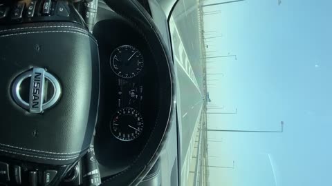

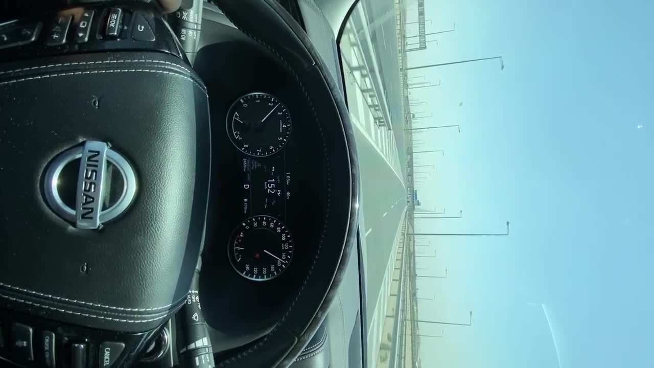

Thanks Kase for the prompt reply. however, it looks like I didn’t make myself clear in the original post so here I attached a video. As I am driving I lift my foot off the gas pedal when at 150 km/h and allow the car to coast freely gear shift is still on drive. I don’t apply gas or brakes the car starts slowing down so much feels like something is dragging it back feels so heavy and I notice the engine noise in the background as the car downshifts, eventually it’ll come to complete stop and if I press the gas again it’ll just accelerate. I have driven a lot of cars and they didn’t behave like this that’s why I feel something is wrong not to mention the erratic acceleration or the not so smooth gear shifting.
May 22, 2021 at 3:40 AM
That absolutely helps and I am going to totally reverse my opinion and say that this is normal. More modern vehicles have a bit more engine braking so depending on what you are comparing it to then it will feel like it is dragging.
However, the fact that it took close to a half mile to slow down to a near stop before you accelerated again then that is definitely normal.
If you are still concerned about it, you could just stop by the dealer and ask that you can drive another vehicle just like yours because you want to just be sure that one feels the same.
Thanks for the video. That really put us on the same page.

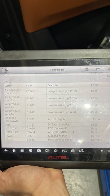

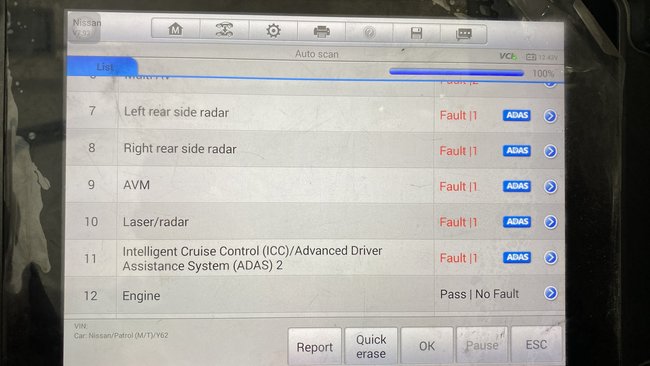

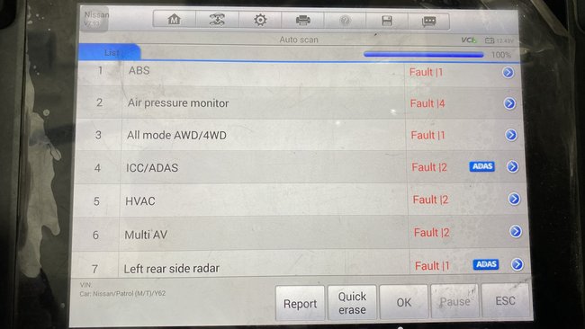

Thanks Kase, it’s great that now we are on the same page. There’s a development in my case, before I go to the dealer I decided to make OBD scan for the car and I got faults in the ABS system as shown in the photos. The technician who scanned the car told me it’s something minor probably programming error. He engaged and disengaged the “diff lock” system multiple times after that I drive the car and it feels very normal but I’m still confused to why there were faults in the ABS system showing in the OBD scan and no indication or warning lights on the car dashboard and what guaranteed it won’t happen again without indications. Anyway I’ll take the car to the dealer knowing for sure that there’s or at least there was something wrong with it.
May 23, 2021 at 7:43 AM
More than likely they disconnected something when they were inspecting it for the delivery to you when you bought it. Most of them look like they are no longer active or current so that means the issue is not current. This is why the lights would not be on. Those codes can stay in there for months as they are informational for the mechanic to look at when you bring it in. In other words, they want to keep the codes in there so that if the issue is not happening by the time you get to the dealer, the mechanic can still try and figure it out based on the codes that are in there.
However, I agree with you that this needs to go to the dealer and have them check it out. Please keep us updated with what they find.
