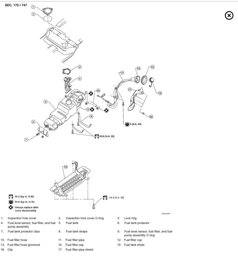

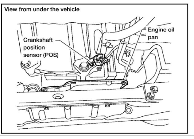

My truck keeps cutting off, it will drive fine, then the rpm will drop and the truck will cut off. Let it sit for 10 or so mins and it will start up. Drive maybe 5-15 miles and then it will do the same thing again. Tried 93 gas and i depressed the fuel value in the engine and no fuel, not a drop and no air came out.

It sounds like you have a classic crankshaft angle sensor that is going out. Here is a guide to show you what you are in for when changing the sensor and a diagram (below) of how to change the sensor on your car.

Here is a guide that will show you what you are in for when replacing the fuel pump
https://www.2carpros.com/articles/how-to-replace-an-electric-fuel-pump
Here is a diagram (below) on what it will be like on your car
Please let us know what happens, we are interested to see what it is.
