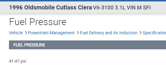

If you look at the pic below, it provides the manufacturer's fuel pressure specifications.

See pic below.
