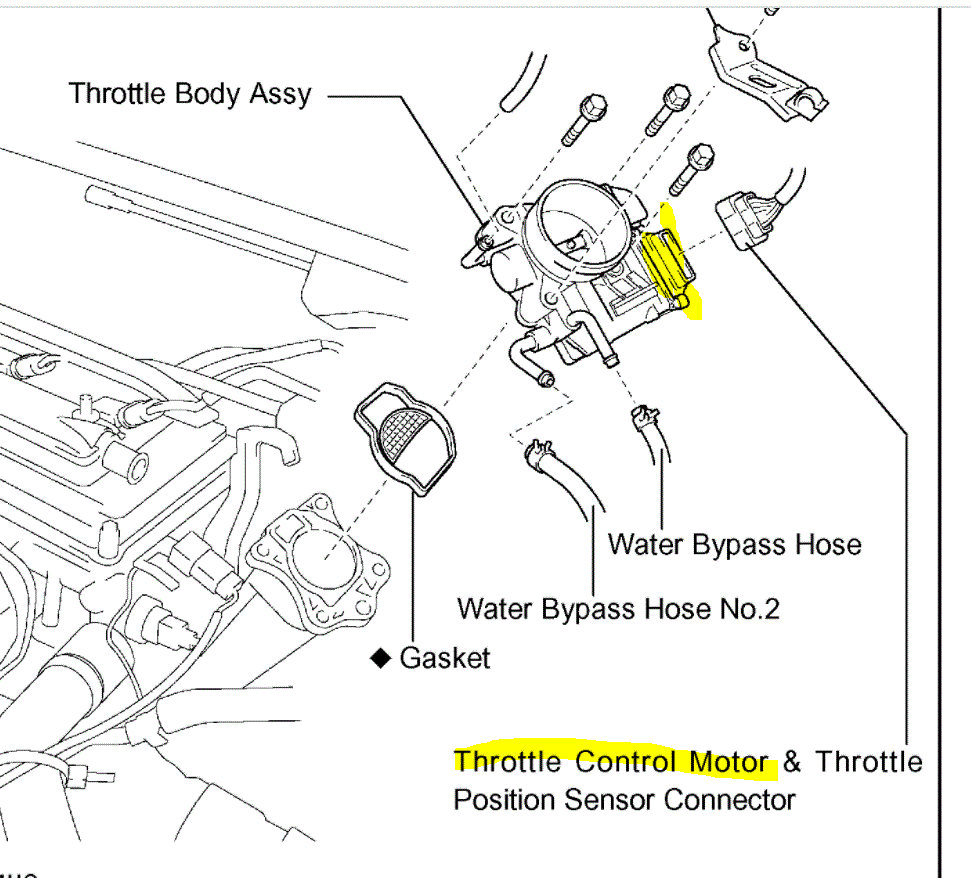

I have been in this problem for 7 months.
Replace fuel pump.
Replace ignition coil.
Replace all the spark plug.
Clean the fuel filter.
Clean the throttle body, RPM rise for a while, then later come down to 500 to 600. once you load A/C and gear to this idle when the car is warm car shake and stall. the car start immediately you start it. I am totally out of ideas.

The first thing I have to ask is if you have checked for diagnostic trouble codes?
Next, have you checked for engine vacuum leaks? If not, do that. Here is a link that explains how it's done:
Also, the throttle control motor may be failing and not responding or even a poor connection. Check to make sure the plug on it is in good condition, not corroded or damaged. See pic 1.

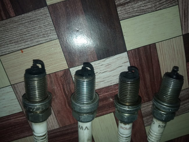

Thanks Joe, my mechanic called me on phone yesterday, said the car is working fine. so I quickly rush to the work shop, I start the car, and the car started. on my way driving the car spark plug car started misfiring. I called my mechanic, he said the spark plug are bad again, my platinum plug that is not up to 2 month. My question now is, what could be damaging my spark plug every week? whenever I put a new spark plug my car will work fine after one week the car will start misfiring or stalling, and the idle will also below 800 when the gear is engage. please what could be going wrong?

Wow, that shouldn't happen. The idea that it needs new plugs every week can be a few things, but I would need to know the condition of the plugs when they are removed. For example, are the black or oil soaked? Are the wet with fuel? Do they have excessive carbon on them? Did he mention anything like that to you? Also, if he replaces them, tell him you want the old ones back so I can see them.
Do you know if it is specific to a specific cylinder all the time?
Take a look through this link. It discusses how to replace spark plugs. As you page down, it shows different spark plug conditions and what the likely cause is.

This re the old spark plug, am changing this my self, I will put a new one to confirm the issue my self.
Sep 8, 2020 at 6:48 PM
  • 110,246 POSTS
They look oil soaked. Also, they don't appear to be a week or two old. When you replace them, make sure to use what the manufacturer recommends. Here are the specs for the plugs.
