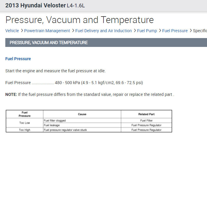

The starring issue could be due to fuel pump or fuel pressure regulator.
But not being able to drive is a transmission issue.
The fuel pressure regulator should keep pressure in the fuel lines when the vehicle is off, so when you crank the engine it gets fuel right away and starts within few cranks. But if the fuel gets drained back to the tank, then you will have to keep cranking it until the fuel reached the injectors.
Only way to know if the pump or regulator is weak or not working properly is to do a pressure test.
