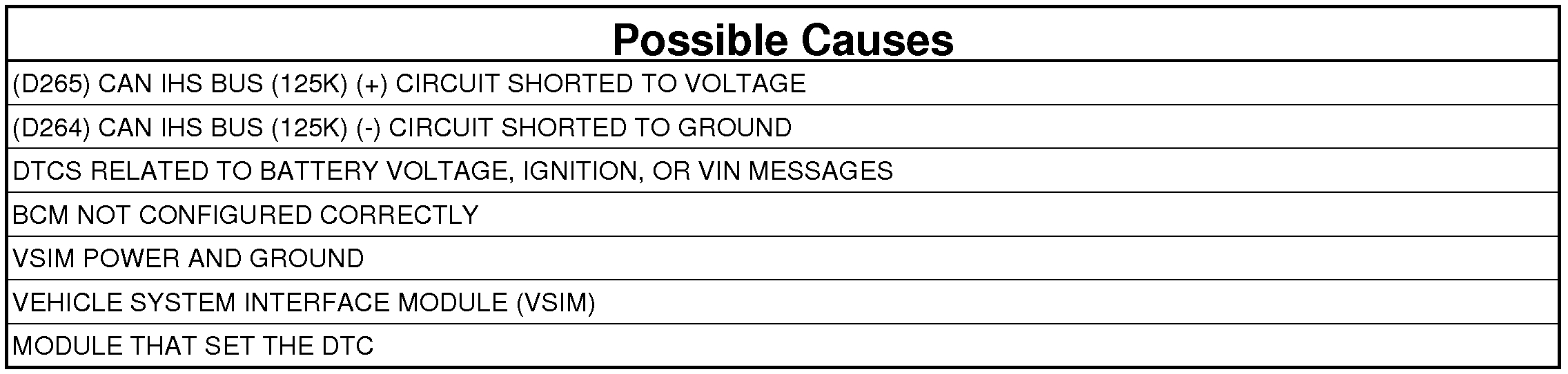

Hi Joe, so i tried turning A/C on while having the defrost and it does the same thing when i turn off the windshield defrost the car shuts off. I recently changed my A/C compressor could it be related to that ? I went back to my mechanic and he told me that it was changed correctly nothing is unplugged or nothing seems wrong. Does that mean the A/C compressor is malfunctioning ? When i scanned the check engine light it said something failed with BCM the error code was: u0143-00.

It could be the BCM, but the code could mean a few things. The CAN system (controller area network) could be the issue as well. If you look below at pic 1, it shows the possible causes for this code to set.
To determine the cause requires a good bit of diagnostic work. I will add the diagnostics for your review. Let me know if this is something you are comfortable doing and if you have the tooling.

8. CHECK THE (D265) CAN IHS BUS (125K) (+) CIRCUIT FOR A SHORT TO VOLTAGE
1. Measure the voltage between the (D265) CAN IHS Bus (125K) (+) circuit and ground.
Is the voltage above 5.0 volts?
- Repair the short to voltage in the (D265) CAN IHS Bus (125K) (+) circuit. The short to voltage is present in one of the CAN IHS Bus (125K) (+) circuits. Use the Star Connectors to isolate portions of the CAN IHS Bus (125K) (+) in order to locate the concern.
- Perform the BODY VERIFICATION TEST. See: A L L Diagnostic Trouble Codes ( DTC ) > Verification Tests > Body Verification Test.
- Go To 9
9. CHECK THE (D264) CAN IHS BUS (125K) (-) CIRCUIT FOR A SHORT TO GROUND
1. Turn the ignition off.
2. Measure the resistance between ground and the (D264) CAN IHS Bus (125K) (-) circuit.
Is the resistance below 10k Ohms?
- Repair the short to ground in the (D264) CAN IHS Bus (125K) (-) circuit. The short to ground is present in one of the CAN IHS Bus (125K) (-) circuits. Use the Star Connectors to isolate portions of the CAN IHS Bus (125K) (-) in order to locate the concern.
- Replace/update the module that set this DTC.
- Perform the appropriate verification test for the module being replaced See: A L L Diagnostic Trouble Codes ( DTC ) > Verification Tests. If there is no verification test for the associated module perform the BODY VERIFICATION TEST. See: A L L Diagnostic Trouble Codes ( DTC ) > Verification Tests > Body Verification Test.
