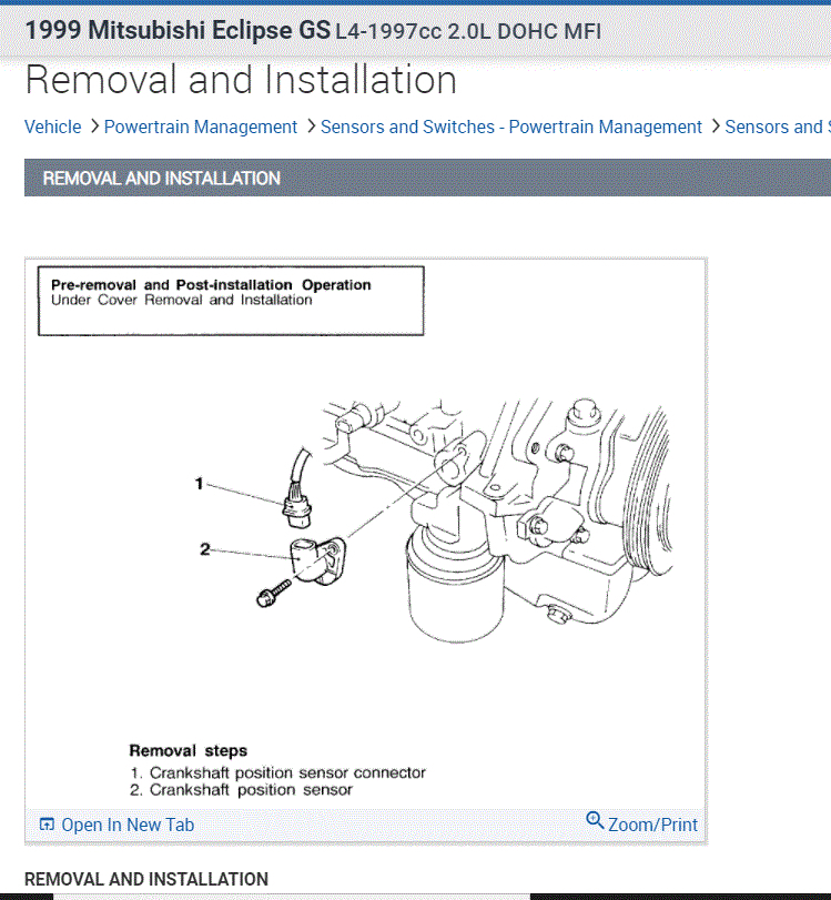

Was the fuel pressure tested when the engine would stall? If it was and it appeared good, then it sounds like you are losing the ignition spark. Does it start right back up after it stalls?
Do me a favor. Take a look through this link and let me know if anything seems to mirror what you experience. I have a feeling the crankshaft position sensor may be failing. When they start to fail, they are affected by heat.

If that is the case, this would be my first suspect. I attached a very basic pic below showing the directions and location of the sensor. Fortunately, it's an easy one to replace. It should be above the oil filter on the side of the engine.
Also, here is a link that shows in general how it's done:
I hope this helps. Let me know if it takes care of the problem.
See pic below.
