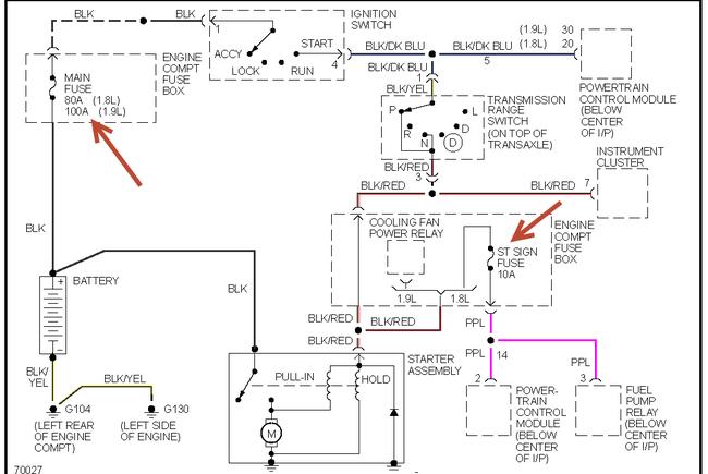

Car shut off while driving, now no electric, does nothing
JSHULTZ
  • 1995 FORD ESCORT
  • 4 CYL
  • 2WD
  • 130,000 MILES
Towed to shop, at garage, put in new brain, still the same, and they don't know what to do, could it be a fuse or a in line fuse, and where would they be located or could it be something else, car ran fine before it stopped, if cant fix, can not afford other car, can you tell me what to check, I need a wiring diagram

Try resetting the security system if you have one. Check the things in pic.
