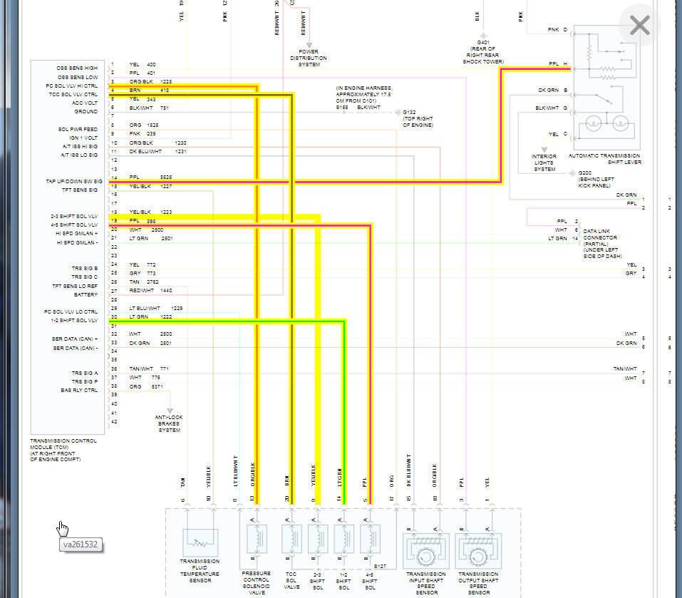

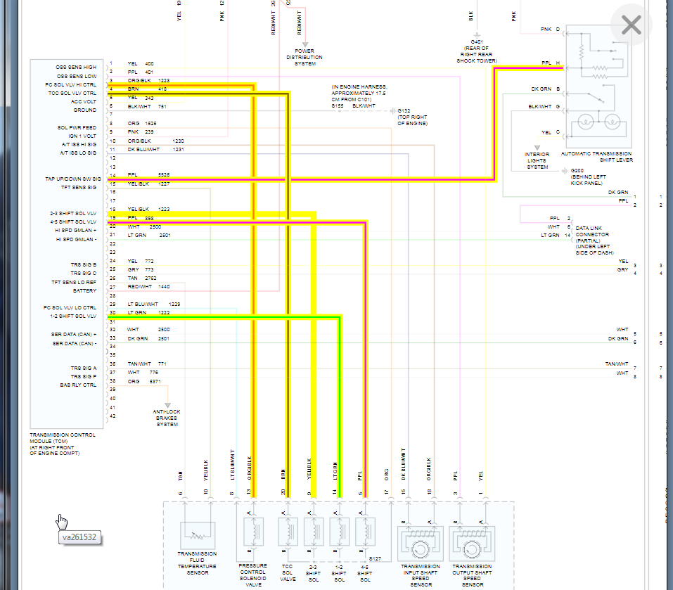

The car won't go in drive, it only revs up. When I go into manual mode however and shift to 2nd gear the car drives fine.
Oct 31, 2020 at 12:20 PM
When you hook the scan tool up, are there codes? If no codes, can you monitor the TCM and put it in gear. Does it show Drive or 1st gear as current gear?
If the manual gears are working but Drive is not then I suspect the TCM is the issue as the shift solenoids clearly are operating and the pressure is ok or it would still not move.
So we need to rule out a sensor issue or a TCM and we need a scan tool to do that. As you can see from the wiring diagram, the shift lever tells the TCM that it is in manual and then the TCM sends this signal to the shift solenoids. So as long as the TCM is seeing the shift to drive then it is not sending the signal to engage the solenoids.

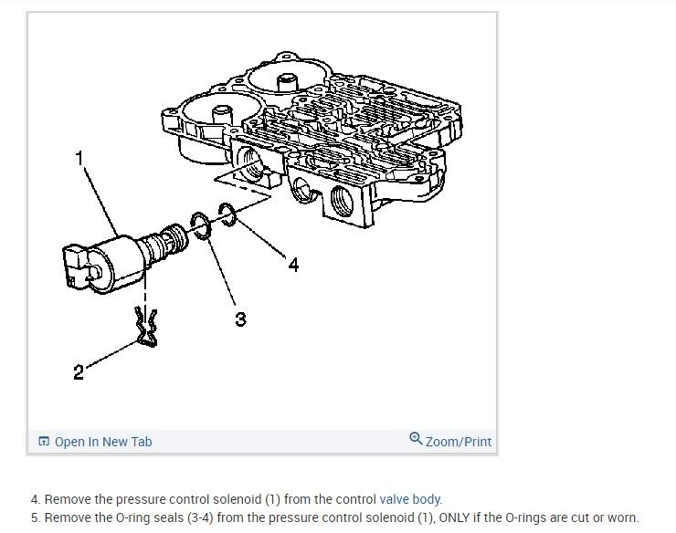

Mar 31, 2021 at 2:38 AM (Merged)

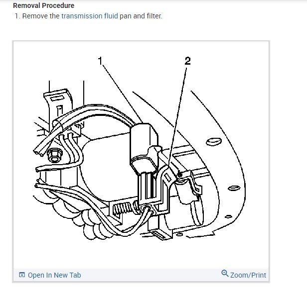

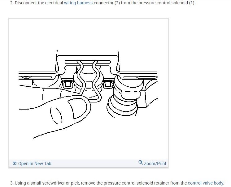

Okay, I attached the procedure for the pressure regulating solenoid. This could be your issue. The procedure with pictures are below.

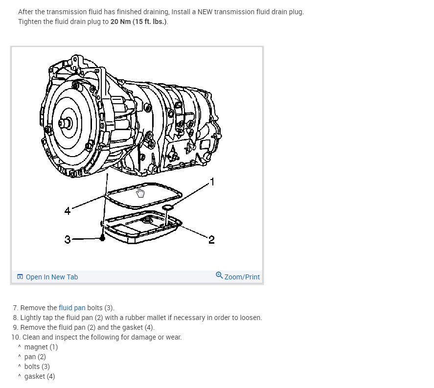

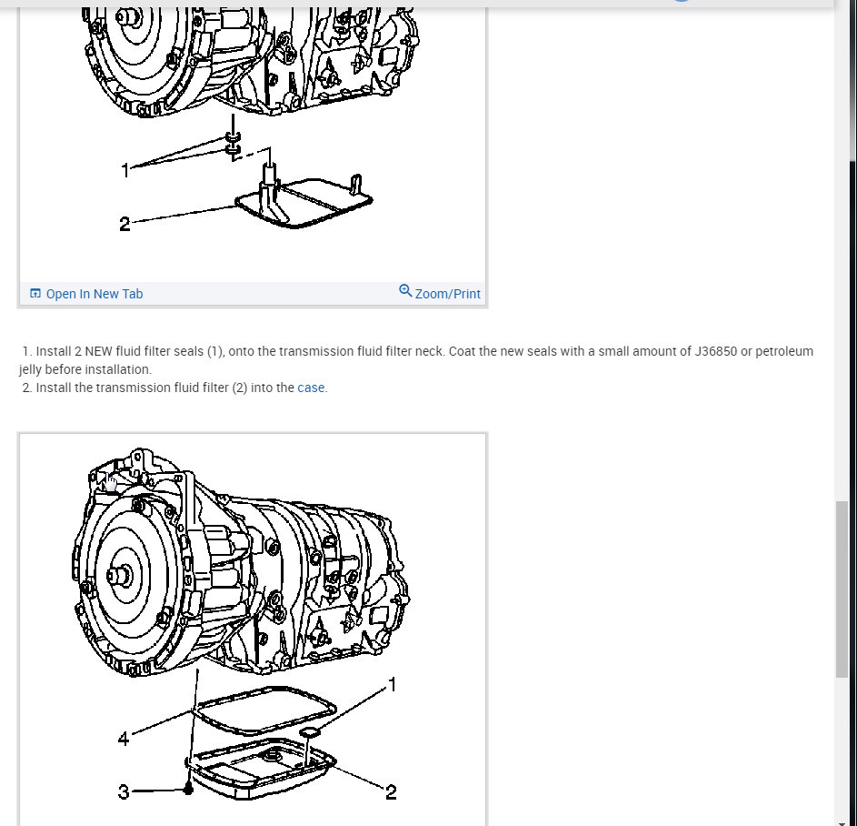

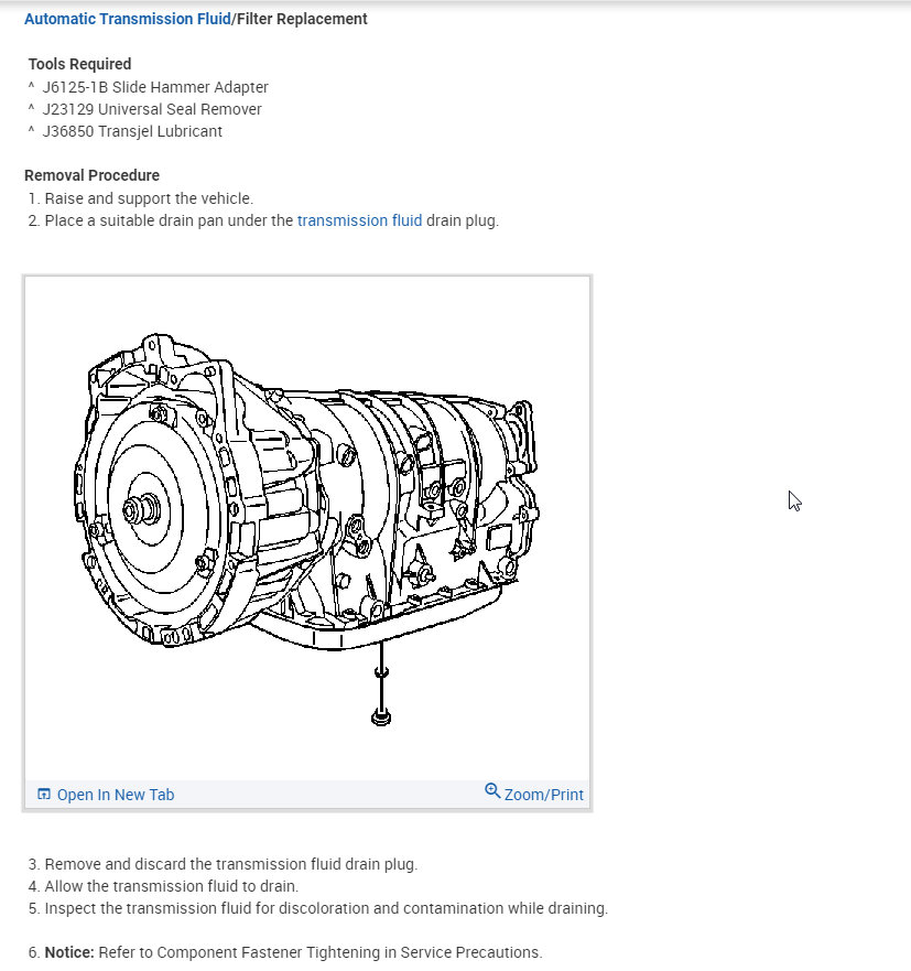

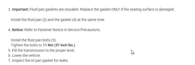

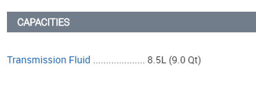

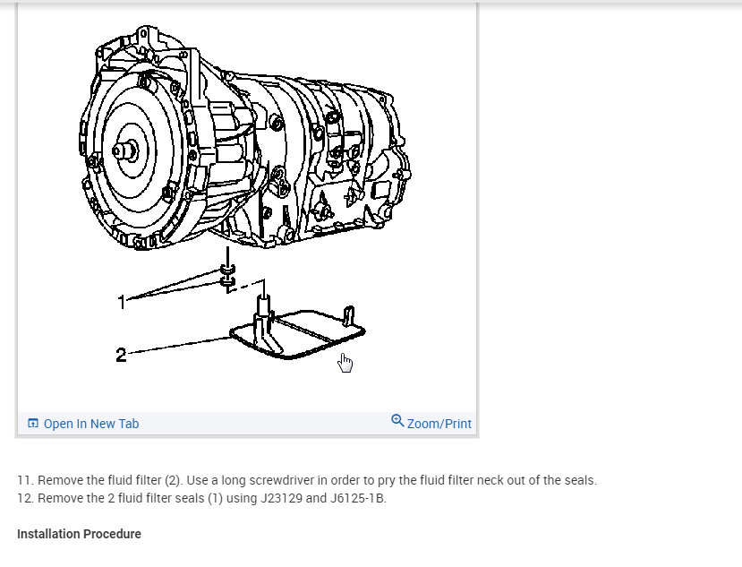

Clearly if it didn't go back into gear, you had to have it towed. Did you tow it to a shop or back home? Do you have the ability to check codes? If there are no codes then we need to check fluid level and see where it is and the condition of the fluid.
I included the process on how to change the fluid and filter if it is low or in poor condition.
