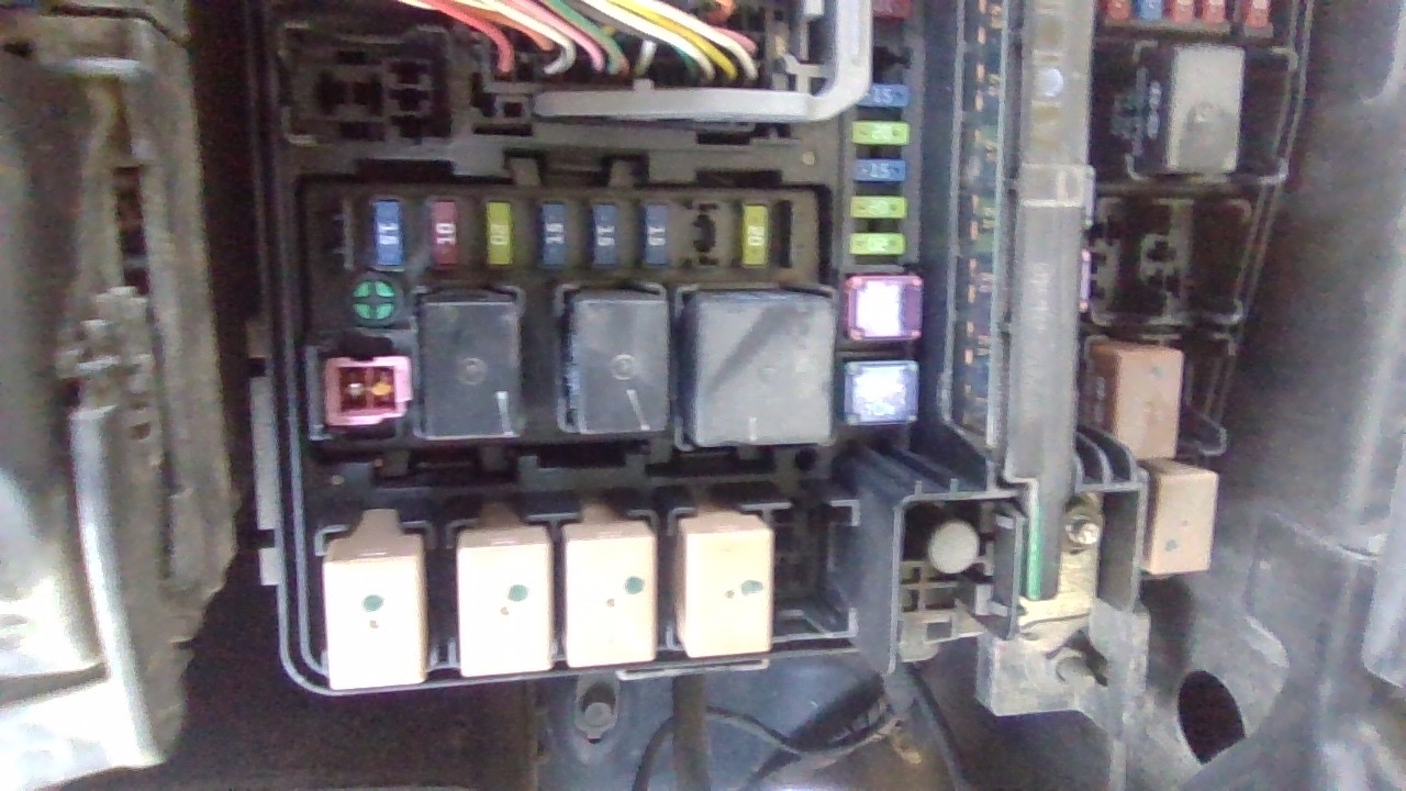

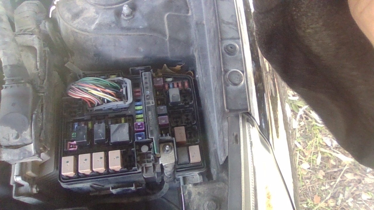

if i am not mistaken i have 2 relays missing Ig 1 Ig 2. the car set on the side of road over night.

and now all it will do is make a clicking sound when i turn the key over.

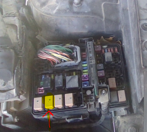

The starter relay is present. I don't know all the options the vehicle has, but chances are nothing is missing that is related.
When you hear the clicking, is it coming from the starter motor or a different location such as the relay? I copied your pic and highlighted the starter relay. Switch it with a different one having the same part number to see if it changes things.
Also, make sure the battery cables are tight and clean and the battery is fully charged.
See pic below.

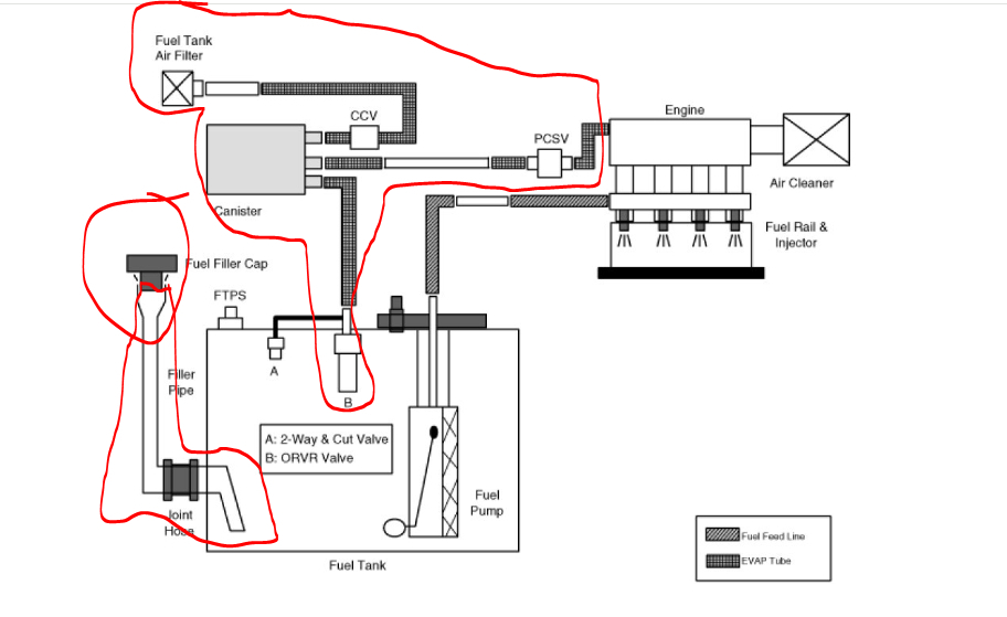

I used a live data plus scanner and got only one code P0455 emissions.
Jan 11, 2024 at 6:00 AM
BECKY UNDERWOOD
  • 5 POSTS
I will change out the relay you suggested and make sure battery is charged and cables are tight. i will get back with you ASAP.
Thank you for your help.
Jan 11, 2024 at 6:01 AM
  • 110,251 POSTS

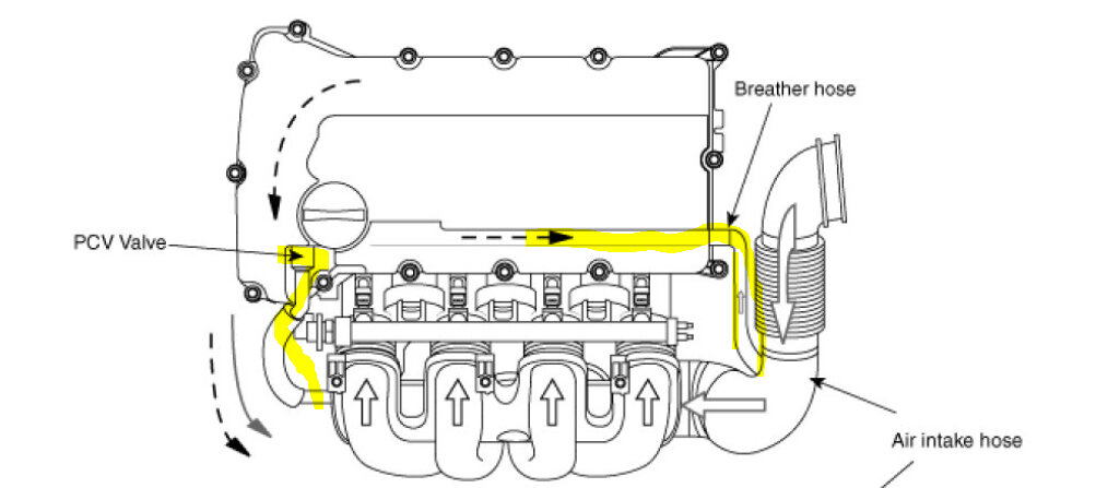

The code indicates a large evap leak. This is usually because the fuel cap is bad or missing, the fuel filler to the tank is faulty, or there are fuel vapor hoses off in the system.
I don't feel this would affect the transmission, but it could and would affect drivability as far as how the engine performs.
I attached two pics below. I circled or highlighted areas of interest for the leak.
Let me know what you find or if you have questions.
