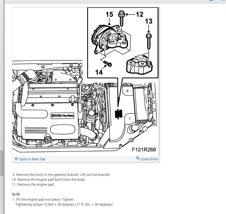

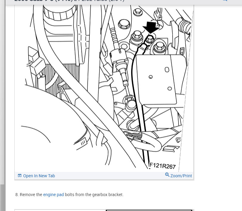

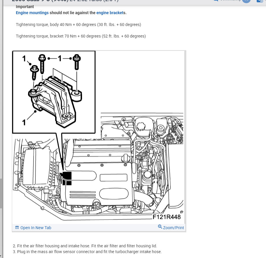

Just to jump in, I think he is talking about a worn-out engine mount or transmission mount. This is correct that this would be the most likely cause of this issue.
https://www.2carpros.com/articles/how-a-motor-mount-works
I am attaching the info from the manual on these mounts. I would put the vehicle in gear and watch the engine and see if there is much movement when it is going into gear.
Please let us know what questions you have on this. Thanks

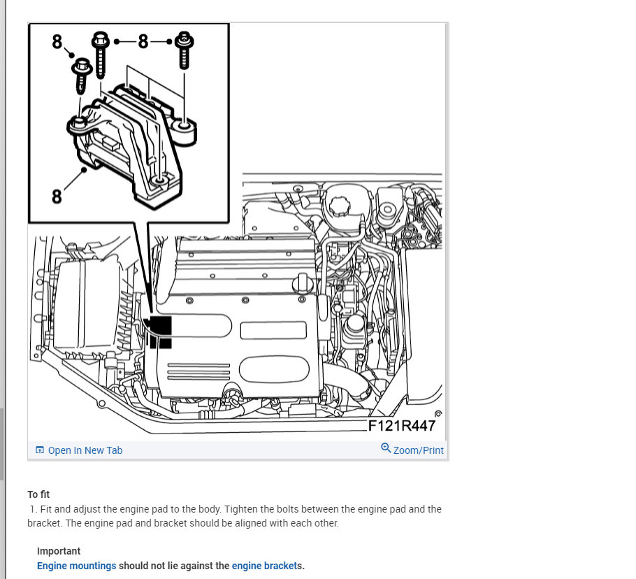

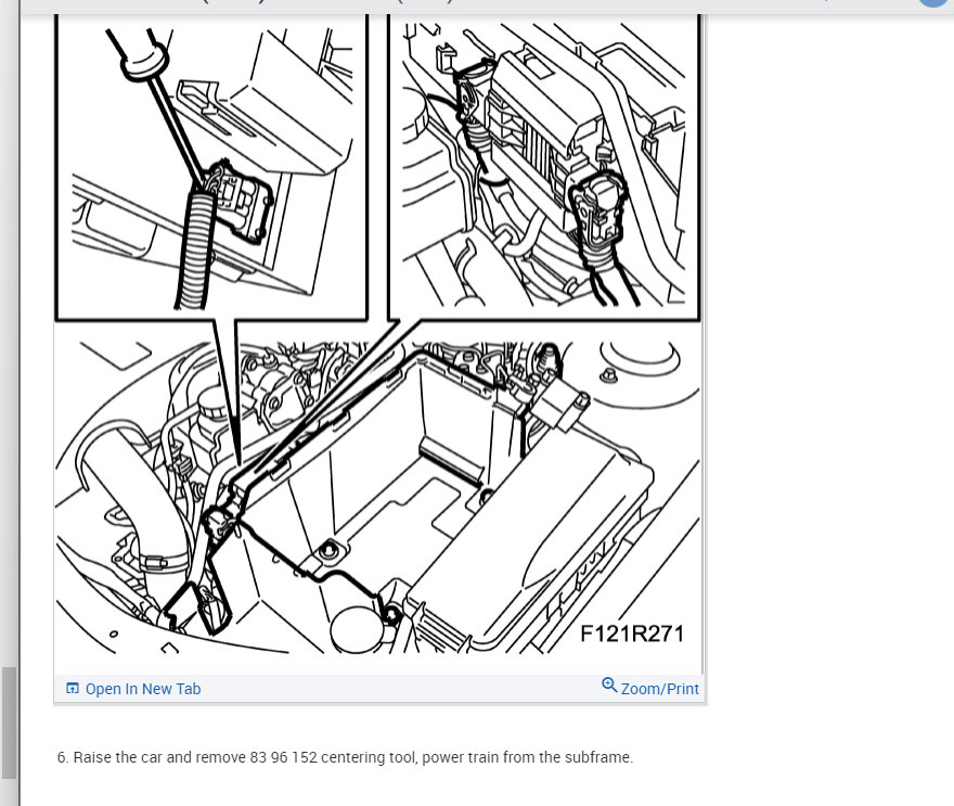

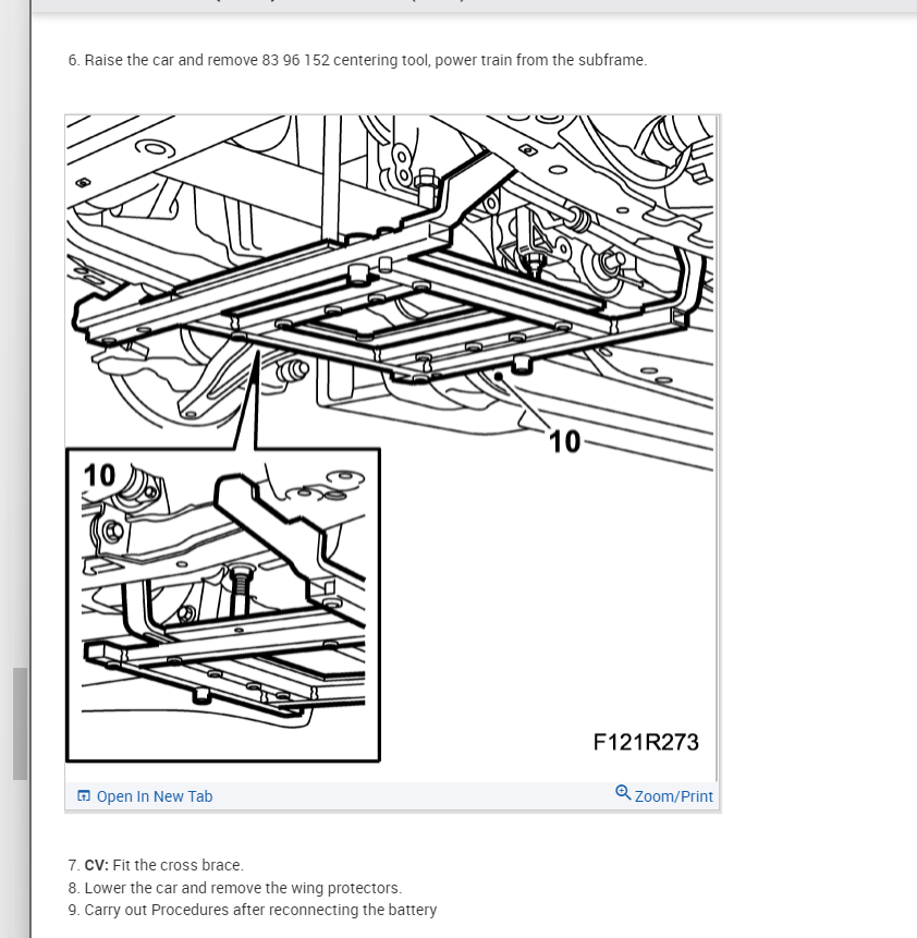

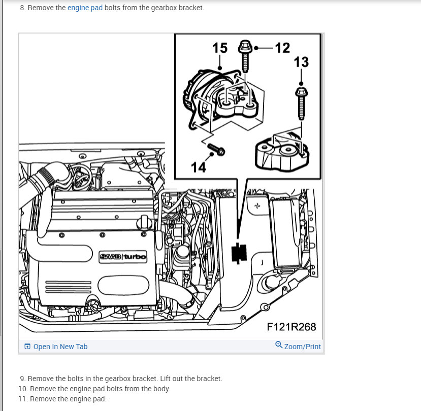

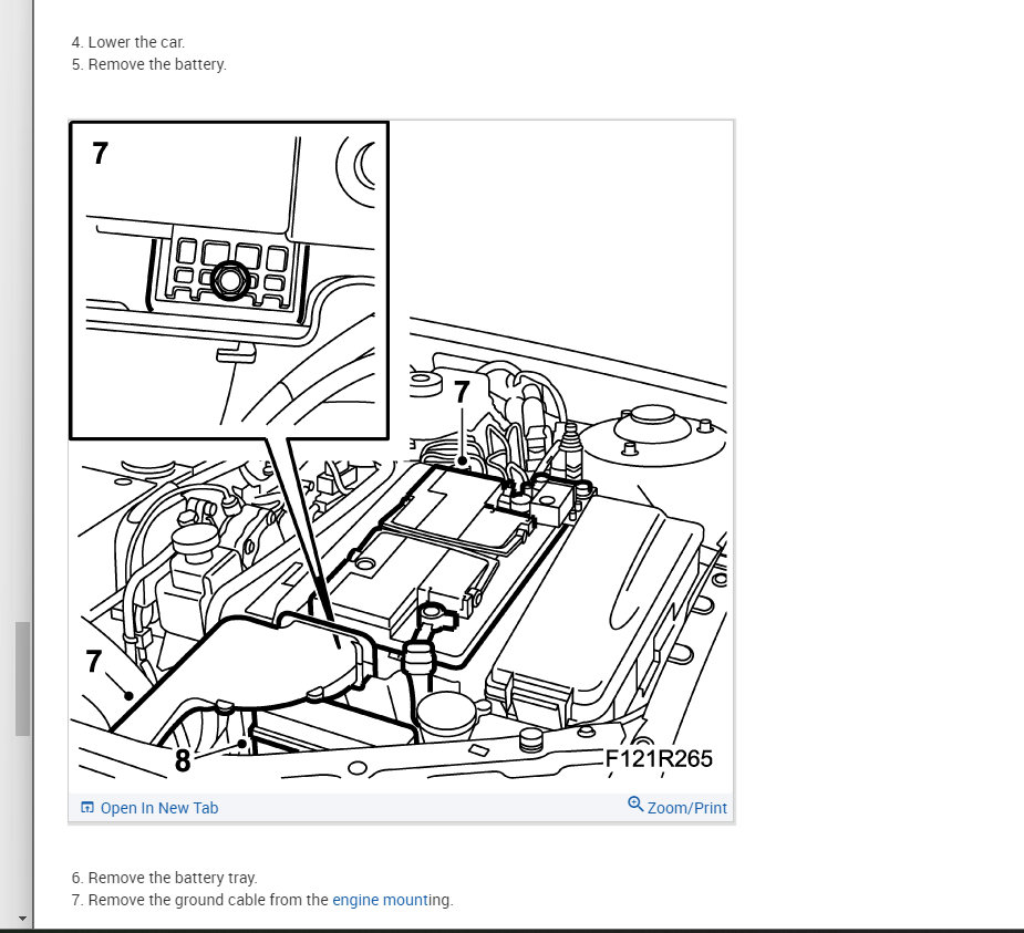

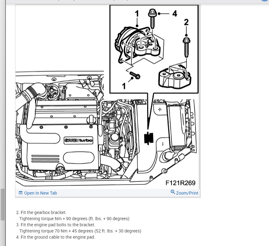

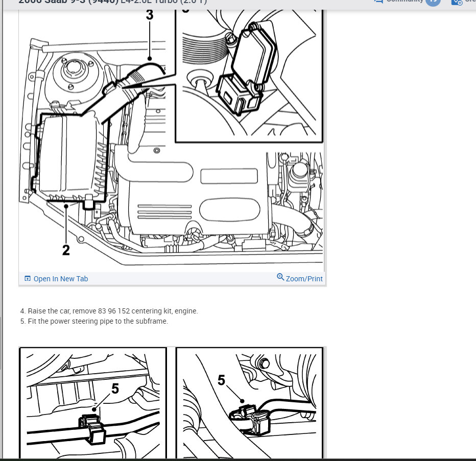

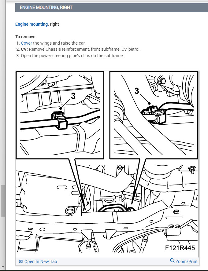

Take a look at the attachments below. You have a mount on both sides of the engine and transaxle.
Normally you have one on the back side as well, but it looks like this Saab only has the two.

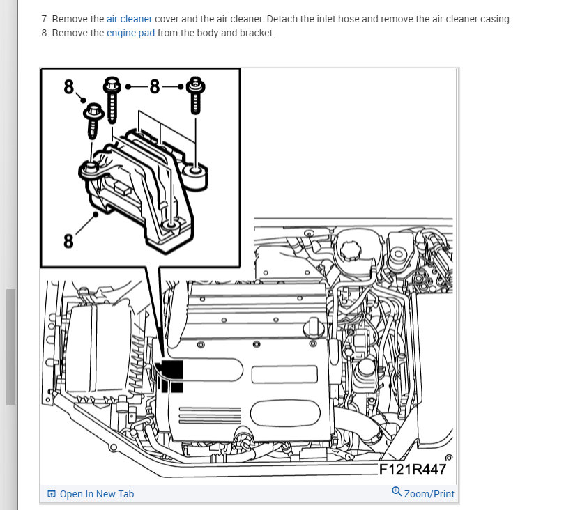

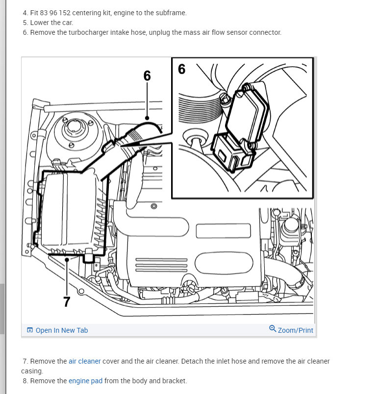

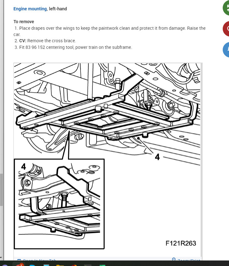

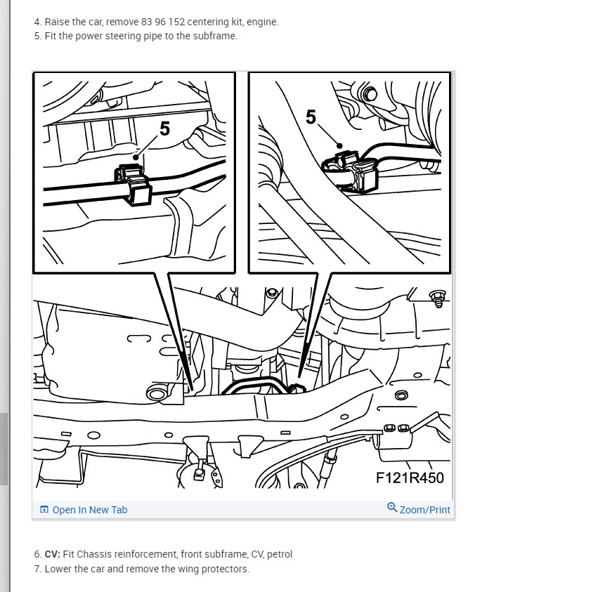

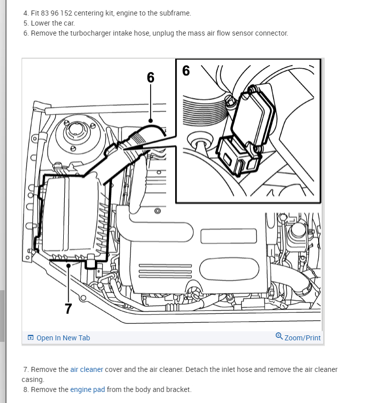

I attached the locations above because I would suggest inspecting them first, but I attached the complete process below for both mounts.
Let us know what you find. Thanks
