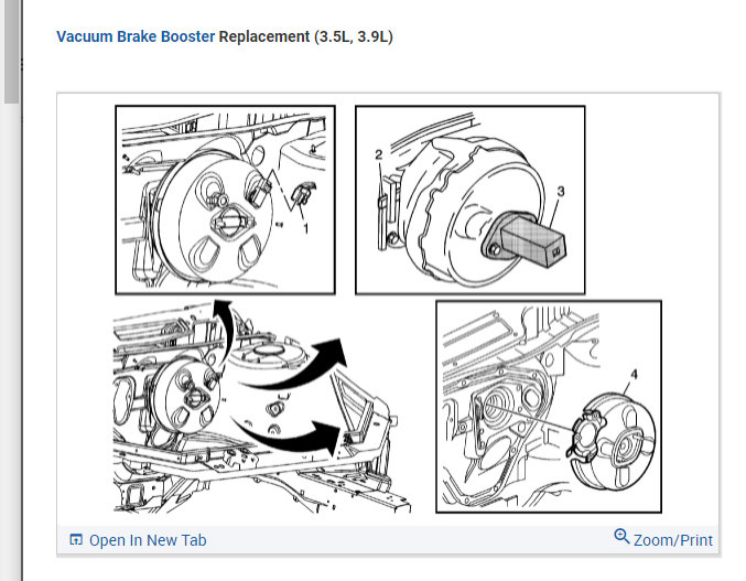

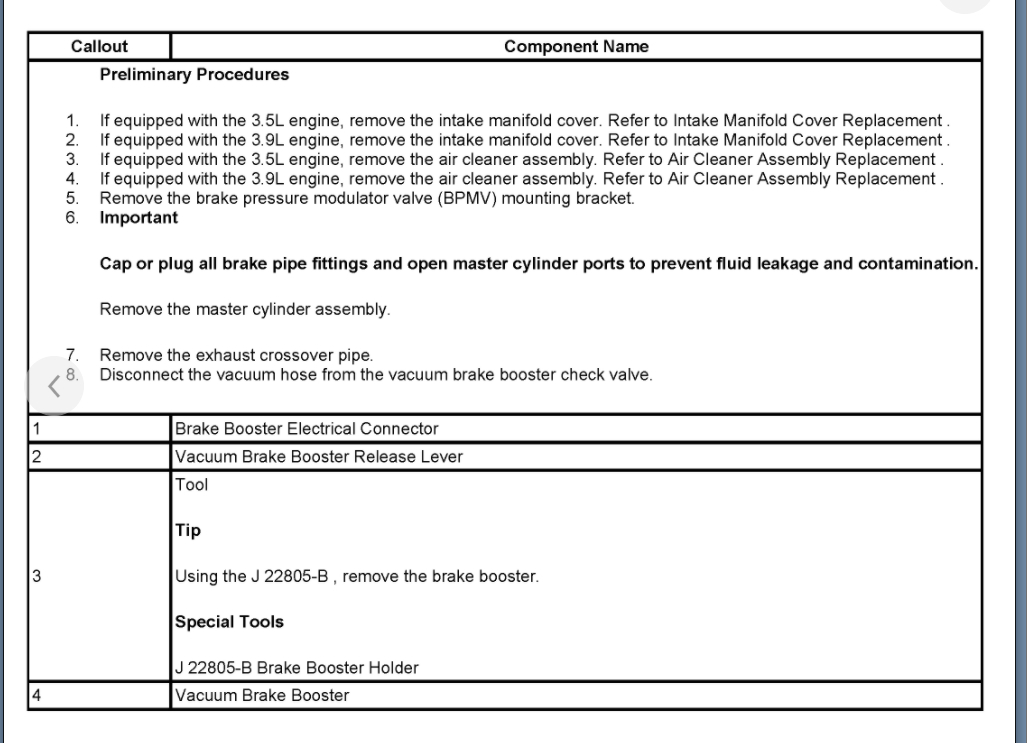

Good morning,
I would take a pair of vice grips and clamp off the line that goes to the booster. With it clamped, check and see if it still stalls.
If it does not, it is the booster.
Just be careful when driving this as you will have manual brakes so do it in a safe location. However, it will prove out a leak internal to the booster. Basically when there is a leak it bleeds off engine vacuum and causes it to be unstable.
If it does then we need to look elsewhere.
Below is the process from the manual on the booster. Let me know what you find. Thanks

I did the test you recommended. The car stalled after clamping the hose so the brake booster is good. It didn't stall immediately but it stalled after about 15 seconds.

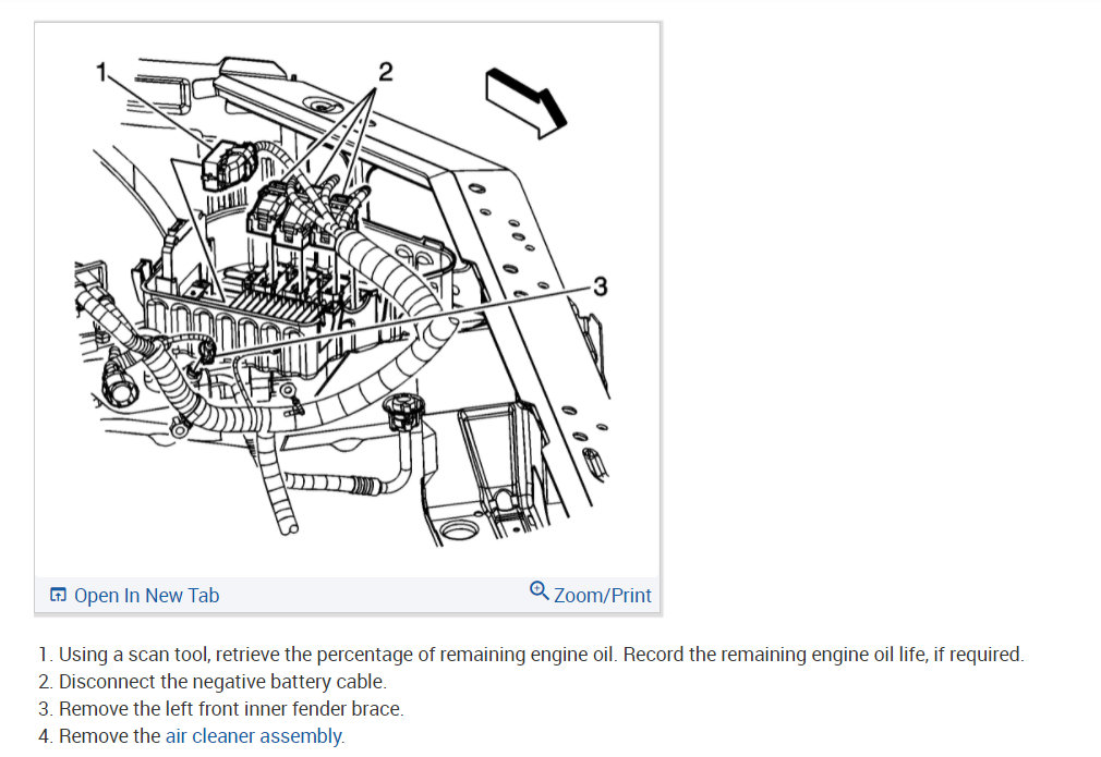

So I've learned that the two computers in the air intake are the PCM and the transmission ECM. I'm assuming the lights would run off the PCM right? Another question, do both have to grounded to the chassis of the vehicle?
Aug 12, 2021 at 7:20 PM
The lights are controlled by the body control module.
This is a separate control module for the control of all body functions.
Aug 12, 2021 at 8:11 PM

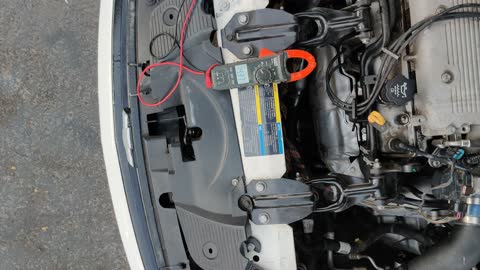

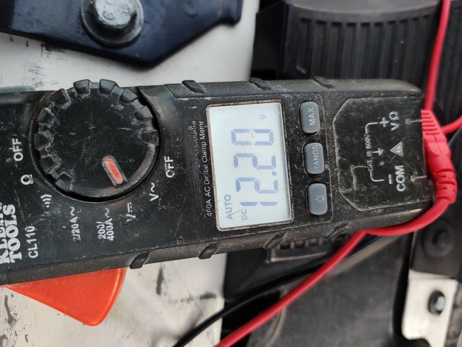

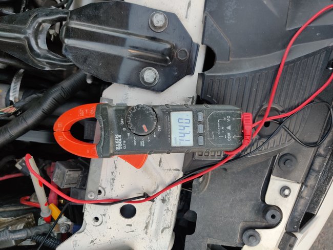

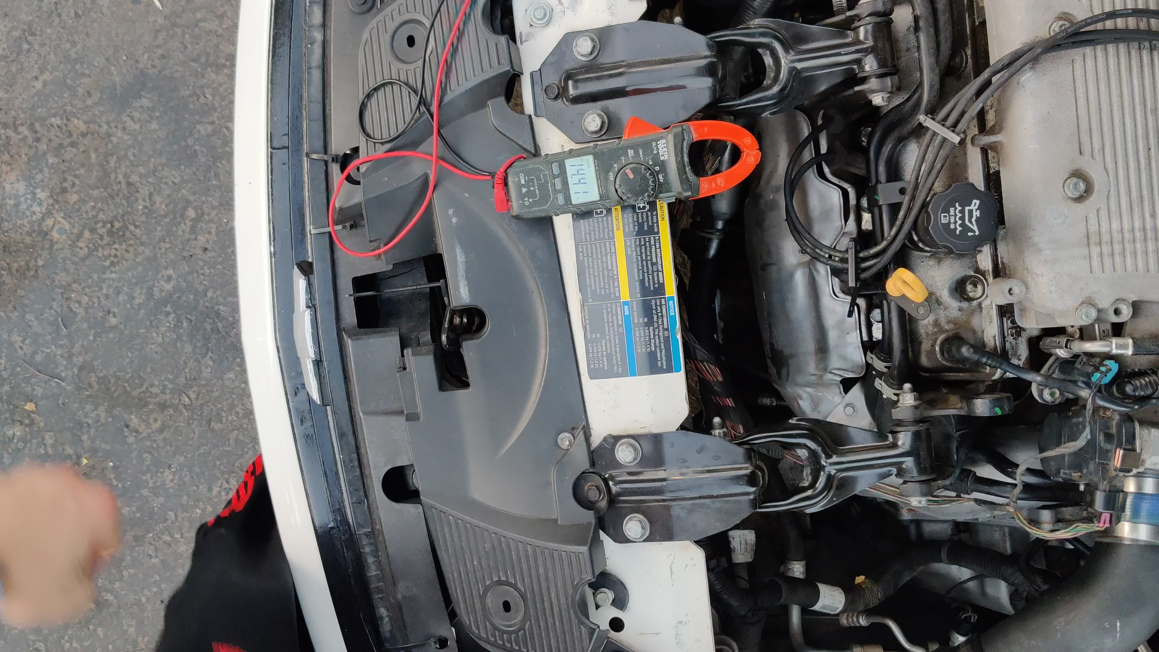

In this video I have a voltmeter hooked up to car while I turn the headlights on and cause the car to stall out from the electrical draw. As you can see the battery hold above 12 volts after it stalls, and it stays above 14v while running so the car isn't losing its power at all but yet it stalls out whenever the car draws power.
Picture 1 is while vehicle is off. Shows at 12.20 volts. picture 2 is while running, shows at 14 volts and then the video of voltmeter as I turn the headlights on and car stalls from electrical draw.
Aug 21, 2021 at 12:07 PM
The alternator stopped working when it stalled and the voltage went back to battery voltage.
This is normal. There is nothing there for that.
Aug 21, 2021 at 7:19 PM

Can you put a voltmeter on the under hood fuse block and measure the voltage at the block?
Want to make sure you are not losing voltage.
Aug 27, 2021 at 7:13 AM
QM1K
  • 16 POSTS
Okay, where on the fuse block u want me to meter?
Edit:
There doesn't seem to be any voltage drop. Just stalls out and runs real rough when electrical load is drawn. It stalls so fast once the headlights are on but I don't see a voltage drop while it's idle with lights off.
Aug 27, 2021 at 9:07 PM
The main power wire from the battery. I want to see if the voltage is dropping off when there is a load put on.
Aug 27, 2021 at 9:13 PM
QM1K
  • 16 POSTS
Okay, the main positive into the fuse box doesn't voltage drop at all. Stays at 14v while running and then after stall out drops to 12v. Could issues be pertaining to PCM not being properly grounded to chassis?? I was checking everything out and noticed that when I pushed down against the PCM (while the harness is plugged into it) the car will click and make noise. Then when I stop pushing it against the frame of the car the clicking will stop. Could be a wire shorting out at PCM? Or the PCM ground itself??

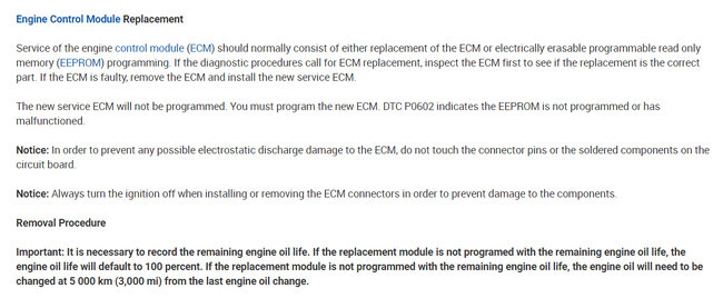

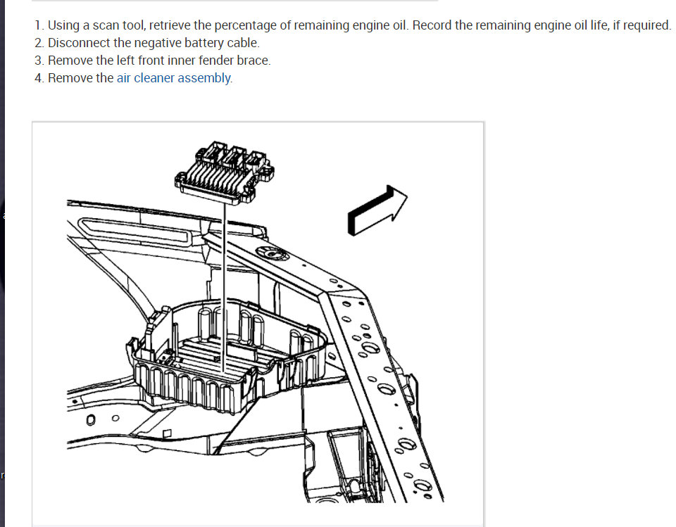

This very well could be the ECM. If you push down and something clicks, the board inside may be damaged.
I would suggest replacing it.
Aug 29, 2021 at 2:21 AM
QM1K
  • 16 POSTS
But if I replace the ECM then I'll have to program a different key for the car to start right? I'm also thinking it could be wires shorting out not necessarily bad ECM. it's an ex cop car I bought from auction so the amount of exposed wires is unsettling and I definitely see there being a possibility of the wires having weathered and frayed at the harness.. there's just so many wires I don't know where to start with it... What if I was to solder a wire to the ECM and then ground to chassis?
Sorry for all these questions but I really do appreciate all your replies after all these weeks, lol.
Aug 29, 2021 at 12:52 PM
The process is correct. Flashing is required.
No to a short or it would do it all the time.
Aug 29, 2021 at 6:11 PM

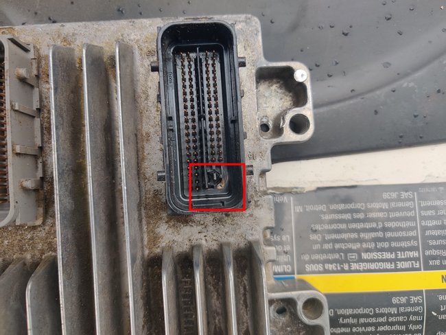

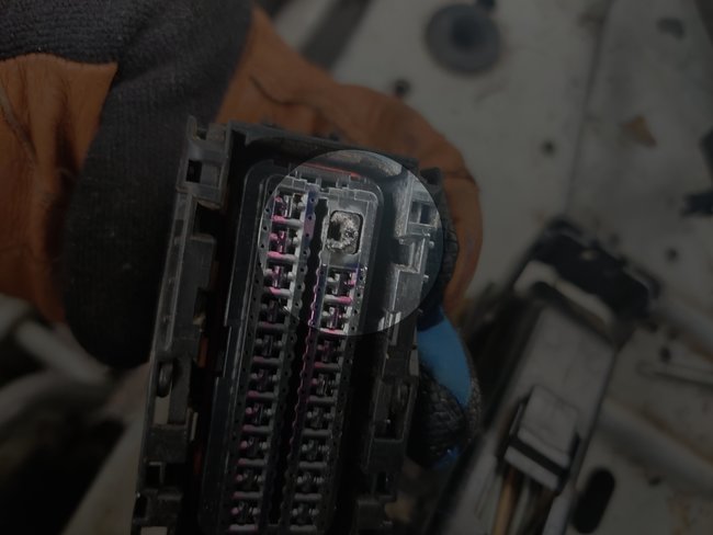

QM1K
  • 16 POSTS
Hi Roy,
Hope you're doing well. So, I've had some more free time to inspect the Impala to try and figure out this issue. Upon inspecting the PCM it does look like there's been a short circuit at the PCM and harness.
I have tried to swap out the PCM with a replacement from a junkyard but of course the VIN reads different, and this engages the anti-theft system to not allow the car to start.
I've come across a couple instructional that say to leave key in ACC for 10 minutes. as soon as anti-theft light goes away turn key to off position and try to crank again. Do this three times. And that should allow the car to crank. Although the
replacement PCM would still need to be programmed at least the car would drive.
The anti-theft light goes off after ten minutes but doing this process three times doesn't appear to by bypassing anti-theft...
Is there a step I'm missing in bypassing anti-theft?
If what I'm trying to do won't work, then can I jump the signal from a secondary PCM for only the ground connection that short circuited?
