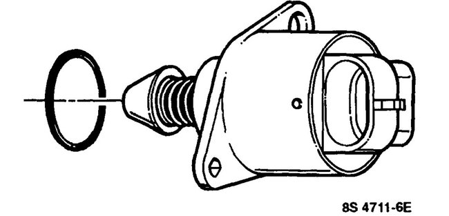

Also, there is an idle air control motor that does regulate the idle speed. Check the connection as well.
https://www.2carpros.com/articles/how-to-replace-an-idle-speed-control-motor-iac

You may have a bad idle air control valve in the throttle body.
Apr 15, 2019 at 7:12 PM
ADAMFASCA
  • 50 POSTS

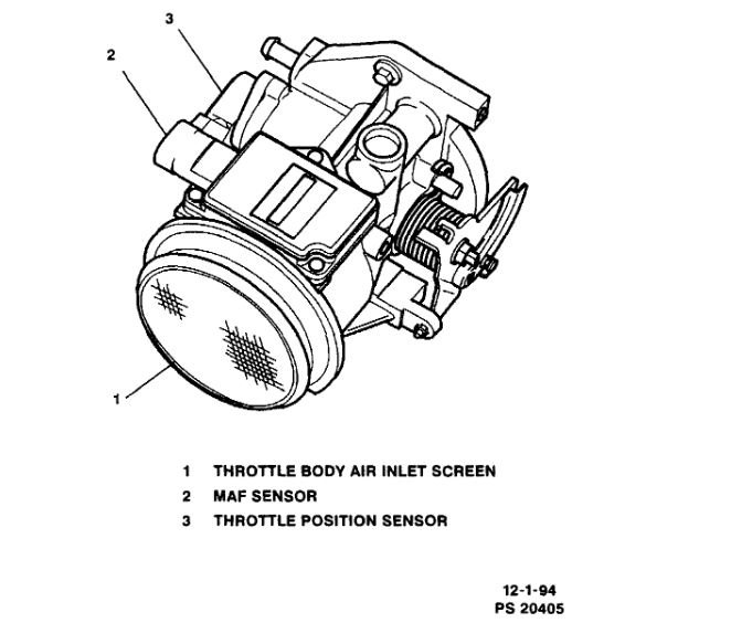

Mine was on top and I replaced today brand new and same issue. I do have a code for the TPS now would that cause this issue?
Apr 15, 2019 at 7:27 PM
If is not adjusted correctly yes.
Apr 15, 2019 at 7:35 PM
ADAMFASCA
  • 50 POSTS
If I buy a new one does it have to be adjusted?
Apr 16, 2019 at 4:43 AM
Generally, no.
It just bolts on to the throttle body and there are no provisions for adjusting.

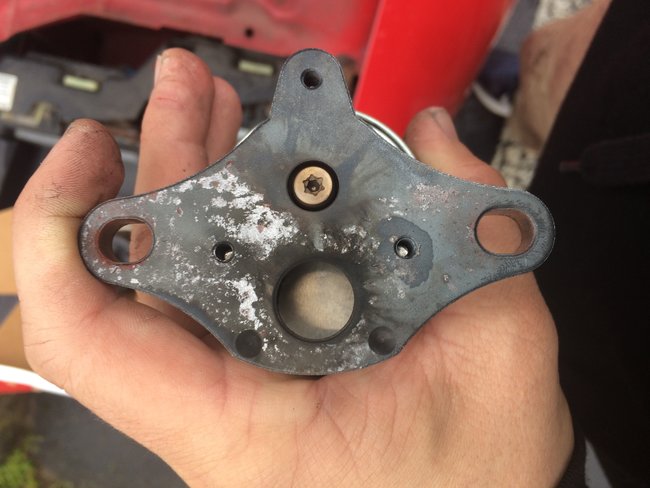

I sprayed the EGR and the engine sounds quieter and smoother. I almost sprayed too much and it was slowing down the engine. is the EGR sucking in air?
Apr 18, 2019 at 2:08 PM
Yes, as it may be partially open when it should be closed.
Remove it and inspect it and if you can, send me a picture for me to view.
Apr 18, 2019 at 2:14 PM
ADAMFASCA
  • 50 POSTS
The area of the EGR valve it revs up.
Apr 18, 2019 at 3:38 PM
ADAMFASCA
  • 50 POSTS
There is no gasket under the EGR.
Apr 18, 2019 at 4:13 PM
The black indicates it is leaking. I would replace it and the gasket.
There should be a gasket. That could be the issue.

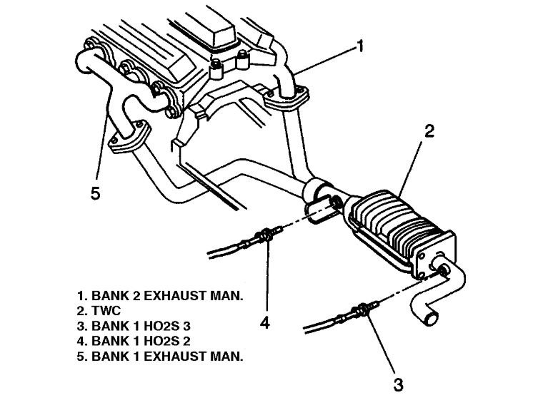

Thanks for the help. How many O2 sensors does a 97 camaro 3.8 & what does the purge valve get connected into the electrical and the intake but what’s the last one?
Apr 21, 2019 at 5:23 AM
Okay, I attached a diagram of the sensors and the location.

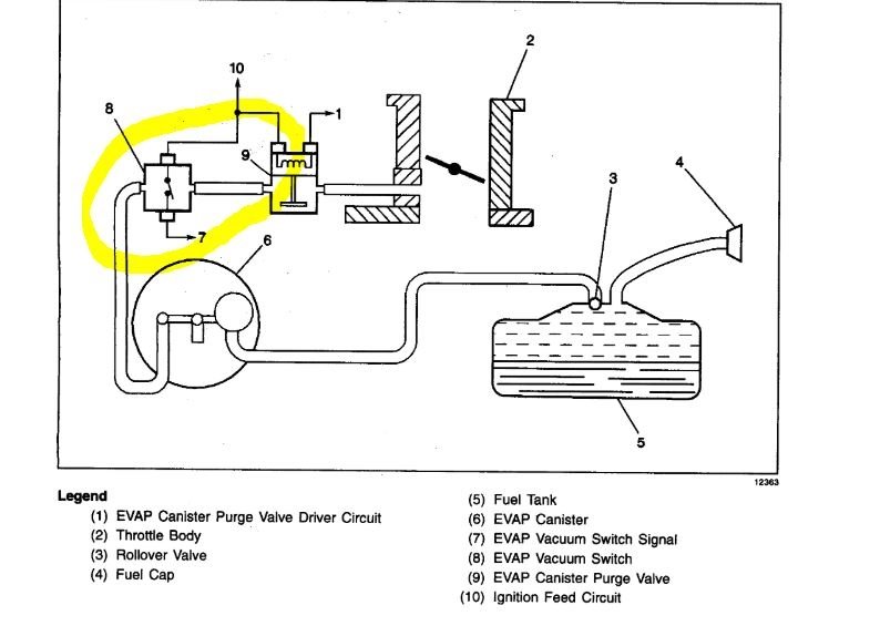

Great on the diagram. The car was missing the purge valve I connected the electrical and to the intake. Does another hose get connected?
Apr 21, 2019 at 6:22 AM
There should be a hose that runs back to the fuel tank. It is a vapor line not a fuel line.

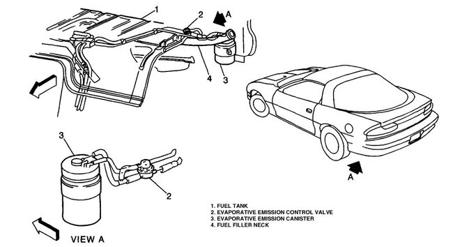

Where is the EVAP canister located?
Apr 22, 2019 at 4:26 AM
Under the left rear of the car. I attached a picture for you.

Okay great, the vacuum switch that connects the vapor line has a electrical connector but also has a wired metal circle along with it where does that go?
Apr 22, 2019 at 10:55 AM
ADAMFASCA
  • 50 POSTS
Okay great, the vacuum switch that connects the vapor line has a electrical connector but also has a wired metal circle along with it where does that go? 2. My wipers off position is straight up. They work perfectly one day I was playing with battery a lot and they finally went down then when I used them again they went right back up
Apr 22, 2019 at 11:36 AM
Please attach a picture of the canister.
