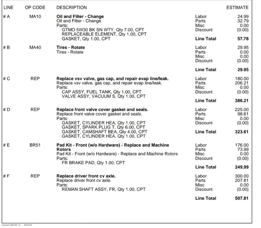

I had an engine and VSC track light on. A bunch of repairs suggested by service center. .

These are the things which are needed for repair. Can you suggest if the cost is okay, and I want to run this car for 3-4 years so should I make this investment my main concern is even after doing all the repairs will I run into additional issues in future.
Jun 20, 2022 at 7:02 AM
SQM
  • 6,383 POSTS
The list consists of typical maintenance and ware and tare items. Like the brakes, oil change, CV axle, and valve cover gasket (likely due to oil leak).
If you are experiencing noisy brakes, oil leak etc. It will be necessary to perform these repairs. However, repairing these won't prevent other components from going bad. So, fixing these will only help with these components and can still have issues for item parts.
One thing you can do is to call around to a few shops and get some prices/quotes. That way you will know if you are being quoted fairly.
If you plan to keep the vehicle for a few more years, it could be a good idea to have these repaired. Just keep in mind that it will not prevent other components from going bad.
Hope this helps.
Jun 20, 2022 at 7:09 AM

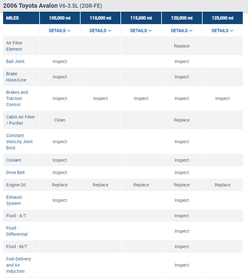

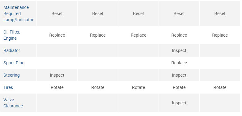

At typically what mileage these components related to suspension are required to change. My car is at 106,671 miles currently and what issues transmission face on this car and is there any way to preempt the issues? Is there a manual available online in which I can read regular maintenance items for every 5,000 miles driven?
Jun 20, 2022 at 8:18 AM
SQM
  • 6,383 POSTS
It is recommended to inspect those components for ware and tare. As depending on driving habits, road condition, weather etc. the actual time for a worn-out component will vary quite a bit.
See attached for the maintenance guide/schedule.
Jun 20, 2022 at 9:58 AM
