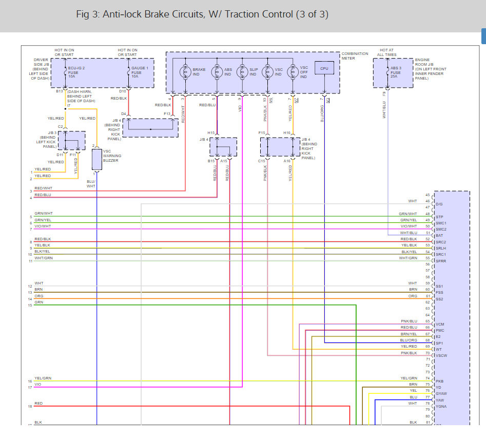

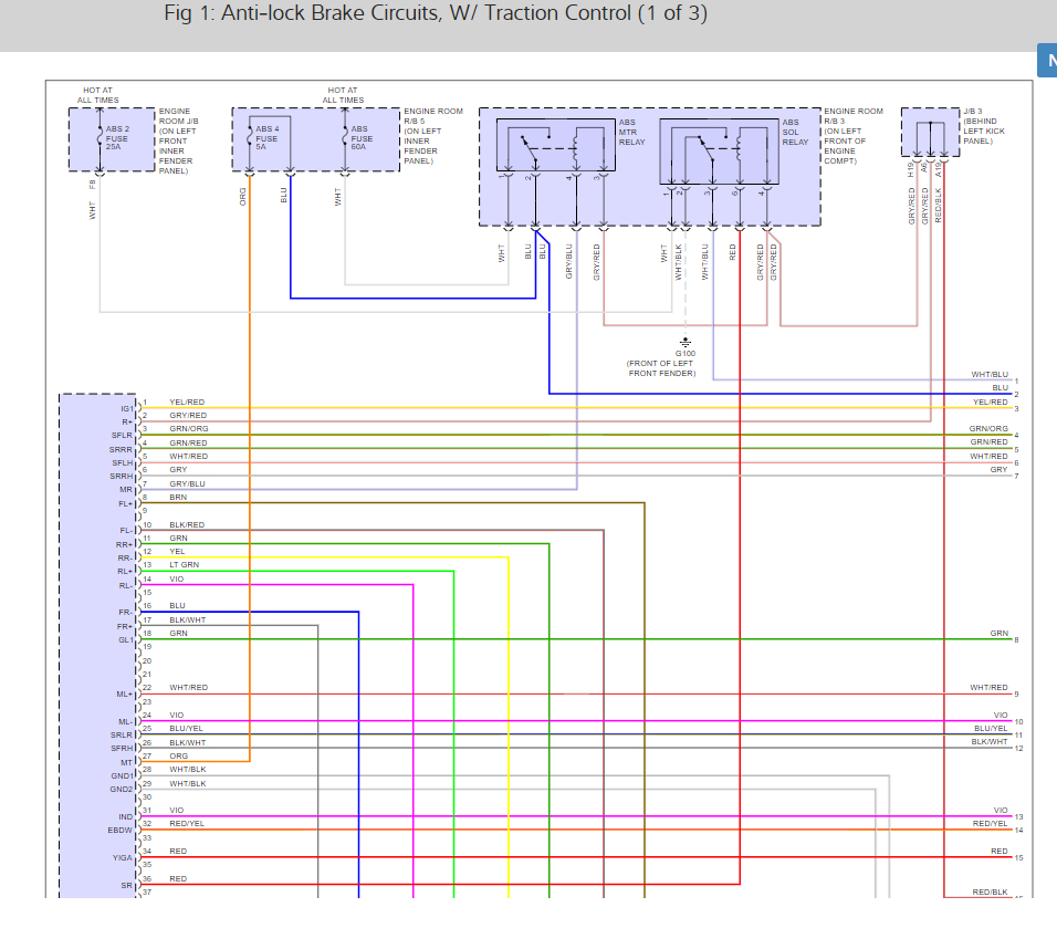

Both ON and OFF VSC lights stay on all the time. Took it to a dealer, he found error code C0208, cleared the codes, lights came back after 2 weeks. Another Toyota dealer found error code C1208/54 cause RM746U1 (steering sensor malfunction), 'calibrated steering customer to monitor', but the light came back shortly. Any idea how to resolve the issue ? Thanks !
Jan 25, 2008 at 1:42 PM
  • 54,840 POSTS

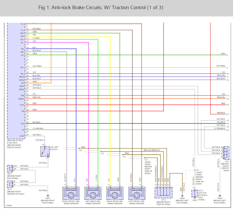

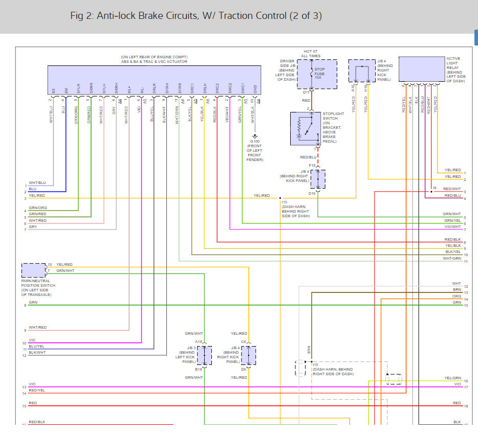

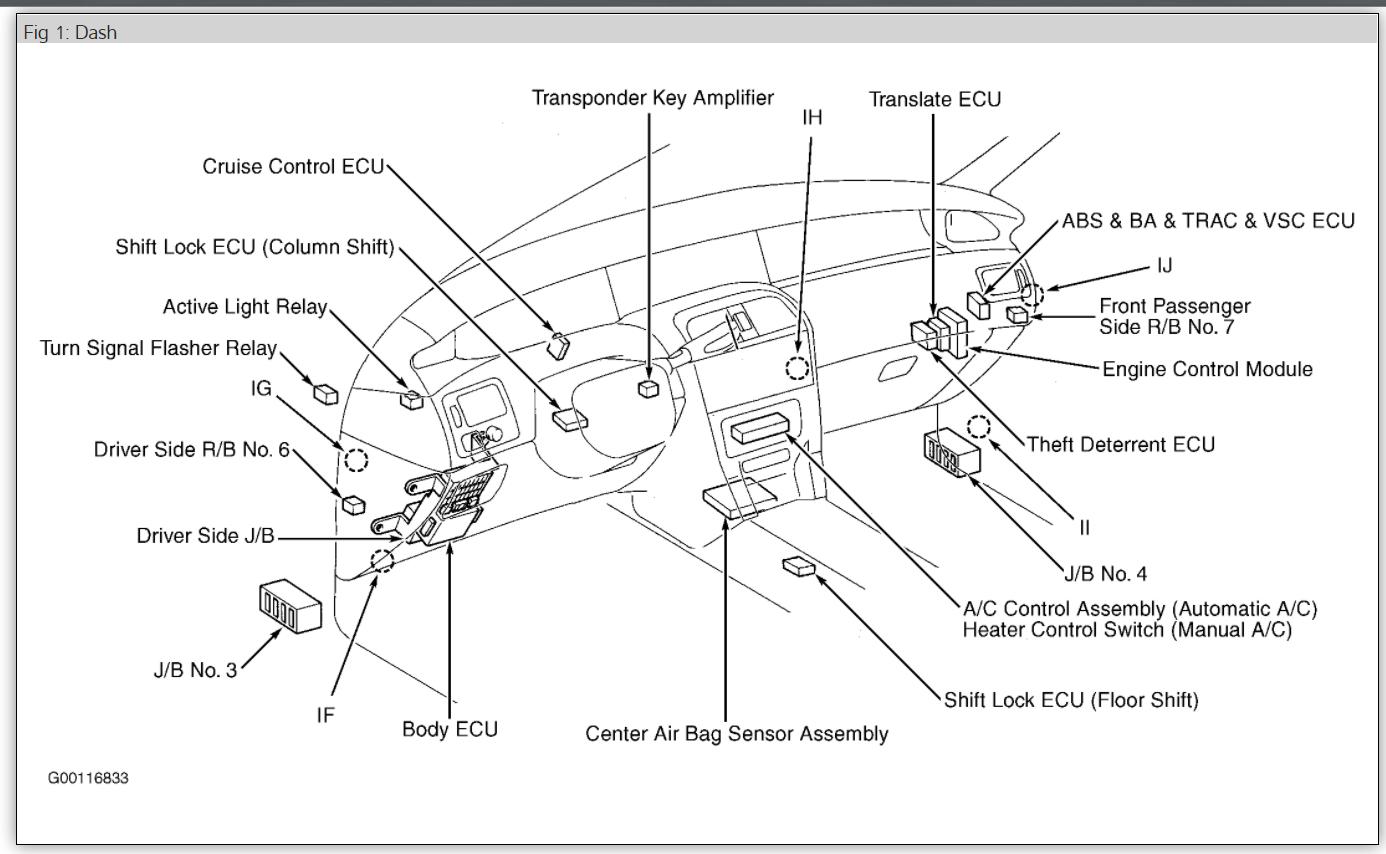

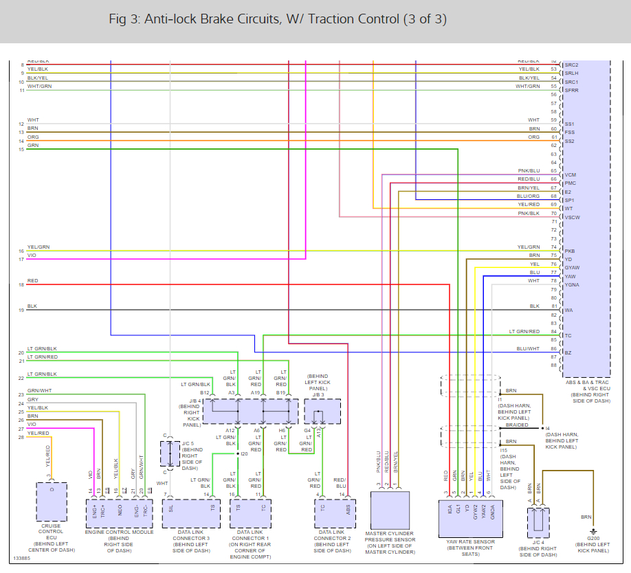

The clue is the C0208 which is telling us the ABS - VSC module is going out they cleared it to get rid of you for a while and hope everything will be okay. Here is a the ABS and VSC wiring diagrams so we can see how the system works and the location of the module that needs to be replaced which is on the passengers side under the dash.
Please check the wiring to confirm the issue.
Jan 28, 2008 at 8:42 PM
A K
yep you hit it on the money the ABS controller was bad I had to have it programmed in to work it cost me $450.00 to get it fixed but at least my car is working again. Thanks for your help this site is great.
