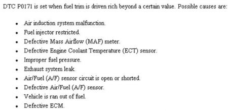

Alas...the CEL did come back again but with a different code this time ...the code which I am getting now is P0171 - Fuel system bank one too lean instead of the P0420 which I had got earlier. This code has come about 3 to 4 times now after i drive every 250 odd miles , however, last nite it came on barely after I had driven 37 miles after resetting it. I already had the MAF cleaned using CRC cleaner. My mechanic is also thoroughly confused since he also doesn't seem to have a clue. The scanner returns 2 codes but displays just P0171. Could it be the O2 sensor or something else? Please help me. There is no change in the performance or fuel efficiency of the car.

The testing procedure for the MAF is not accurate from the manuals, I would replace it if you can not find any vacuum leaks.

Are you so certain that it is the MAF which is the culprit here and not anything else ? I have allready filled up a fuel injector cleaner about 2 months ago. Do you think I should check the O2 sensor voltage to find out if annything is wrong there ?

I'm working off probablility. But these are other possible causes to go through:

not sure if this got resolved but just wanted to add that when a toyota v6 starts setting a p0171 99.9% the maf needs replaced. cleaning is typically a waste of time.

I concur!

That's a bull's eye....I have already replaced my MAF ( $ 160) and the CEL has gone...have driven almost 500 miles after replacing it and there is no sign of the light coming back....thanks to all of you for your time and expert advise.
