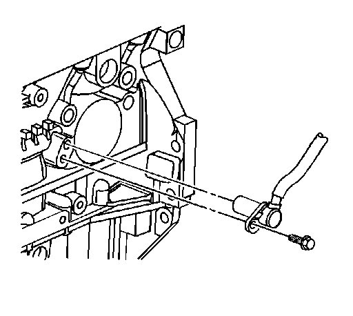

Check engine light is on but It doesn't throw any codes. When it shuts off the information panel says reduced power. Now for the mind boggler, after it shuts off, I can take the key out, walk back to the truck and get back in, and it starts fine. Replaced, throttle body, APP, fuel pump, and fuel filter. Any help would be greatly appreciated! Thanks in advance!

Honestly, if it stalls and there are no codes, my first suspect is the crankshaft position sensor. If it is failing, it can do so and not set a code.
Take a look through this link:
Now, if this is the problem, you will lose spark when it fails. So, you can check for that or using a live data scanner, see if you lose the RPM signal.
If you determine it is bad, here is a link showing in general how one is replaced:
Here are the directions specific directions for you vehicle. The attached pictures correlate with these directions.
CRANKSHAFT POSITION (CKP) SENSOR REPLACEMENT
REMOVAL PROCEDURE
1. Remove the starter.
Picture 1
2. Disconnect the Crankshaft Position (CKP) sensor electrical connector.
3. Remove the CKP sensor bolt.
4. Remove the CKP sensor.
INSTALLATION PROCEDURE
1. Inspect the CKP sensor O-ring and lubricate with a mineral based grease.
Picture 1
2. Gently insert the CKP sensor into the block.
3. Install the CKP sensor bolt.
NOTE: Refer to Fastener Notice in Service Precautions.
Tighten the CKP sensor bolt to 8 N.m (71 lb in).
4. Reconnect the CKP sensor electrical connector.
5. Install the starter.
6. Perform the CKP system Variation Learn Procedure. Refer to CKP System Variation Learn Procedure.
