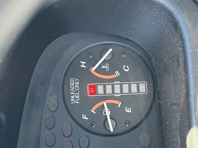

The picture is perfect. No problem whatsoever.
Is that the highest it gets before the fan turns on? If it is, no worries. That is where I would expect approximately 220F to be. As long as once the fan turns on and the temperature comes back down, it is fine.

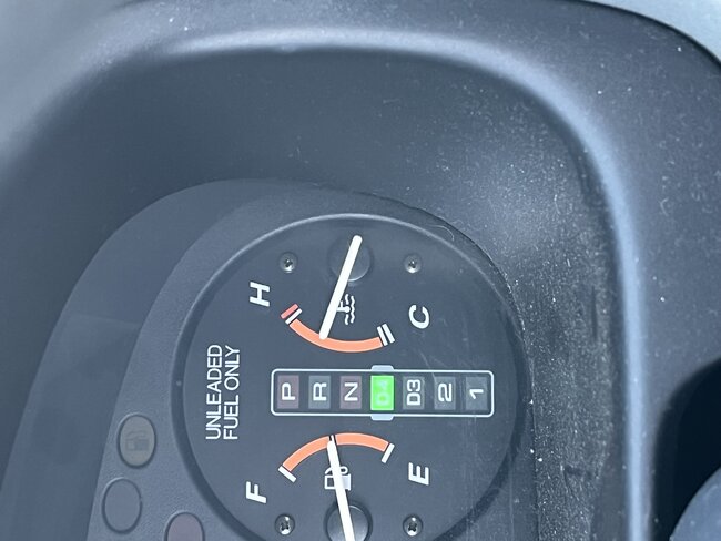

Well, I took the car to a shop that someone recommended, and they said the car doesn’t overheat. The report says that the fans turn on. While driving back the car, the gauge went up and it came down like 3 seconds later. They tested the car with the A/C on/off. I’m happy with the results but boy, the report included a lot maintenance the car needs to replace dirty =engine oil, brake and steering fluids, replace broken engine mounts and need, at some point, a new timing belt. The below picture is from yesterday, driving the car back home.

That is good news. Also, if the timing belt is original, yes, consider replacing it. As far as the brake fluid and the PS fluid are concerned, that's a judgment call. I have never changed either in my own vehicle and have never had an issue. On the other hand, the engine oil should be changed on a regular basis.

Thank you for your help. I still don’t understand why the gauge goes up and then down. It didn’t do that before, and I have had that car for 10 years. It doesn’t overheat, great! But the up and then down thing drives me nuts! Especially when my dad tells me that’s “normal” and I tell him, that I never saw that before.

You are very welcome. I totally understand your concern, but at this point, you should be fine. However, if anything changes, let me know and I'll help the best I can from here.

No dude. The car is much worse. The gauge goes up to the white line now and I hear metal sounds like something is bouncing around the motor. The last mechanic I talked to said to take to the dealer or find a Honda specialist because things are not getting better. Even the tricky part of having the AC on is not helping. I am not sure what to do.

That is a lot higher than I want to see. I went back through our conversations. The cooling fan with the AC on was helping before but not now. Have you replaced the thermostat or tried flushing the radiator and engine block?
