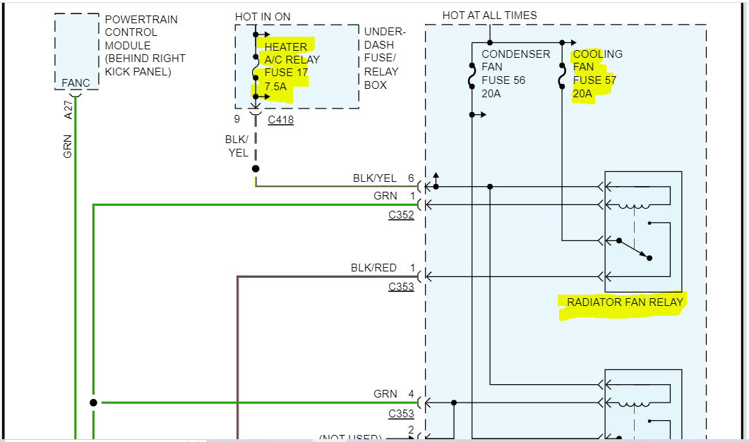

It sounds like only the condenser (AC)fan is running or the fans only run when the A/C is switched on.
Suggest checking cooling fan fuse 57(20A) in under hood fuse block first.
Also check that you have 12V supply to the radiator fan when the AC is switched on.
See good video link below:
https://youtu.be/95CwOqLvuD8
12V should be present at the black/red wire at the 2-pin radiator fan connector.
Also check that you have a good ground connection at the black wire.
This can easily be checked while checking 12V at black/red wire.
First use battery negative to prove that 12V is present, next use the black wire, you should get the same reading on the voltmeter.
See image 1 below.

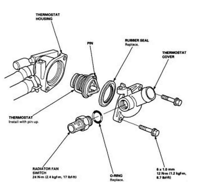

The other problem might be the radiator fan switch, located at the thermostat housing, lower right rear of engine. See image 2 below.
To test if this circuit is at fault simply disconnect the connector at the fan switch and insert a bridge wire from pin to pin. See if cooling fans run.

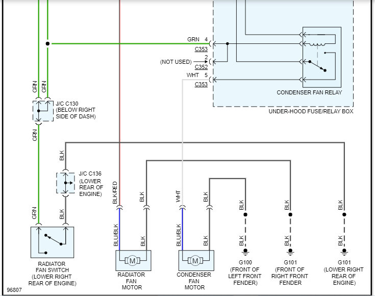

I attached the wiring schematic for the radiator cooling fans. Let me know if you have already checked the fuses and relay, I highlighted. Note: When checking the fuses, confirm there is power to them.
Also, let me know how the relay was tested.

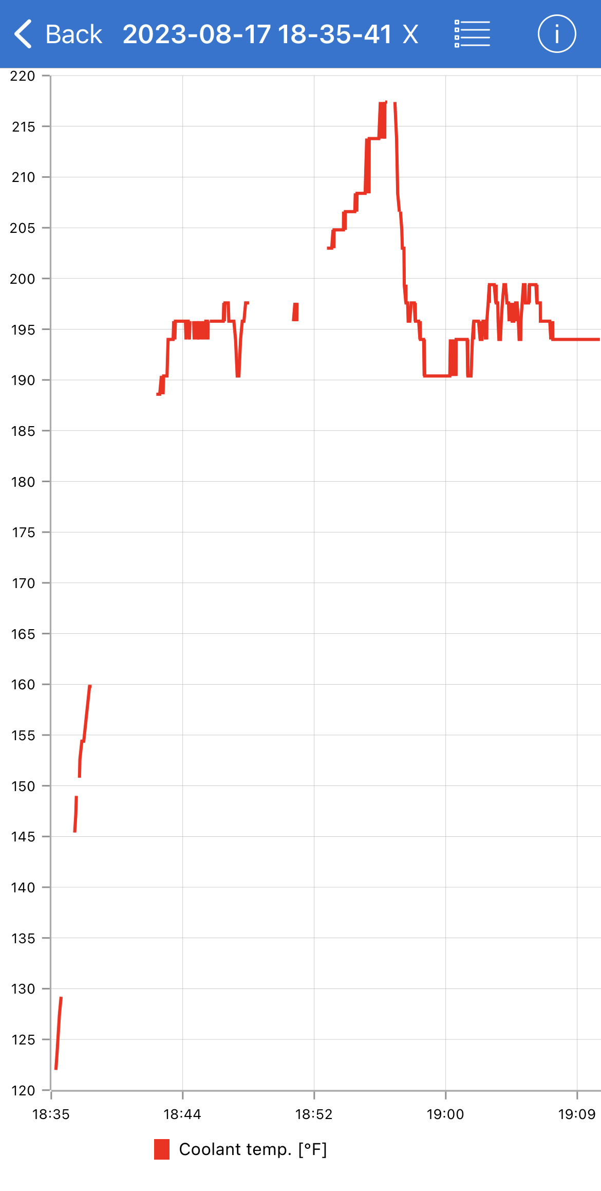

Thank you for your reply. I checked the fuses and relay, and everything worked. Today, I had the car parked and started it after I installed an OBD with Bluetooth. I saw the engine coolant reach 217* degrees and I could see the idle go up but then I heard something in the car, like something started, (not sure how to describe or explain) but dad said it was the fans starting. I noticed the temperature went down. From 217* to 197* to 194*. I decided to drive the car for maybe 5-7 minutes, I still don’t trust it and the temperature did not increase.
I am not sure if the problem is fixed. It went up then down. All of this, including the driving with the A/C off.
See attached image of car temperature.
Aug 17, 2023 at 2:23 PM
  • 110,248 POSTS
That sounds like it did exactly what it is designed to do. Drive it and don't be afraid; be aware. Keep an eye on the temperature. If you notice it getting too high, find a safe place to park and allow it to cool. Hopefully, it won't.

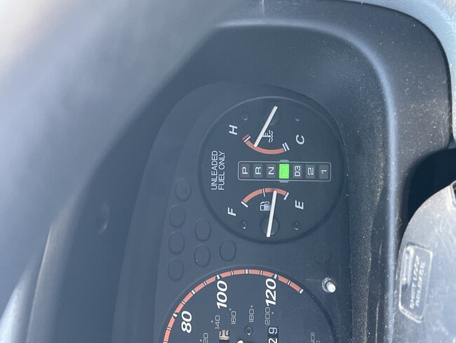

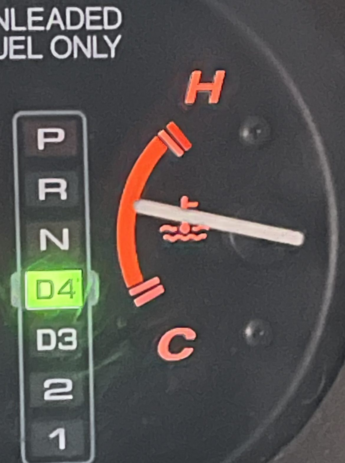

Thank you. I have had that car for 10 years now and I have never seen the idle (temperature) go up, the fans start and then go down. That part doesn’t make sense to me. My dad’s car doesn’t do that and that’s the reason I don’t trust it. Or
Maybe I need to drive it more.

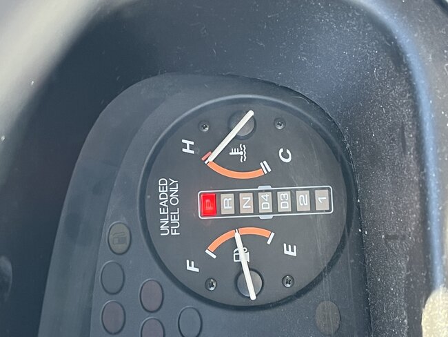

Attached is an image from last month. The car “needle” got that high and on Wednesday kind of looked like that and then the fans started. I have never seen my car idle do that and start the fans.

I guess my point was, why the delay? Why does the temperature idle go all the way up and then the fans start? That delay is driving me crazy.
Aug 19, 2023 at 9:01 AM
  • 110,248 POSTS
I understand. That is higher on the gauge than I would expect before the fans turn on, but the temp you mentioned (217F) sounds normal. Also, the increase in idle speed is by design. It does that to compensate for the added load when the fans turn on.

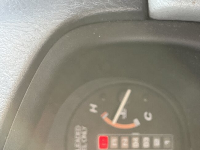

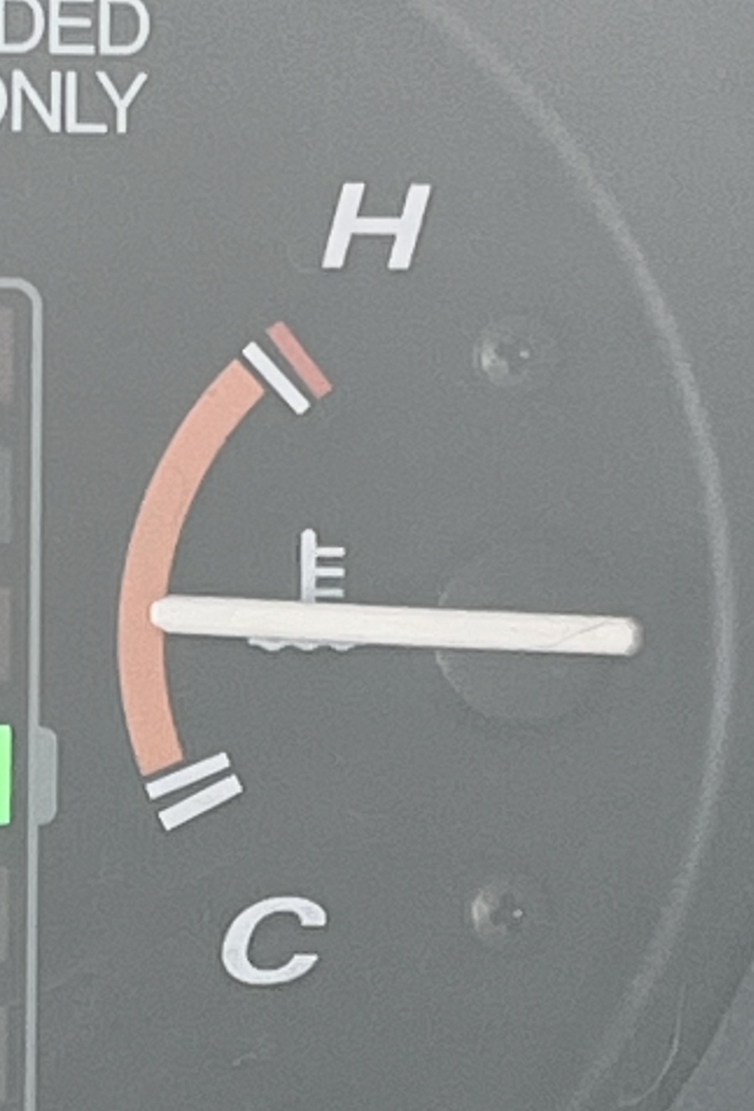

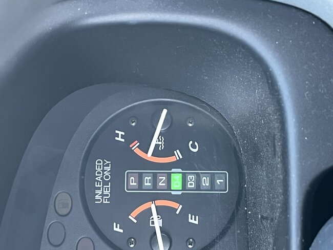

Hello. I drove the car twice today. I am honestly not sure to say that the car is fixed. The first time, the temperature went up somewhat high, and came down as soon it went up. The second time, it went a little up and it took its time to come down.
When can I say that the car is fixed? Do I need to check something else?
Drive it more?
See attached pictures.

If that is where the temperature gauges are staying, it should be fine. I'm not sure where you are located, but if the temperatures are extremely high, the engine will likely run a little hotter.
The best thing to do is drive it and simply keep an eye on the gauge.

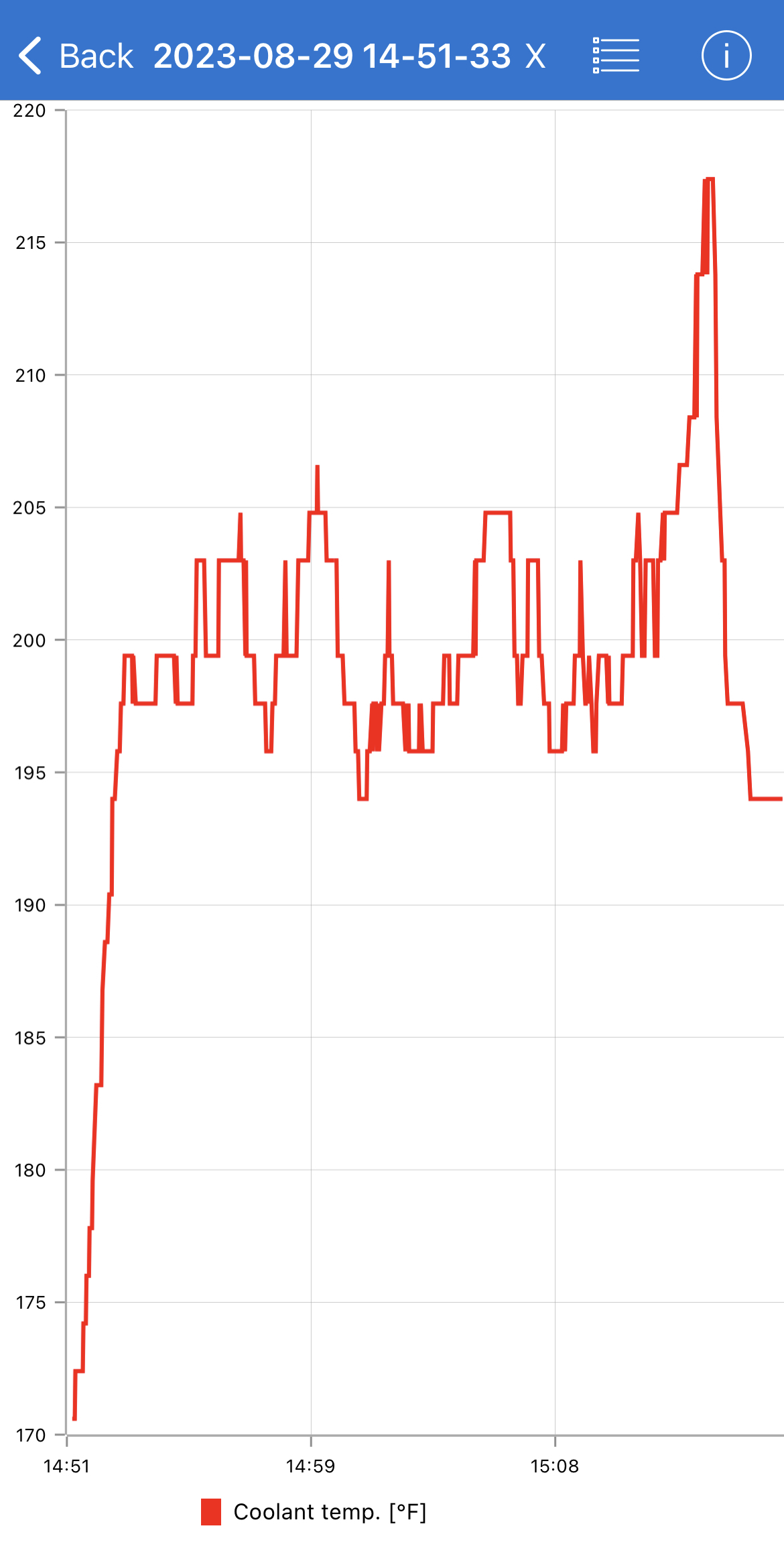

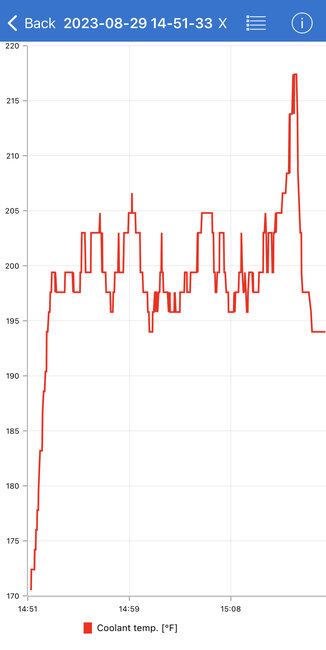

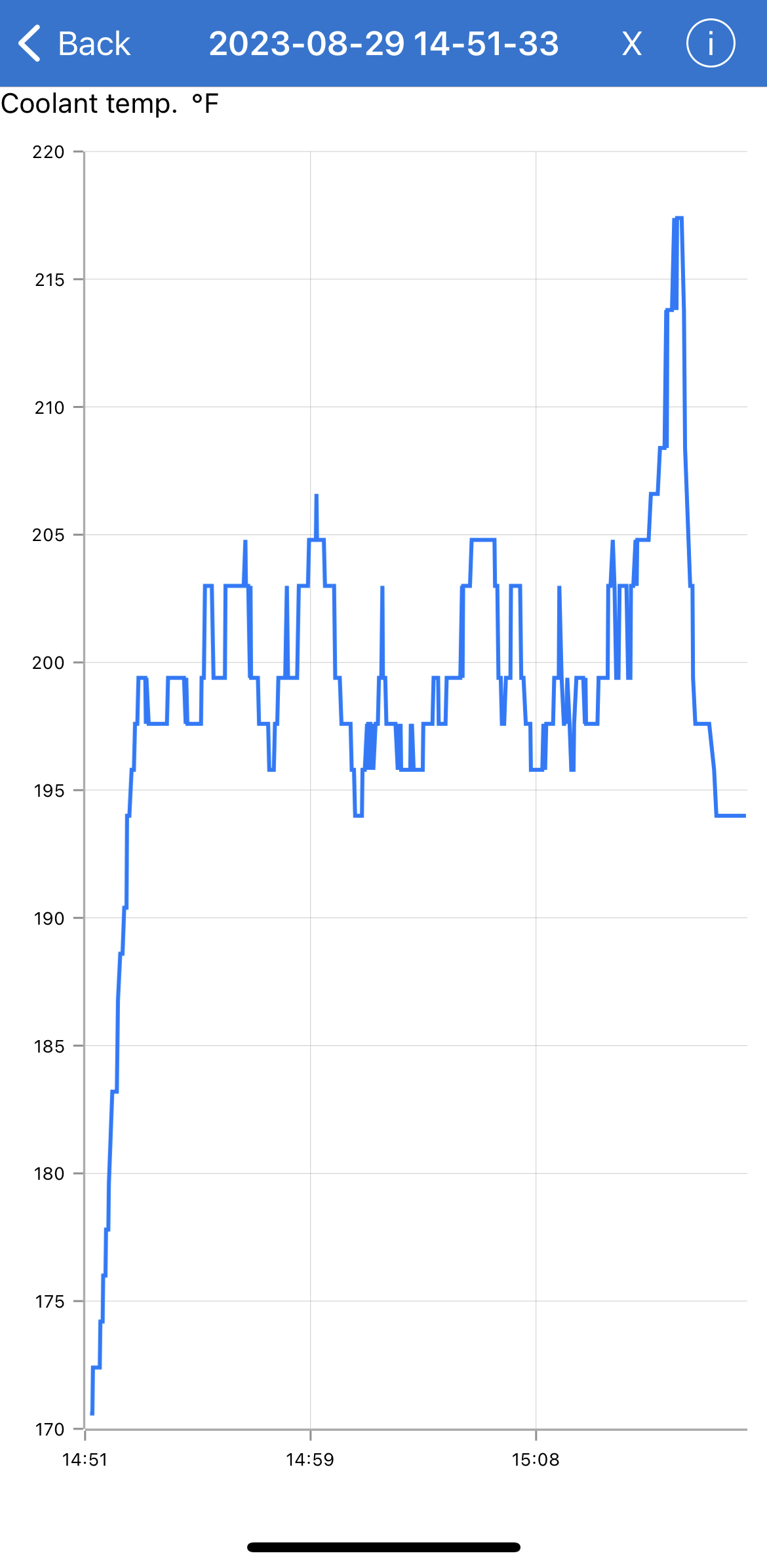

See attached.
Aug 29, 2023 at 7:07 AM
  • 110,248 POSTS
Since it doesn't overheat with the A/C on, the condenser fan is working. I looked at the temperatures you attached above. In all actuality, they are not out of the norm. The fan may start operating when the engine coolant temperature reaches around 210 to 220 degrees Fahrenheit. You are within that range.
I just don't want to see you spend money and nothing change. Remember, when the A/C is on, the condenser fan runs at all times. With it off, the temp has to increase until the radiator fan turns on. If you are in the range I mentioned, I feel you are okay. Also, since you were at idle in a drive through, the under-hood temperature will increase.
Let me know if you have questions.
Aug 29, 2023 at 11:49 AM
ROCKA
  • 22 POSTS
I actually bought the condenser fan because it is cracking. My dad and I checked it, and we could see some lines in the around the fan and somewhat loose too. It bothers me that mechanic only recommended to buy one fan instead of the two.
Yes, when the temperature reaches 217* the fans start working. I just don’t understand and still freaks me out when I see the gauge go up.

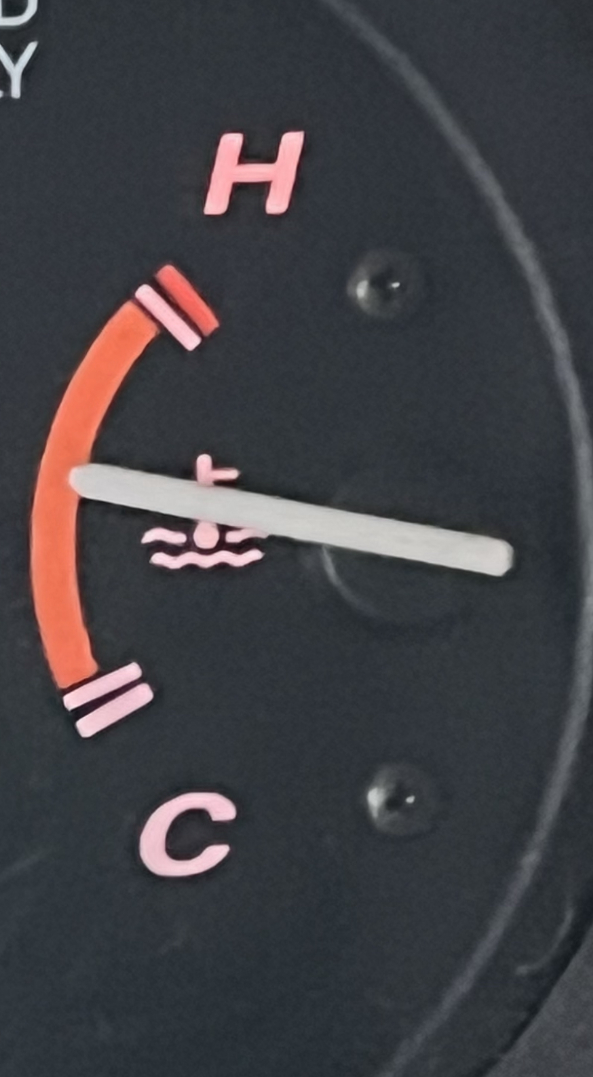

Hello. I couldn’t upload the picture properly but that is what it looks like.
Sep 3, 2023 at 8:57 AM
  • 110,248 POSTS
The picture is perfect. No problem whatsoever.
Is that the highest it gets before the fan turns on? If it is, no worries. That is where I would expect approximately 220F to be. As long as once the fan turns on and the temperature comes back down, it is fine.
