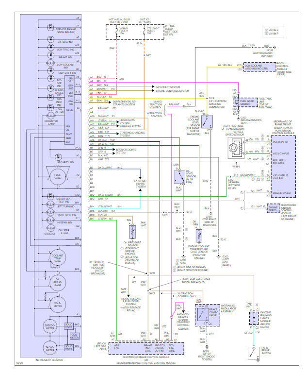

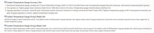

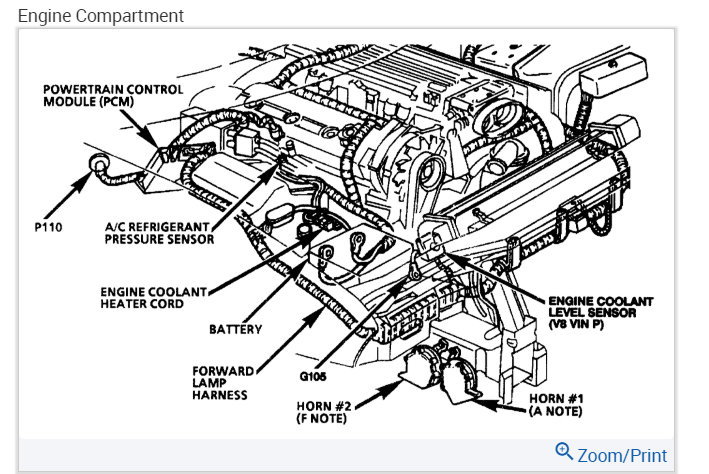

Good call on the sensor, I would get AC Delco. Next the fact the fan did not come on when you disconnect the sensor tells me there might be problem with the PCM fan signal driver.
Try the sensor first then replace the PCM with a used one, its plug and play. Here is the location.
Check out the diagrams (below). Please run some tests and get back to us.

Using a toggle switch to do that will set codes in the system and turn on the CEL. If all of the external parts are working then the PCM is not turning the fans on.
Did you test using the jumper wires as I put in the earlier posts? Did they turn on/off with the jumper wires? If not then you still have a problem in the wiring or a bad relay. Just because they click does not mean they work.

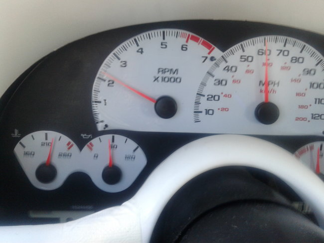

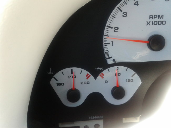

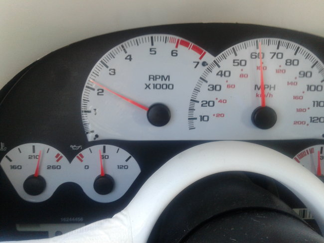

If there is one problem it is another with this car, so I will start from the beginning. I replaced the bulbs in my cluster with LED's and added a back face panel to go over the gauges. I had to take the needles off to do so. I placed the needles back on to what seemed cores took some adjusting because I forgot to mark them before I removed them and my gas gauge does not move anymore. Could be a ground issue or the gauge itself? Some said because seems my float is working (I sent a video texting it with a multi meter), so instead I bought a aftermarket gas gauge hooked it up to the wires connected to the original wired to the fuel pump and float, purple for the sender wire, black for the ground and grey for the power 12 volts seems to work okay. I guess now the temperature gauge seems to be showing the car is overheating while driving I noticed the temperature needle moving into the middle line of the gauge. Usually it never even reaches that far. Then I noticed it went passed the half way mark as if it was overheating. My gas gauge seems to have dropped also because I have not driven that far. Is it a thermostat issue? Or what? Can anyone help please?
I am sending some pictures of how the gauge looks while I was driving for over thirty minutes.

Hi Genius, that is a bit on the hot side is it not. Have you seen what the temperature gauge displays when the radiator fan turns on? Or what the temperature gauge displays when the A/C is turned on? Not having a radiator fan work proper would make it run pretty hot. Did you notice if the fan was on when the temperature gauge displayed that hot? You have an ohmmeter? Need a measurement at the coolant sensor. It needs about 1400ohms for the temperature gauge to read cold. And then when its warmed up, the coolant sensors reads about 700ohms but if the temperature gauge displays hot temperature, then there is the problem. You could check that right away but radiator fan operation and real engine temperature is more important than what the temperature gauge displays. Let me know how it goes.

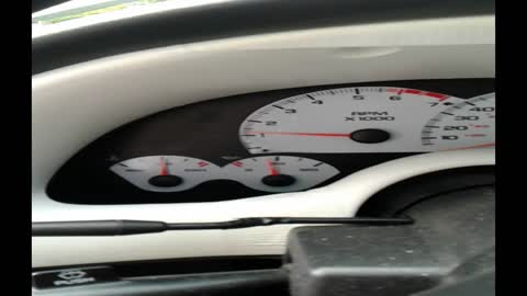

Well I replaced the thermostat does not seem like it helped at all. Coolant seems to be topped off good. Could use maybe a half a quart of oil. Here is a short video on what it is doing.

No video.
Have you seen the radiator fan do its job? If not, turn on A/C open the hood and take a look to see if radiator fan is running. If it is, turn off A/C, fan should stop. If it stays running, restart engine. Fan should not be running, let engine run until the fan turns on. Then take a look at temperature gauge, see where the needle is pointing. Usually it is about a bit over middle temperature. Then when the fan reduces temperature and turns off, take another look at temperature gauge. It is usually a bit under middle temperature. Now if the fan does not turn on with the A/C, that is probably the problem.

Sorry, I tried up loading the video. The fan cuts on when I turn the AC on but it did not seem to kick in when the car is just running and the temperature sensor seems to read hot.

I saw that video and the way that needle jumps up makes me think it is not running hot. It is an electrical problem. A bad temperature gauge or sensor. Does it have a check engine light that is stuck on too? If so, you should definitely have it scanned for code numbers. Even if the check engine light is not on, that coolant sensor should be checked with a scanner or an ohmmeter. It is probably a bad sensor, but I could not recommend replacing it without scanning or measuring it with an ohmmeter first. https://www.2carpros.com/articles/checking-a-service-engine-soon-or-check-engine-light-on-or-flashing

You say you removed the needles and added an overlay to the dash and after that this started correct? I would say the issue is the stepper motors are failing and the cluster needs to be repaired. Very common in that vintage to have the stepper motors fail, especially if they were touched at all. There are kit's and places you can send the cluster to for repairs. I do not recommend DIY unless you are very skilled at circuit board repair as the boards are not very rugged and unless you are extremely careful you can damage the board itself.

That is the issue, if the stepper is failing it could read wrong. With the fuel stepper being bad it is a real possibility. When you shut the car off and then turn the key on, where does the needle set? Does your scan tool read live data? If so compare it to the gauge.

The temperature gauge starts off in the cold mark until about five or six blocks of driving the car. The temperature gauge needle jumps up to the halfway mark indicating it is beginning to overheat. The fans does not kick on even reaching 260 degree mark but I wired the fans to the battery and they immediately came on so they do work.
so far I have replaced the thermostat, and replaced the coolant temperature sensor, but it is not the ACdelco OEM. Would that make a big difference?
Jul 22, 2018 at 4:54 AM (Merged)
STEVE W.
  • 15,420 POSTS
If it is not smoothly rising from the low mark as it warms up you have a bad stepper motor or a bad head gasket. The coolant is not going to suddenly heat up and cause the gauge to jump. A bad thermostat would cause it to simply either heat up rapidly until it boils over or if it fails open it will slowly heat up and probably set a code because it does not reach the control temperature in a short time.
