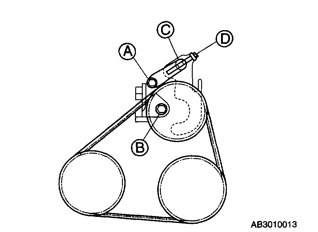

2. Loosen power steering lock bolts and nuts accordingly and remove tension from power steering (P/S) and/or air conditioning (A/C) compressor drive belt.
3. Remove P/S and/or A/C drive belt.
4. Loosen generator mounting bolts and adjusting bolt.

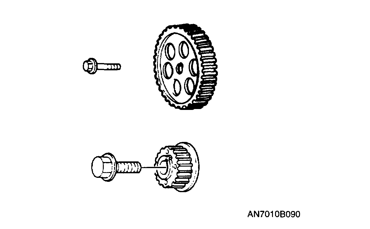

7. Remove crankshaft pulley and timing belt guide plate.

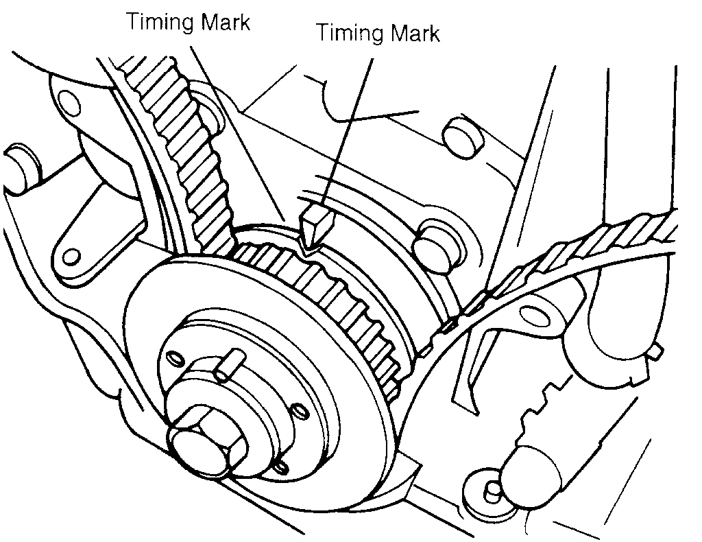

9. Turn crankshaft so that timing mark on timing belt pulley is aligned with timing mark on engine.

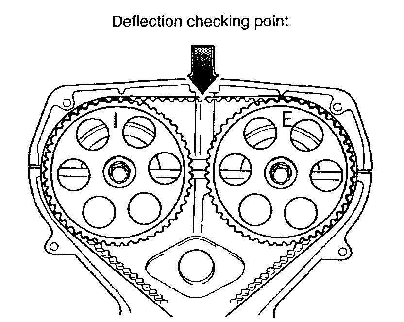

10. Check that "I" mark on intake camshaft pulley is aligned with mark on cylinder head cover and "E" mark on exhaust camshaft pulley is aligned with mark on cylinder head cover.

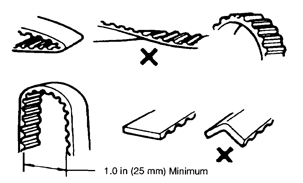

Notice Never forcefully twist, turn inside out or bend timing belt. Do not allow oil or grease to come in contact with timing belt.
1. Replace timing belt if it is contaminated with oil or grease.

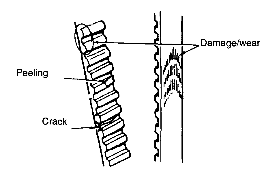

2. Check timing belt for uneven wear, fraying, peeling, cracking and hardening. Replace timing belt as necessary.
3. Bend timing belt into a "U" shape as shown in figure. Distance "A" must be at least 1.0 inch (25 mm).

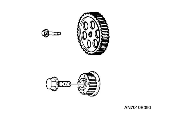

5. Inspect camshaft pulleys and timing belt pulley for broken teeth or damage.

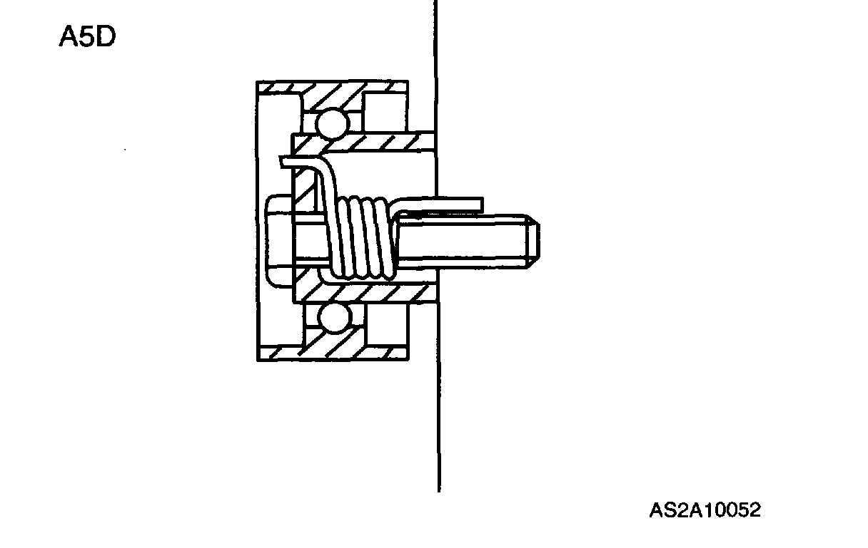

Installation
1. Install tensioner pulley.
Notice Replace tensioner spring whenever timing belt is replaced.
2. Pull tensioner pulley to its furthest point and tighten lock bolt.
3. Check that timing mark on timing belt pulley is aligned with timing mark on engine.
4. Check that "I" mark on intake camshaft pulley is aligned with mark on cylinder head cover and "E" mark on exhaust camshaft pulley is aligned with mark on cylinder head cover.

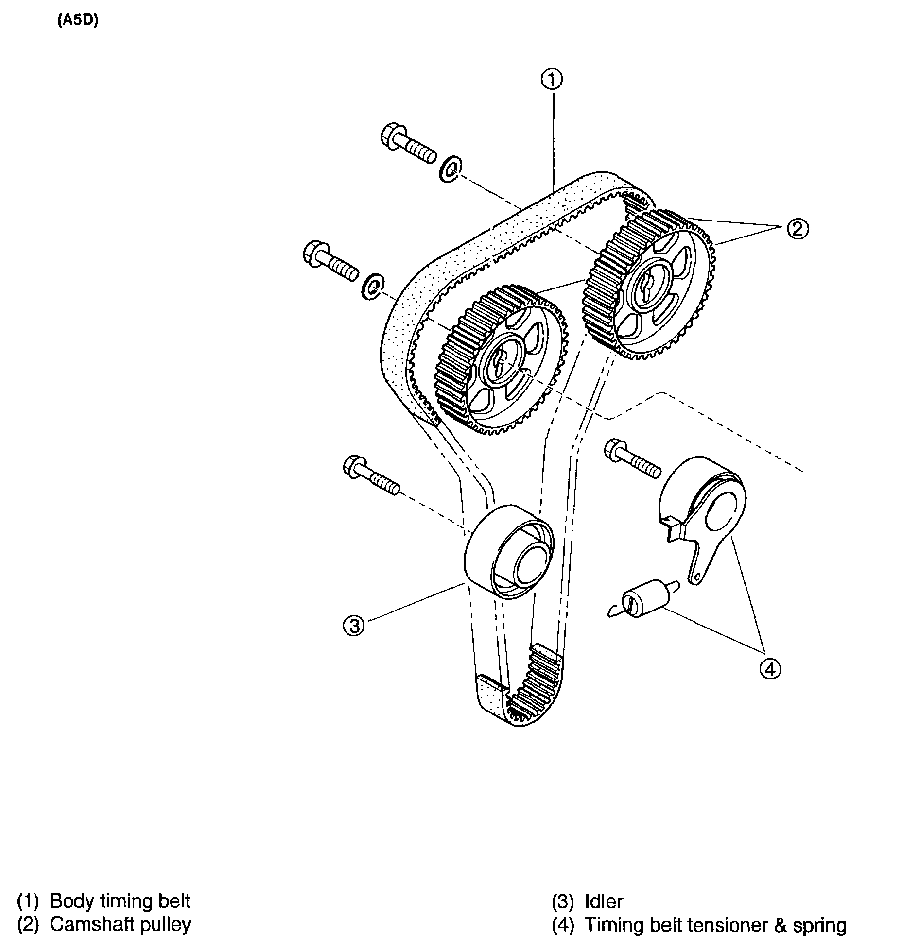

5. Install timing belt onto timing belt pulley first, then idler pulley, exhaust camshaft pulley, intake camshaft pulley, and tensioner pulley in that order.

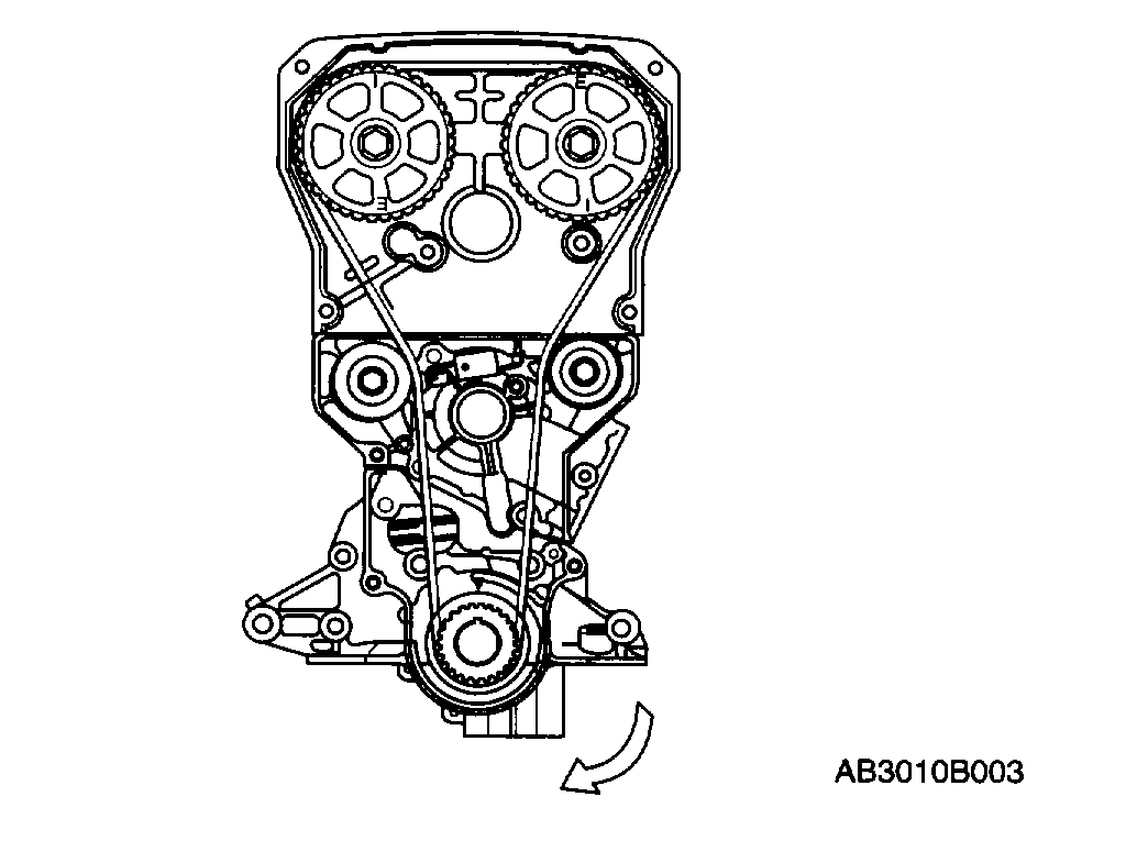

9. Rotate crankshaft two full revolutions (clockwise only) and align timing mark on timing belt pulley with timing mark on engine block.

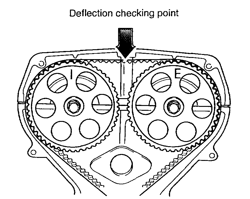

10. Check that "I" mark on intake camshaft pulley "E" mark on exhaust camshaft pulley are aligned with marks on cylinder head cover.
11. If they are not aligned, remove timing belt and start process from tensioner installation.
12. Measure timing belt deflection by applying moderate pressure midway between camshaft pulleys. If deflection is not correct, repeat from tensioner installation.
Deflection pressure: 22 lbs. (98 N, 10 kg)
Deflection: 0.39 - 0.50 inch (11 - 13 mm)

I realize the directions are extensive, but I do not want to leave anything out. The following pictures all correlate with these directions.

Joe, one other question about this 2002 Kia Rio, can a one tooth off timing belt install cause the motor to run hot and boil coolant out of the white reservoir tank? And, make it seem like the motor is running retarded when gas is given.
Oct 15, 2018 at 12:18 AM
PANMIKE
  • 31 POSTS
Joe, look at this Kia Forum post. Eureka!! Found the problem with my 2002 Kia Sedona 3.5 , no power, idles great. no codes. (timing belt had jumped one tooth) caused this headache. Cams were still aligned but the crank was retarded one tooth. Not sure why the computer did not pick this up as Chrysler's do. All is well. any DIY'ers make sure you apply 50lbs torque to the timing belt before with your pulley, then you release the tension-er. Failure to do this will ruin your engine as the belt will fail and valves will impact on the pistons.
Oct 15, 2018 at 1:29 AM
  • 110,194 POSTS
Welcome back:
I had a feeling the timing was off. Regardless, I am glad to hear you got it back together and going.
Take care and let us know if you have questions in the future.
Oct 15, 2018 at 10:05 AM
PANMIKE
  • 31 POSTS
Joe, thank you very much for all your help and information. The car goes up a hill in my neighborhood with power now since those two mechanics came back and fixed the timing belt marks per your instructions. The timing was definitely retarded and now the car is running great. Thanks again. Mike in Panama
