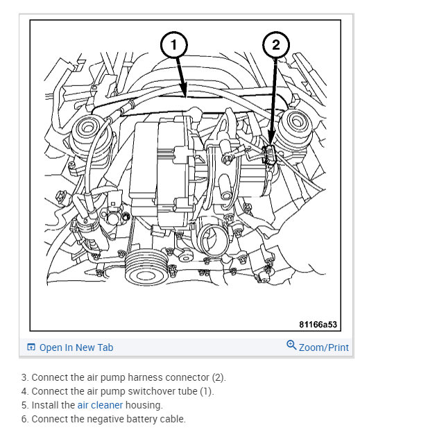

I pulled into the garage tonight and shut the car off as usual. Something is still making a winding noise that sounds like a hair dryer. Opening the hood revealed nothing moving/spinning (such as belts, cooling fan, etc.,) but the sound seems to be coming from the passenger side area of the engine. Had to remove a battery cable to get it to stop. Re-attached battery cable and the noise didn't restart but am wondering what could be going wrong?
Apr 18, 2022 at 7:27 PM
SQM
  • 6,383 POSTS

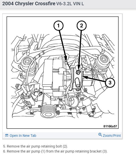

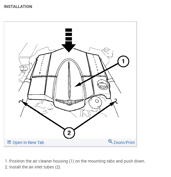

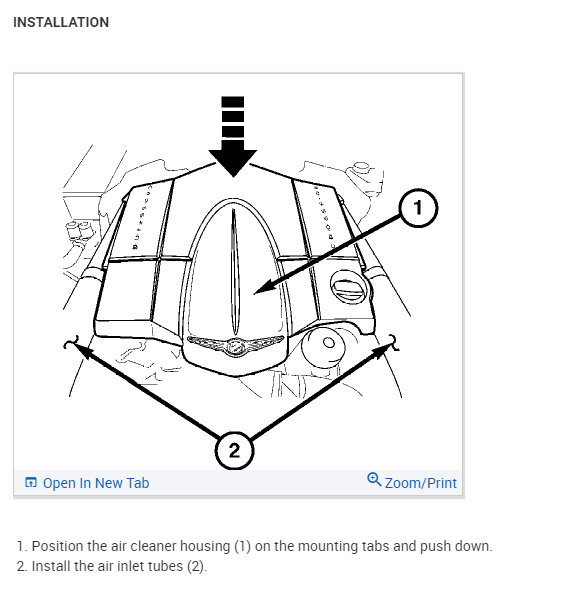

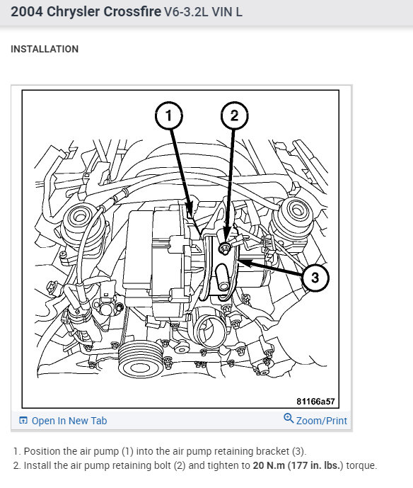

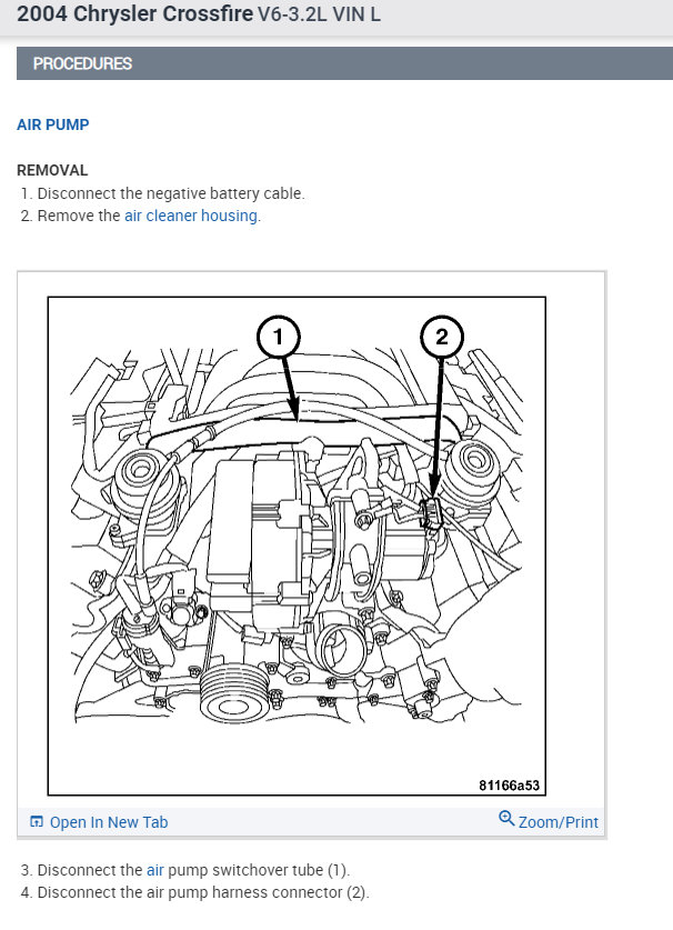

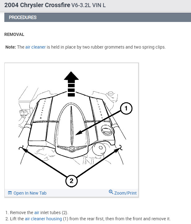

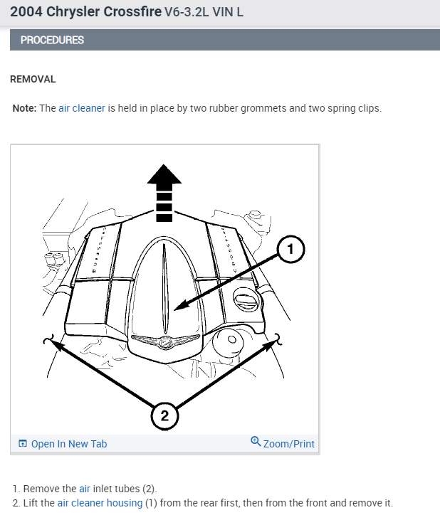

If the cooling fans are off but you are hearing the noise, it could be due to the secondary air injection pump staying on. You will have to remove the air cleaner housing in order to access the air pump.
I have attached diagrams below. Locate the part and see if that is what is making the noise.
Let me know of any questions.

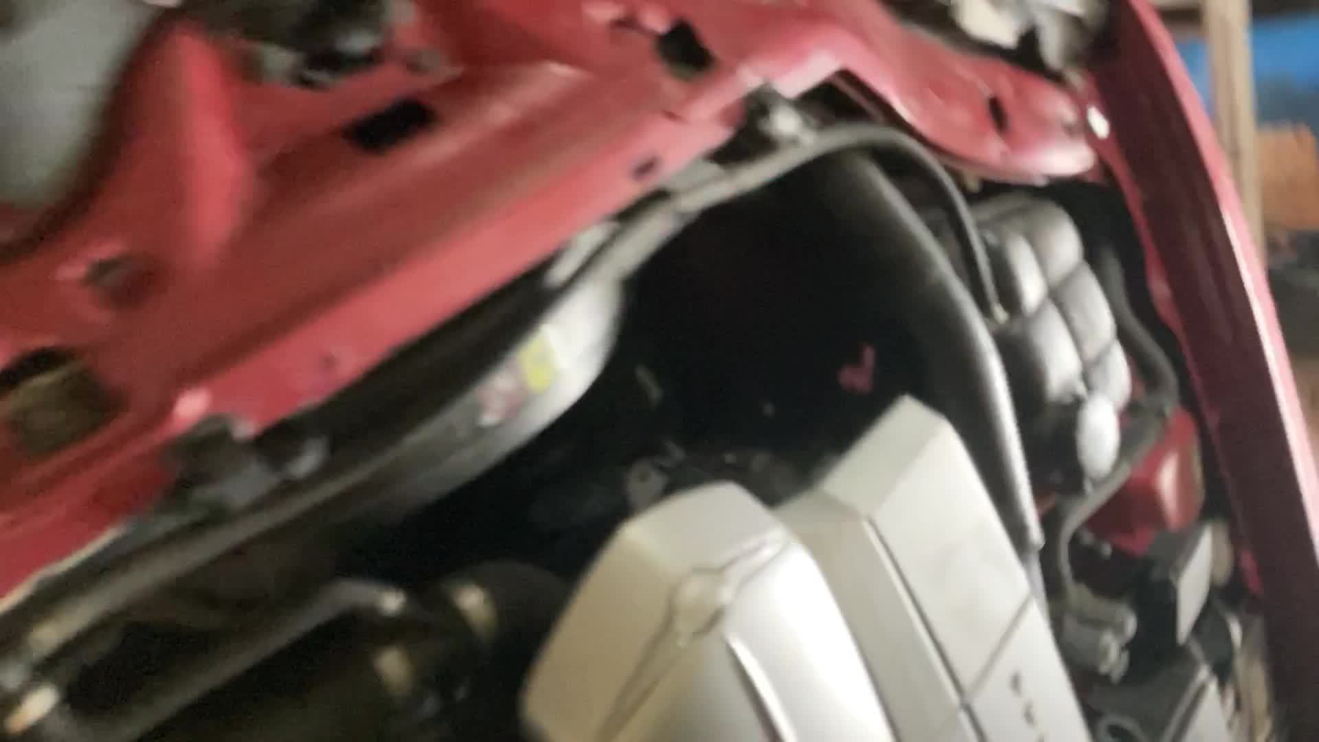

Here is the noise on video. I haven't had a chance to get the symptoms to repeat but will try again in the morning!

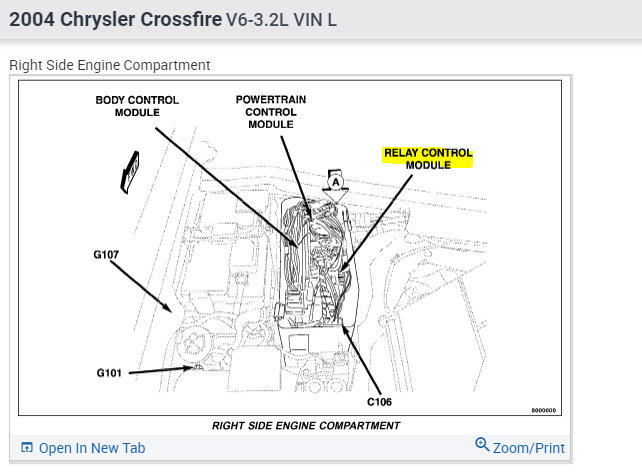

My thought was that it may be the relay for the secondary air injection pump may be stuck on.
Apr 18, 2022 at 9:45 PM
SQM
  • 6,383 POSTS
It is possible for this to stay on due to a faulty relay.
The air pump is controlled by a solid-state module that contains relays for the pump as well as horn, engine control relay and traction control relay.
See attached.

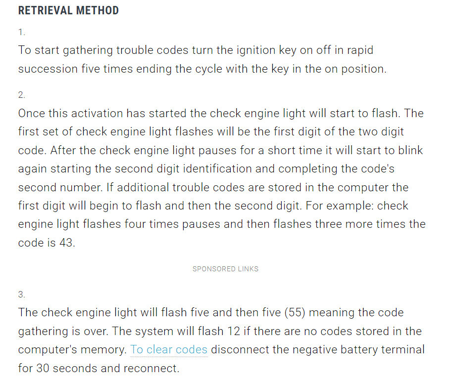

I now have a code set because the BAS/ESP light is on constantly now. My Actron code checker states "no codes" (for some reason) yet erasing the codes with the Actron seems to shut the light off, but only momentarily. I wonder if there is a built-in way to get the car to indicate the code to me without using the Actron. At this point, it may benefit me to simply remove the rcm and re-inspect that relay, if I can remember which one it was. Possibly I should replace the relay regardless? I think the pump itself is working, just not being controlled properly. Your opinion here is greatly appreciated!
Apr 19, 2022 at 11:31 AM
  • 110,194 POSTS
If you look below, there are directions for getting codes from the vehicle without a scanner, but normally it is for older vehicles. Try it. I've seen it work with newer models.
If that doesn't work, you really should consider scanning the can bus. CAN stands for controller area network. Many of the computers/modules are tied together via a few wires. This type of scan will retrieve codes regardless of the module storing them. It does require a scan tool that can read can-bus codes. Here is a link that explains how it's done:
