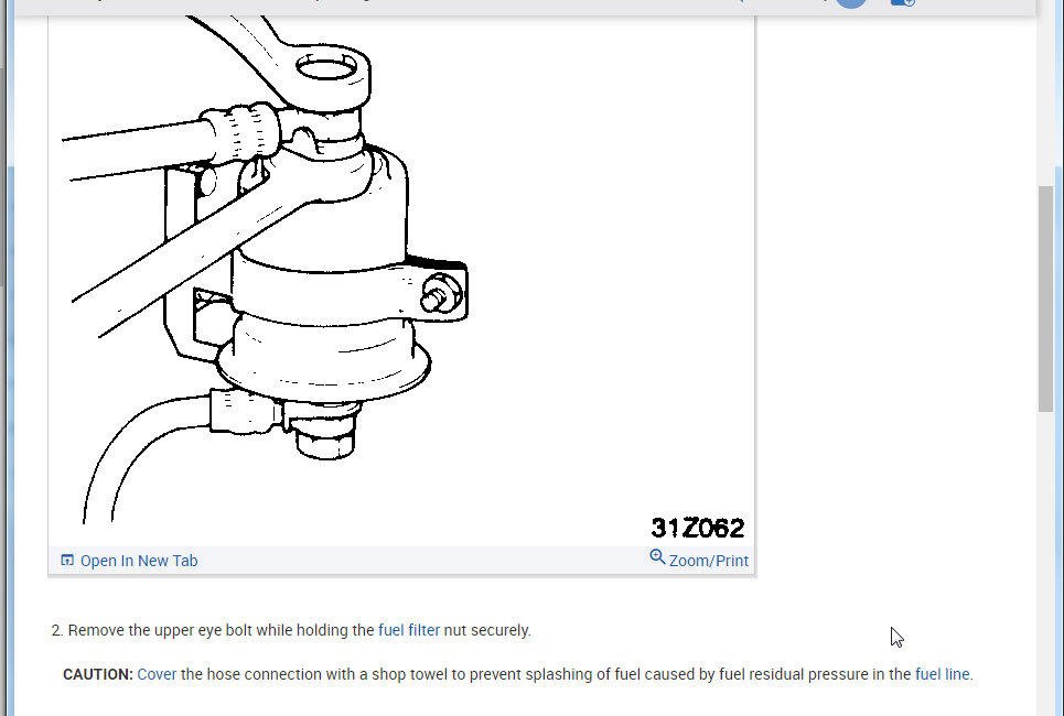

If you are not getting fuel then you either have a clog in the line or the lift pump cannot produce any pressure.
Here are some guides that will help with this:
https://youtu.be/dCjmRL3p4Cs

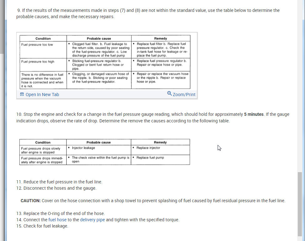

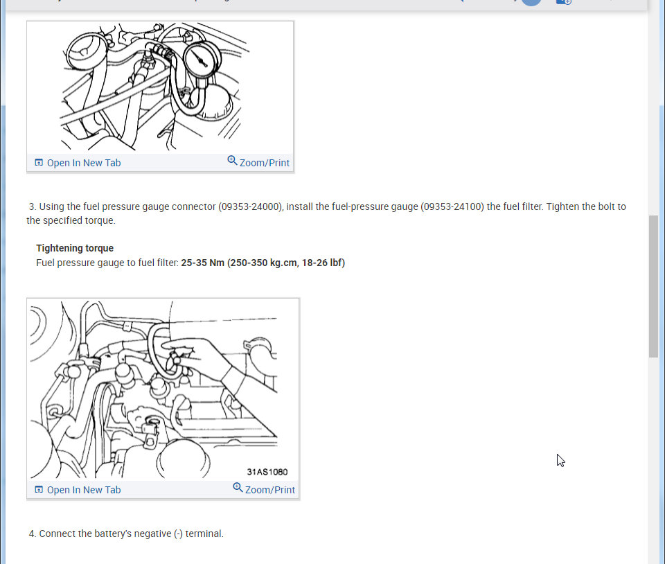

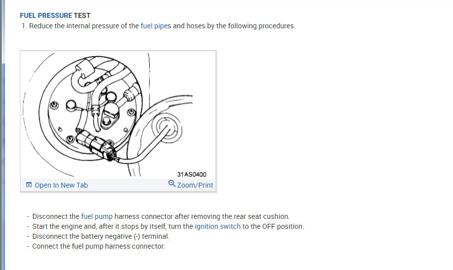

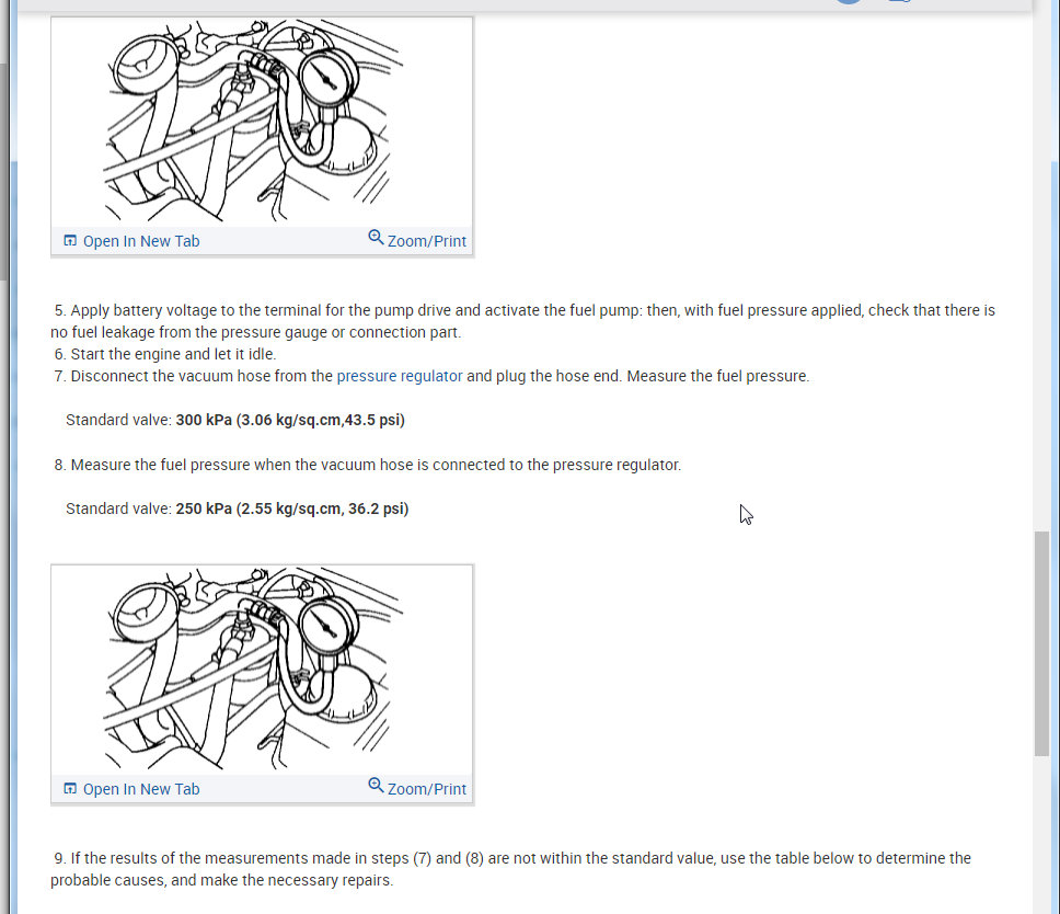

Below is the process from the manual on how to do this test on your engine.
They mention injectors and clearly if your engine is a carb then you can ignore that part.
However, I can't remember the last time I checked pressure on a carb engine as it needs minimal pressure so I just take the line to the filter off and crank the engine with the line in a bucket to see if you have flow and decent pressure. If you do then the filter is clogged or there is a pinched line.
If not then I would just replace the pump. Just because it is new, doesn't mean it is working. Let us know if you have other questions.
