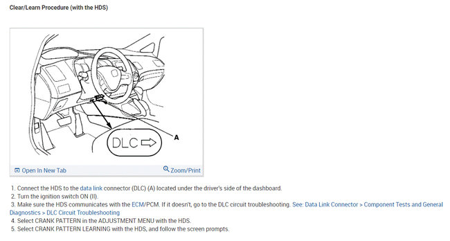

In the morning the car starts. But when I drive in the traffic for distance and park. The car will not start immediately until after about 20 minutes when the engine has cooled down.
May 3, 2021 at 9:04 PM
  • 110,240 POSTS

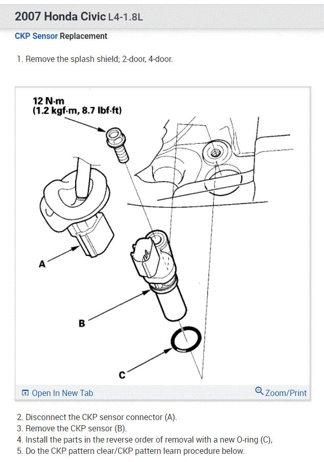

What you described sounds like a bad crankshaft position sensor. When they start to fail, heat adversely affects them. The easiest way to check is either check for spark to the spark plugs when it won't start, or attach a live data scan tool and check for an RPM signal when cranking (no start). Here is a link that shows how to check for spark. This will need to be done when the vehicle fails to start.
Do me a favor. Take a look through this link to see if it mirrors what you experience:
If you find it is bad, here is a link showing how in general how one is replaced:

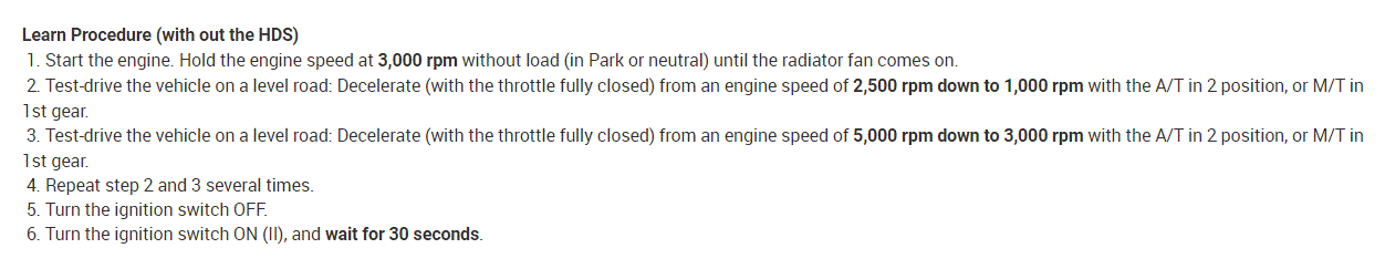

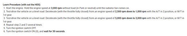

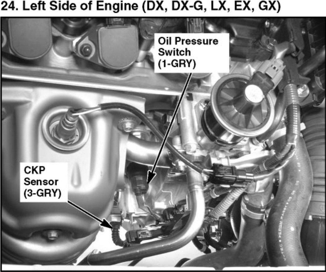

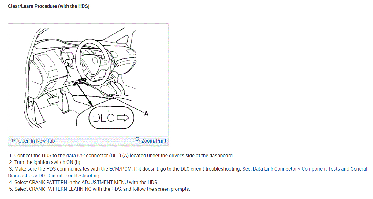

The pictures below include the directions specific to your vehicle for replacement and the relearn procedure. Note, the relearn can be done without a scan tool. I included that procedure as well. If you look at the last pic, it shows the sensor (CKP) location.
