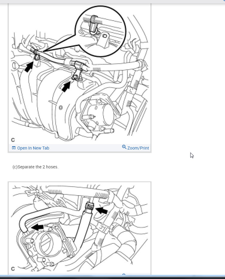

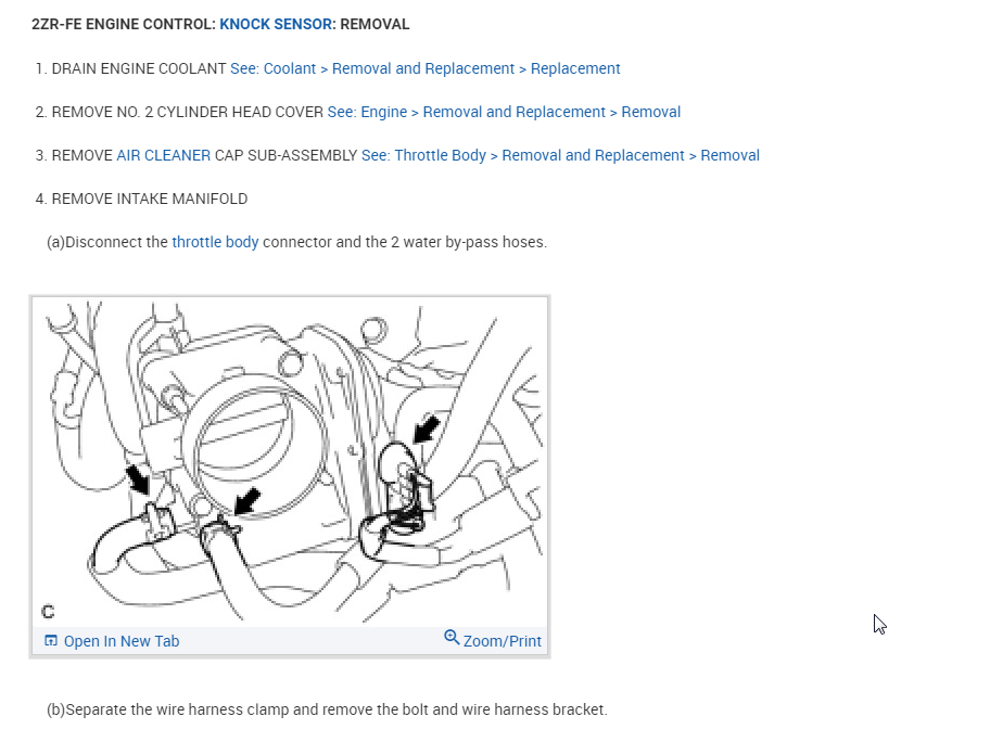

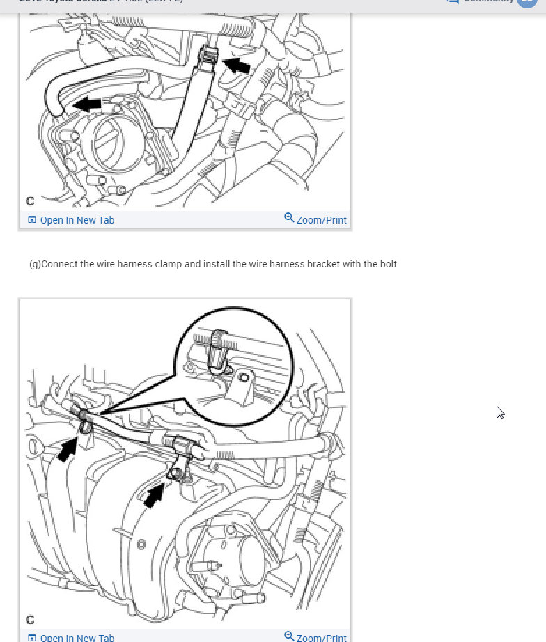

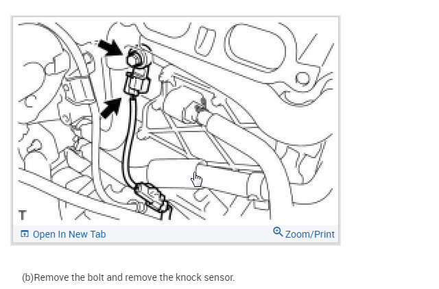

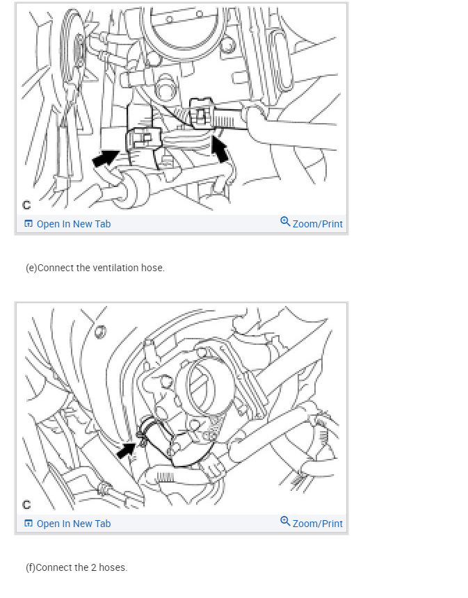

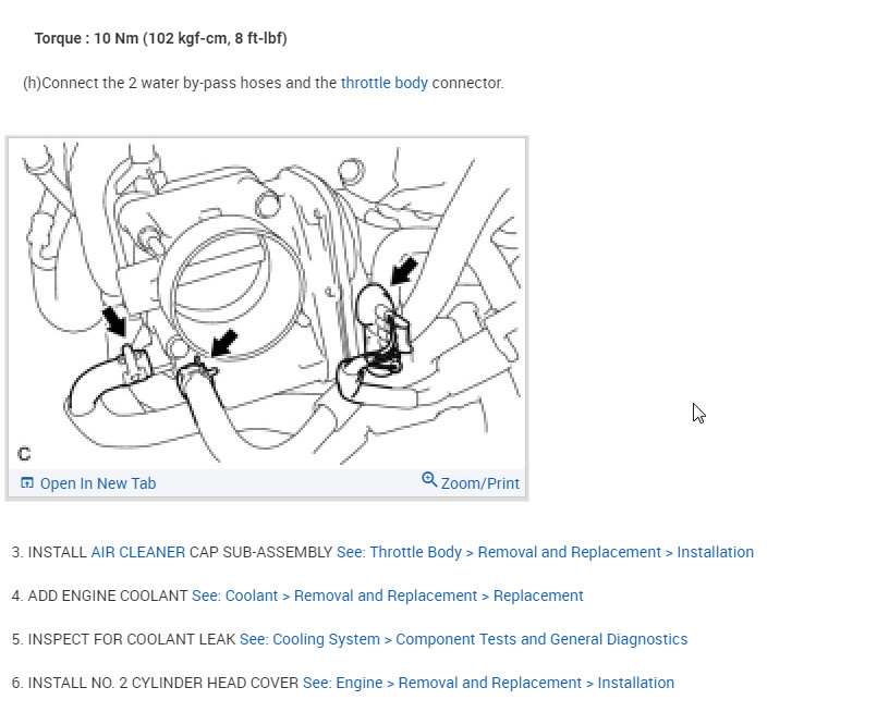

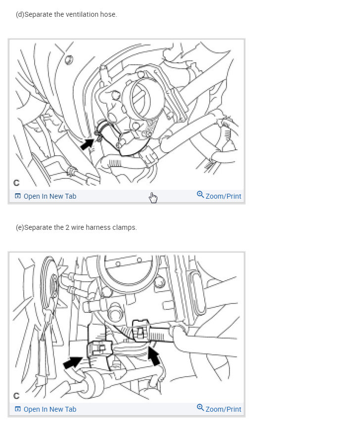

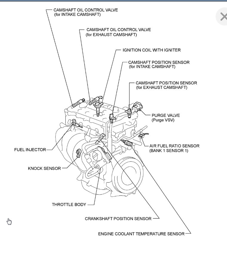

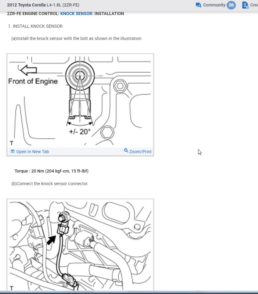

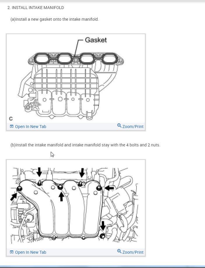

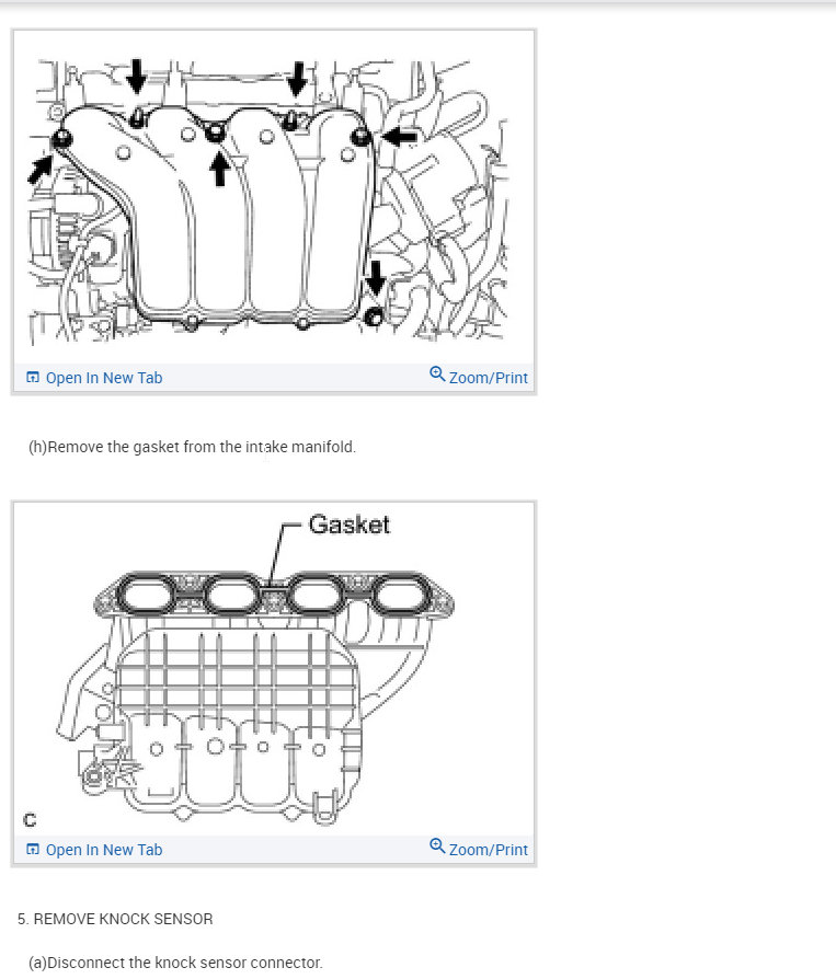

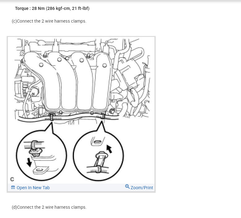

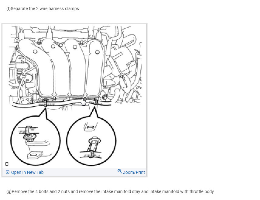

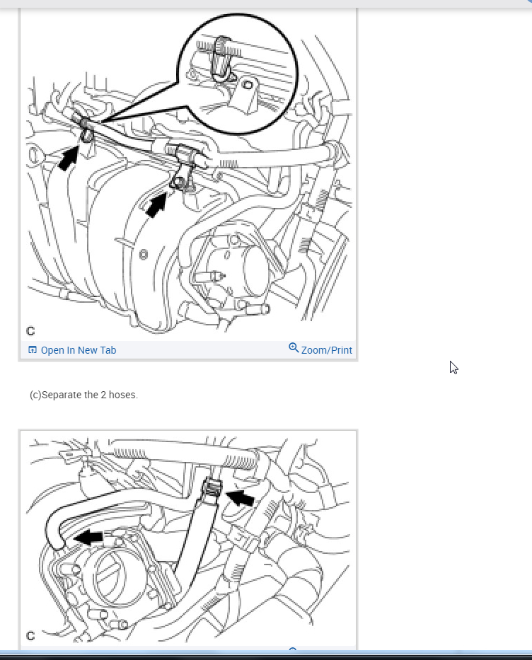

Please can you tell me or show me the location of knock sensor 1 for Toyota corolla 2012 2ZR,the car is not selecting last gear,so when I scan the car is complaining of knock
sensor 1.
Sep 11, 2019 at 10:47 PM
Here is the location of the knock sensor and the procedure to remove and install it. Please let me know if you need more info. Check out the diagrams (Below). Please let us know if you need anything else to get the problem fixed. Thanks
Sep 18, 2019 at 8:20 AM
