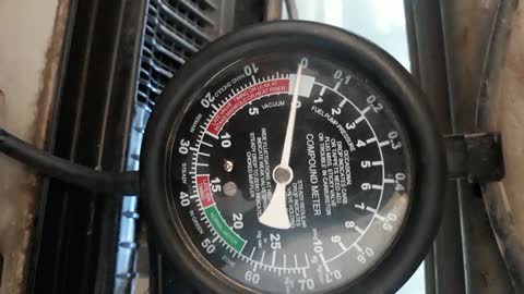

The problem with the low voltage reading of the oxygen sensor, could it be due to leakage problems in the intake or exhaust valves? Perform the test by putting a piece of paper in the exhaust, it sucks on the paper. Could you do a compression leak test?
May 12, 2020 at 3:59 AM
Yes, if you have vacuum, then you may have a compression issue.
Pull all the plugs and do a compression test.

Okay, that is good.
Remove the oil fill cap while the engine is running and see if you feel vacuum over the hole. You should feel positive pressure coming out, not a vacuum.
May 15, 2020 at 8:11 AM
MARIOC68
  • 120 POSTS
I did the test in the oil filler hole, I feel blow and suction. I did it with a piece of paper.
May 15, 2020 at 10:47 AM
If you feel suction, you have a leaking intake manifold gasket. There should be no vacuum at the fill for the oil.

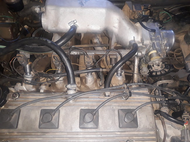

The left (thick) hose is the PCV valve and the right (thin) hose is a direct connection from the valve cover to the intake manifold. This hose is the one that made me empty in the oil filling mouth. Plug both sides of this hose. I retested with a running engine no longer generates vacuum.
May 16, 2020 at 5:18 AM
Okay, then you are good. Back to the catalytic converter testing.

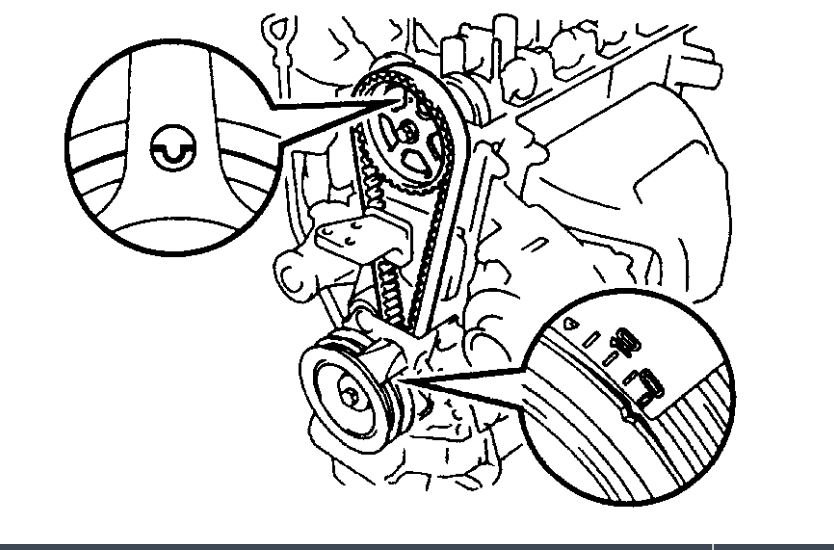

The next thing I would check is the timing. Check the valve timing on the belt and make sure the marks are correct.
I attached a diagram of the marks for you to check.
May 19, 2020 at 1:01 AM
MARIOC68
  • 120 POSTS
I check the timing of the distribution chain, it is correct.
May 19, 2020 at 5:03 AM
The reason I asked is the compression was very high. That tells me that maybe the chain is advanced from the normal setting.
May 19, 2020 at 5:42 AM
