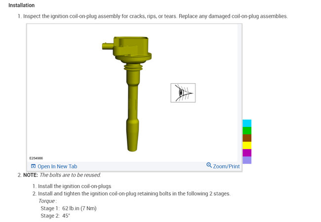

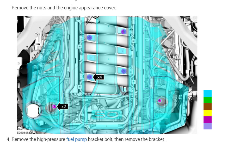

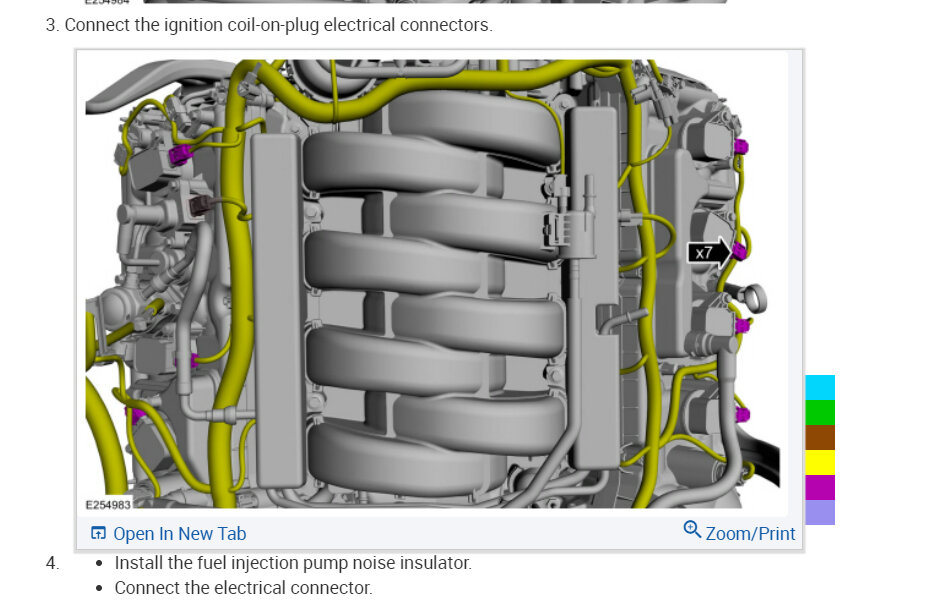

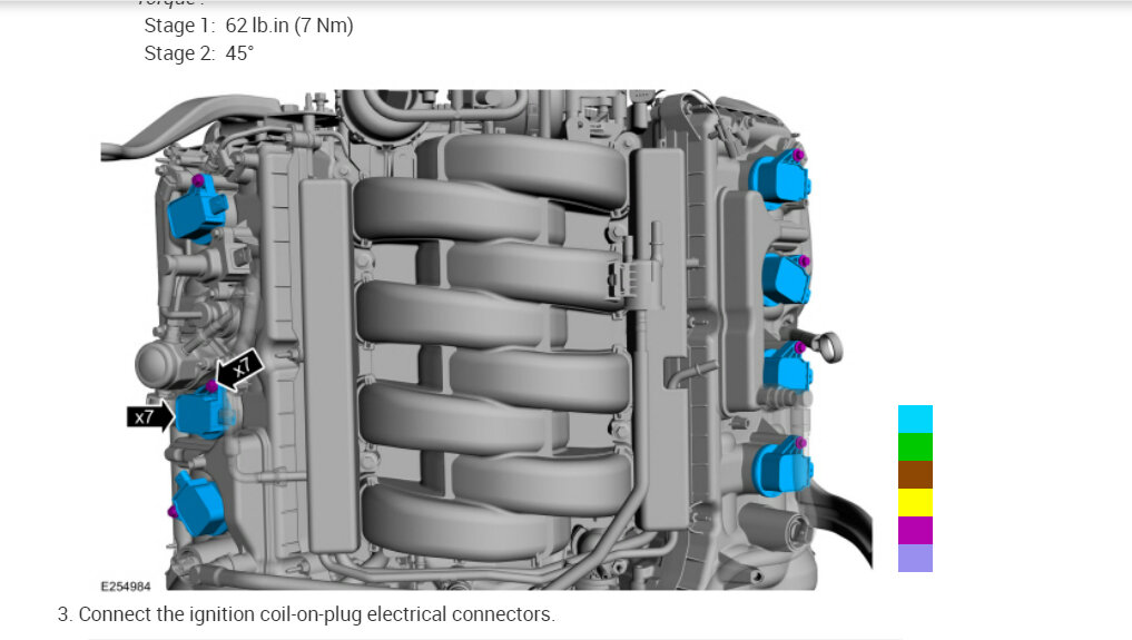

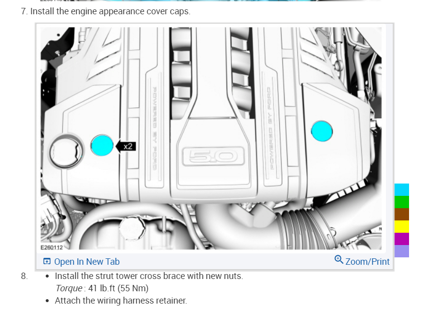

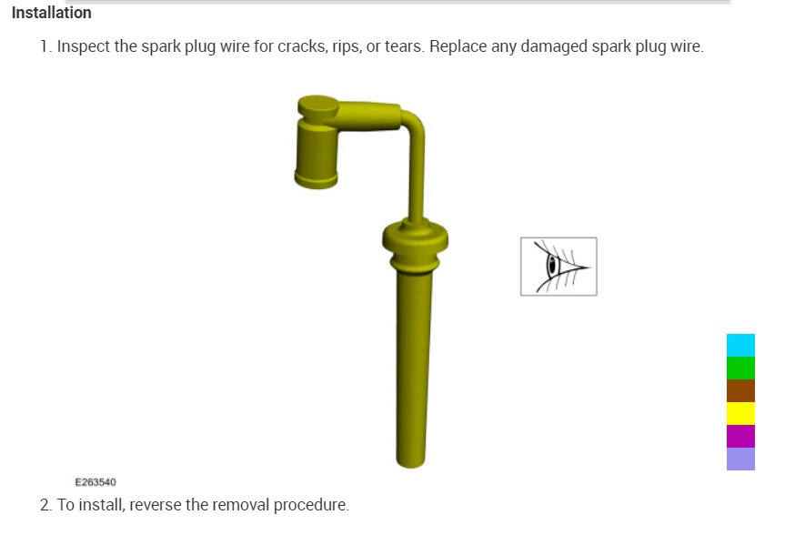

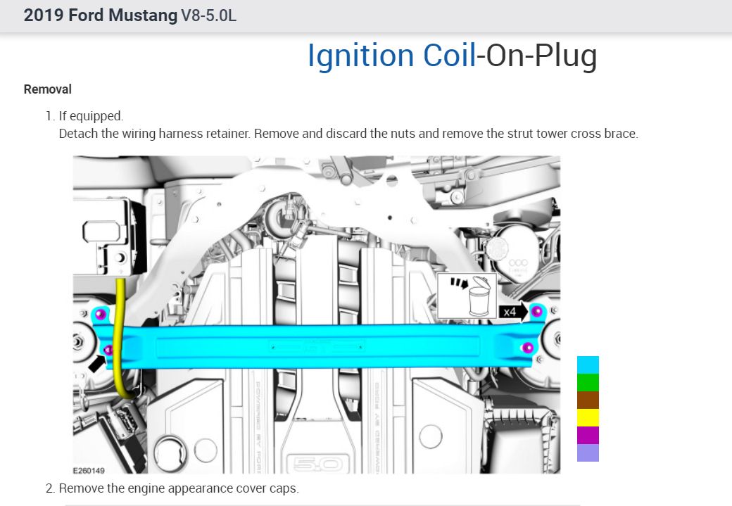

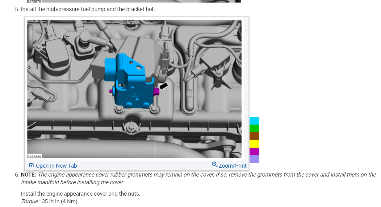

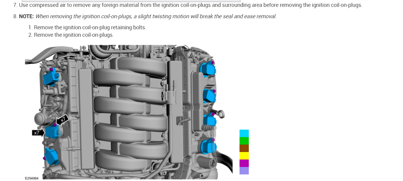

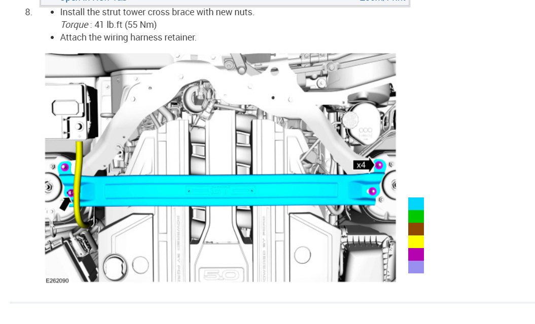

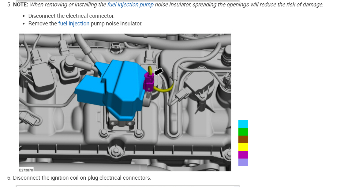

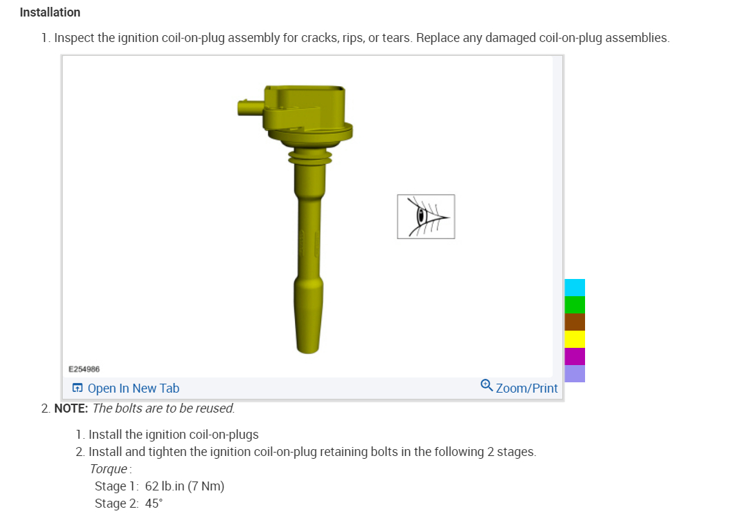

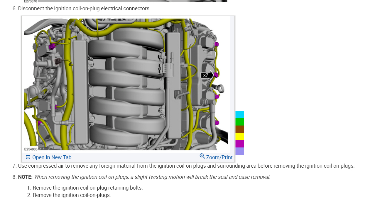

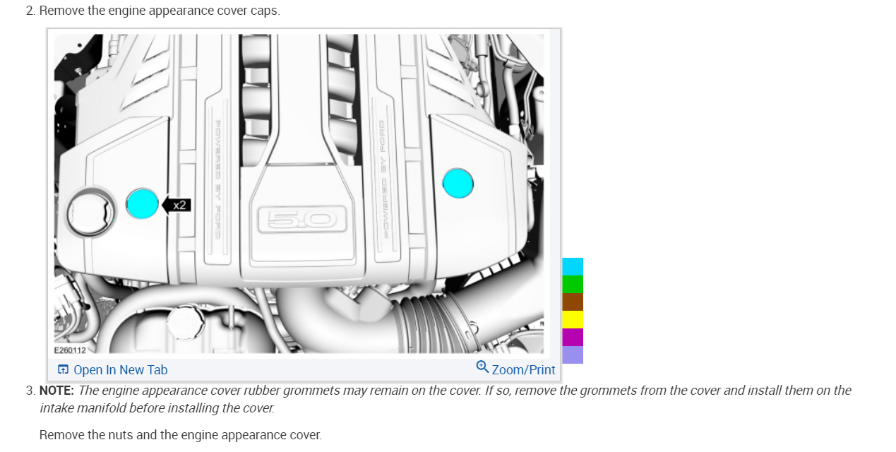

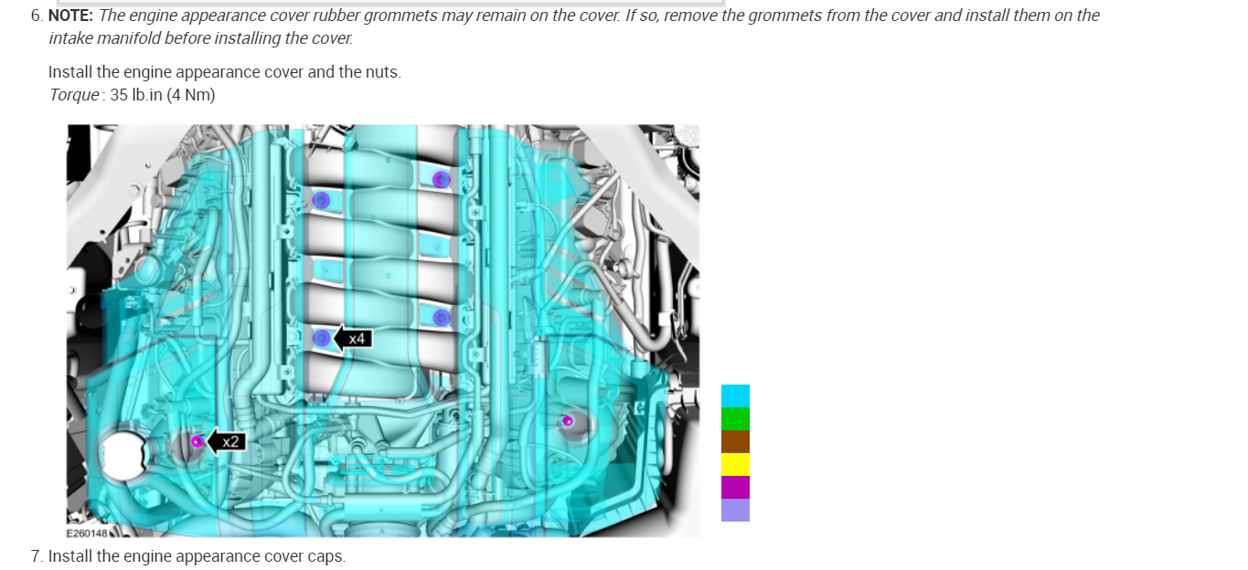

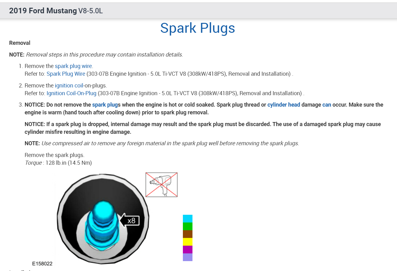

This sounds like you have an ignition coil or spark plug that is not working. Does your friend's scanner do misfire counts? If so, it will show the cylinder that is misfiring even though the code has not yet been triggered. I would remove the spark plug and install fresh ones to see if that fixes it.

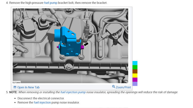

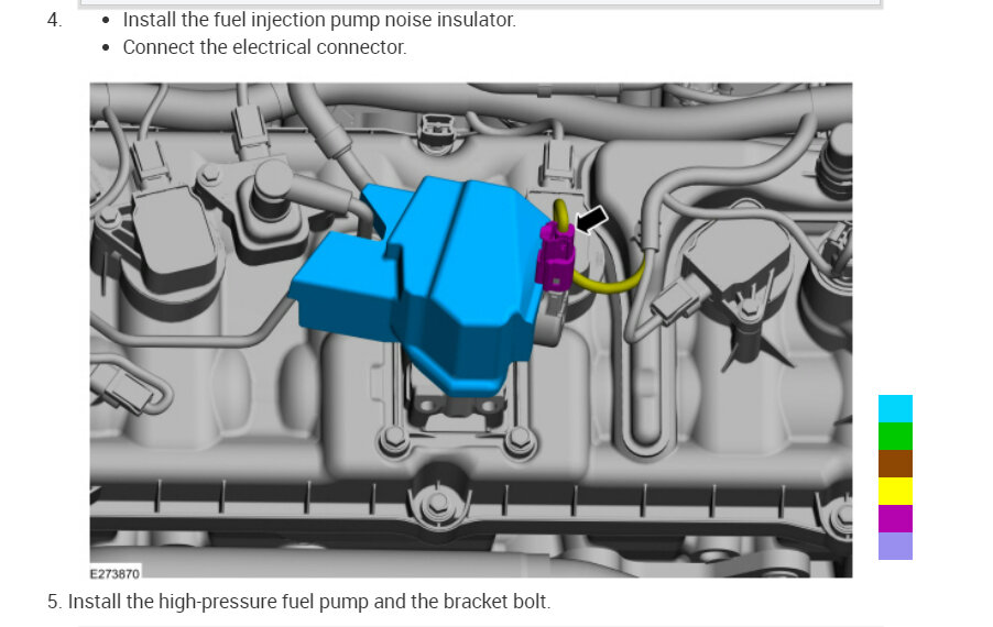

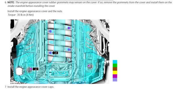

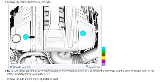

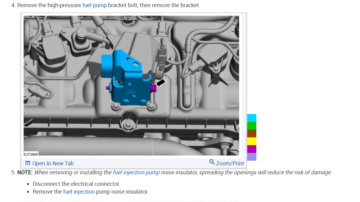

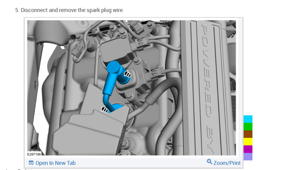

Here are two guides to help us fix the problem with instructions in the images below to help you with your car:
https://www.2carpros.com/articles/how-to-change-spark-plugs
and
Check out the images (below). Please let us know what happens. Also, some engines have a spark plug wire which may have popped off check for that as well.

Yep, the coils go out all the time. Use a name brand part, does your car have wires? If so, I would replace those as well. Please let me know what you find. Is the engine making any kind of abnormal noise?

It might very well be the coils, me and a friend were unplugging them one by one last night and the engine seemed unfazed by 1 or 2 of them. I just ordered all 8 coils online from a Ford dealership I will definitely let you know. Thank you
Oct 13, 2022 at 8:03 AM
  • 55,405 POSTS
Yep, that should fix it. let me know.
