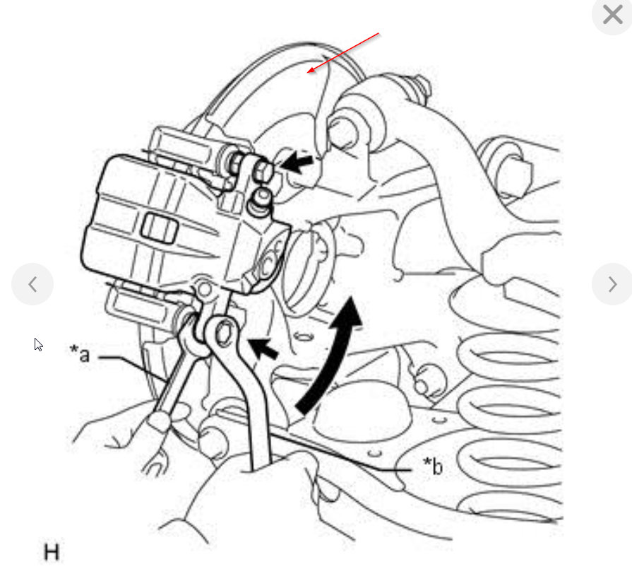

So if there are no heat shields rattling then we need to try and use this same technique on as many components we can find. Starting with the backing plates or dust shields that are part of the braking system. This would fit with the idea that it makes more noise when turning.
These dust shields are basically there to protect the brake rotor from things kicking up from the road and try to limit the brake dust from getting on the suspension components. If they are loose or bent they will make contact with the rotor and cause this noise. Normally they make a scarping noise but we need to check them.
