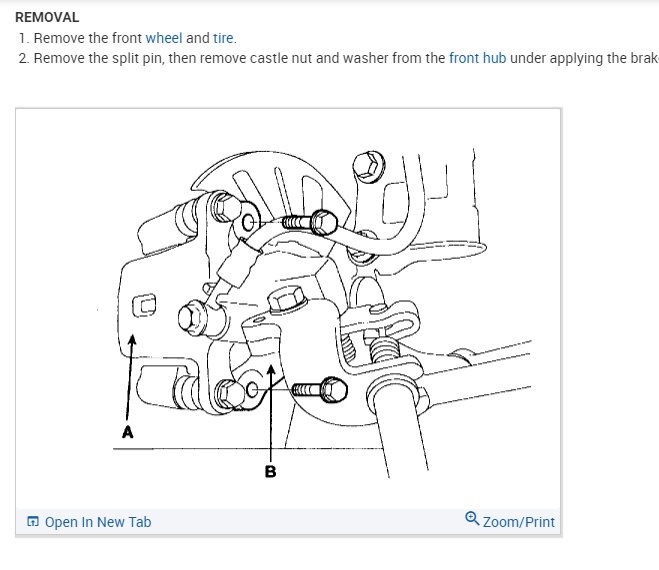

My mother bought me the car listed above in December of 2022; I believe from an auction right before she passed. About a month later I noticed a weird sound like a humming noise coming from the front of the car but only after hitting around 30 MPH. I don't know a lot about cars. I've had a couple people tell me they think it's the wheel bearing. So, I Googled how to check because i will be making a long trip in about 2 weeks and it said to try to move the tires while on the ground and then also try to shake it horizontal and vertical ways to see if it moves and it doesn't which is confusing. While jacked up it spins like normal and doesn't make any noise. In light of my mom passing and dealing with all her stuff I'm financially struggling and only have a little money to be able to fix it hopefully so I can't afford to buy a part and hope it fixes it cause non mechanics (my family) think it's that. Like I previously said I don't know a lot about cars and I don't know anything about the car history besides my mom got it through an auction around Albany Oregon 7 months ago I'm hoping to just get expert advice on the possibilities it could be.

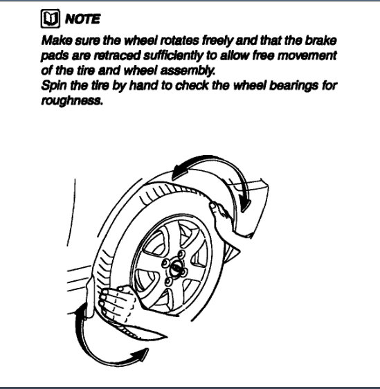

Sorry hopefully the other 2 videos upload because they have audio on them but yes when turning it makes a sound I want to say when turning left is louder also when I let go of the wheel the car starts pulling to the right. When I go over 60 mph it has a little vibration in the wheel. I've been watching a lot of videos and the best one to describe the noise is like putting a card up to the spokes of a bike tire while it's spinning but not so loud. I'm going to jack up the front end of the car now and see if I put my hand on the spring thing and spin the tire and see if I feel a vibration in it.
Jul 18, 2023 at 3:18 AM
$AVAGELOVE187
  • 9 POSTS
So, i jacked up the front end and held onto the springs things by tire while spinning it and there was a vibration on the right side. So, at this point I'm assuming it's the wheel bearings. So, my next question is, could I get the grease and grease the one in it to get me home which is about 5-hour trip and then get it replaced or get a new one?

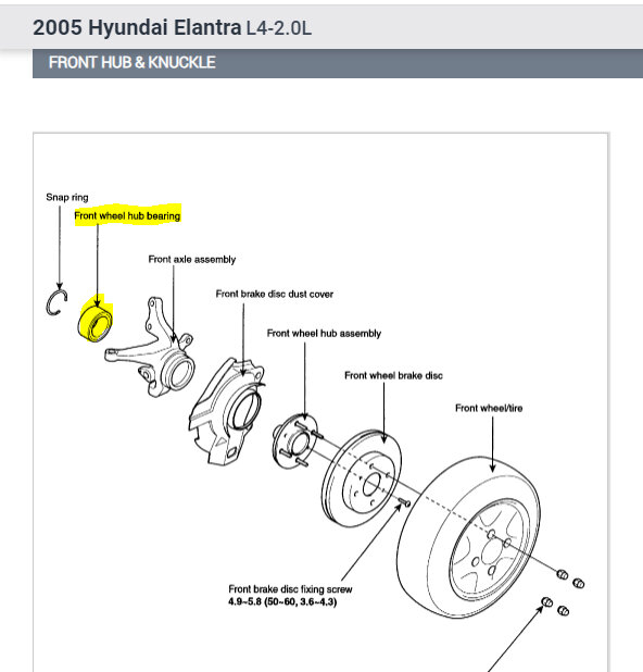

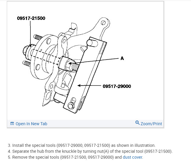

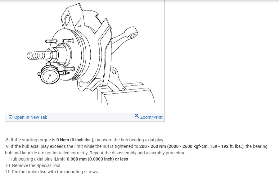

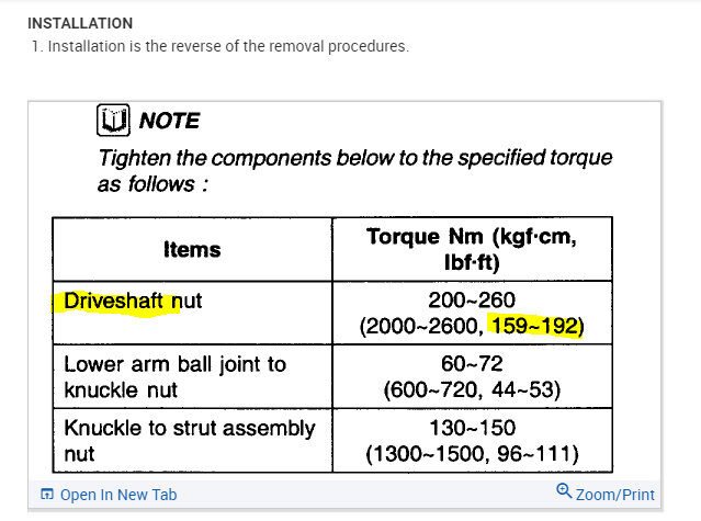

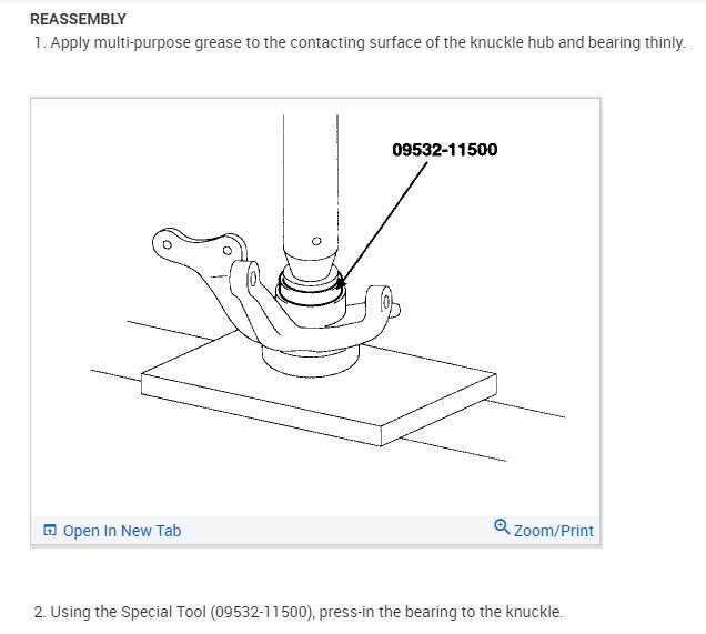

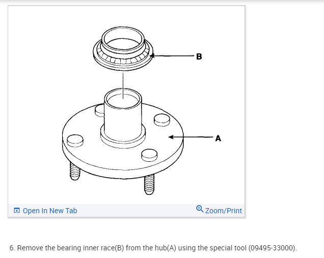

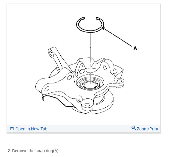

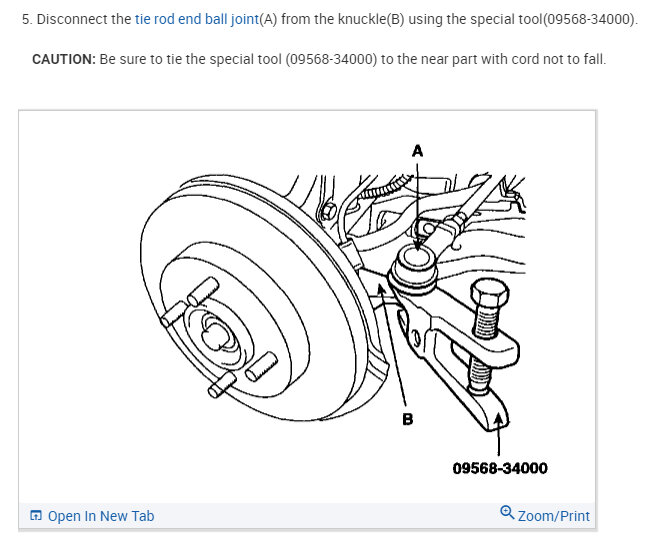

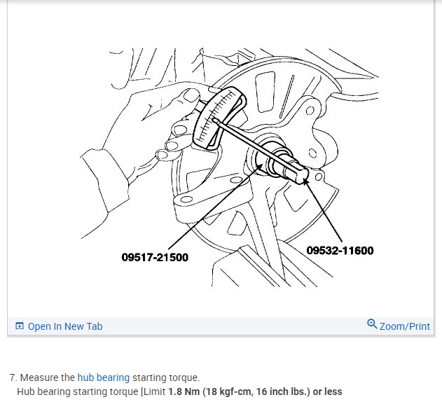

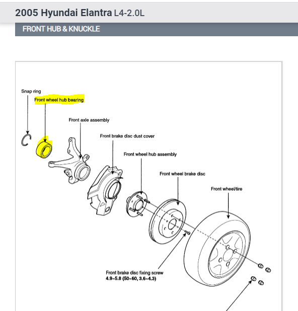

Oh man, I was hoping it wasn't that one. okay, one last question can you tell me what part number is the correct one and can I just replace the bearing or does or the hub assembly?
Jul 19, 2023 at 3:22 AM

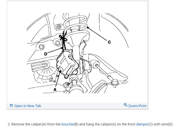

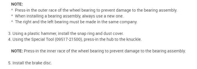

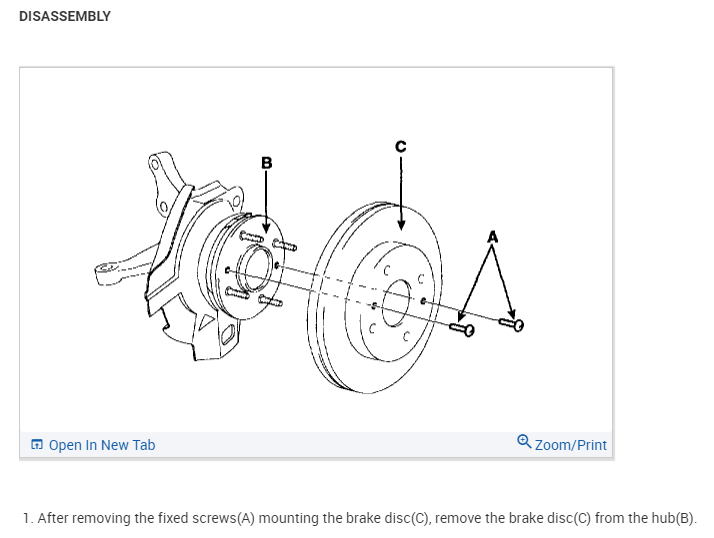

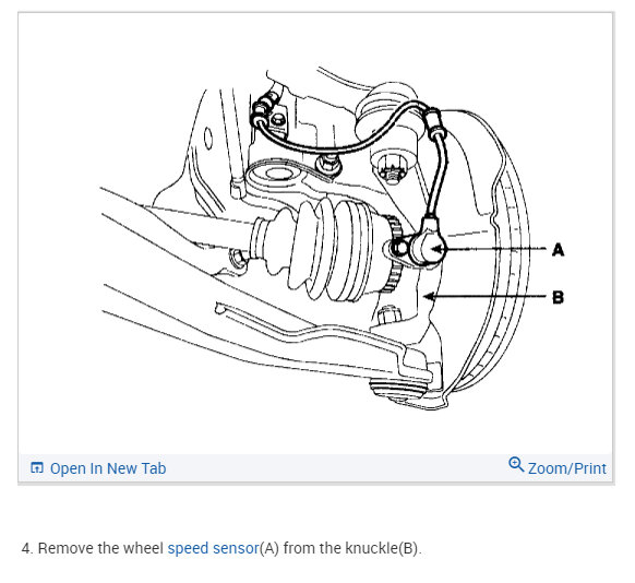

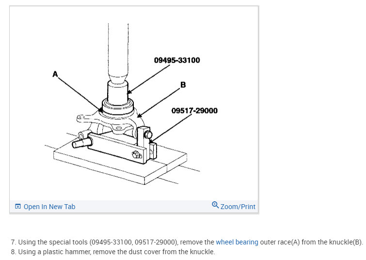

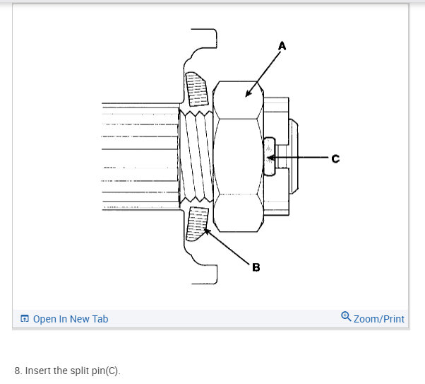

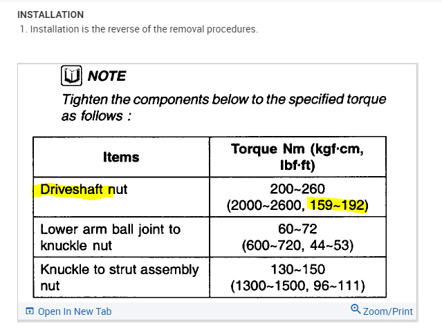

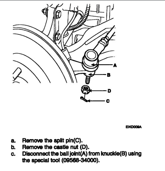

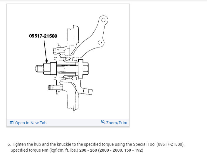

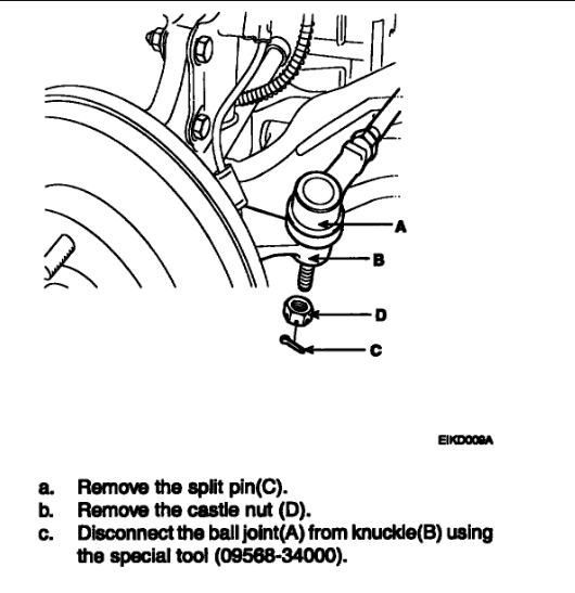

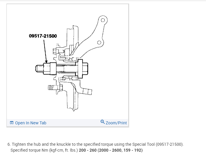

  • 110,244 POSTS
If you have to replace the front wheel hub bearing, it requires a press and some specialized tooling. It's actually a somewhat big job. Also, you can just replace the bearing.
I attached the directions below. Take a look through them and let me know if you have questions or if I can help.
