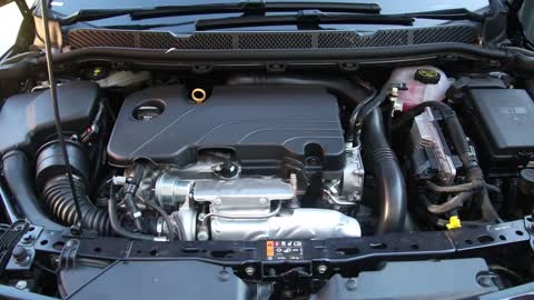

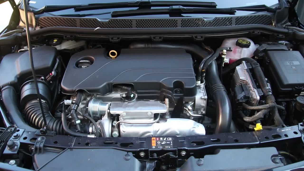

Here is what i have got. towards the end of the video I was going from D to R, though it wasn't doing the issue.
Oct 8, 2020 at 5:12 PM
  • 110,240 POSTS
It doesn't look like it's moving too much, but with 4,000 miles, it appears more than I would have thought. If you place it in gear and while holding the brake press the throttle lightly, does it move a lot more?
Oct 9, 2020 at 2:14 PM
TYOUIL
  • 7 POSTS
Well, I know for a fact that when I change from P to R when I first turn it on for the day and the tachometer is just over 1 when it’s warming up. It feels like there is no major movement.
Oct 9, 2020 at 6:06 PM
  • 110,240 POSTS
Chance are then, it is something to do with the transmission itself. Keep in mind, the transmission mounts/engine mounts receive different torque based on the gear (D or R) you select. So, you could have a bad mount that may get worse over time.
