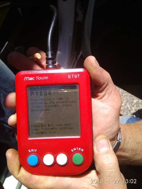

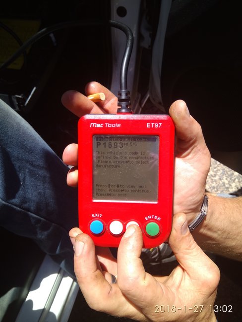

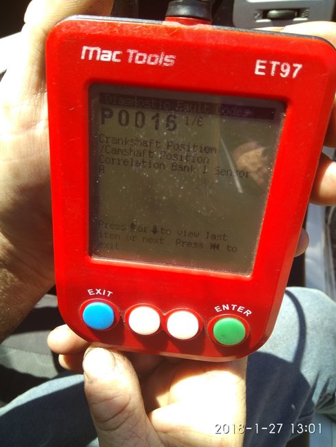

Hi, MHPAUTOS,
i have three error codes
P1693, P1696 And P0016.
Device showed:
P1693 - Unknown.
P1696 - Unknown.
and P0016 - Crankshaft position/camshaft position correction bank 1 sensor A.
The car has a misfire, i have told the mechanic to come and correct the timing, but he does not have the specification for my car.
could you let me know what the other two error codes are please?
Jan 26, 2018 at 7:45 PM
MHPAUTOS
  • 31,937 POSTS
P1696 Immobilizer Key Mismatched, you may have a clone key, that is not a key that has been coded correctly.
P1693 HYUNDAI - Transmission Control Module MIL Request Circuit Malfunction
These may be history codes and not active, as if they were active the car would not start normally. Clear codes and make sure car starts on both keys, and re code to see if they have cleared.
P0016 HYUNDAI - Crankshaft Position-Camshaft Position Correction- Bank 1 Sensor 'A' 1.
Comment Possible causes Dirty Oil Low engine oil level Faulty Valve Timing Control (VTC) Valve Timing Control (VTC) harness is open or shorted circuit. Valve Timing Control (VTC) circuit poor electrical connector Incorrect timing Engine mechanical problems Damaged Engine Control Module (ECM).
