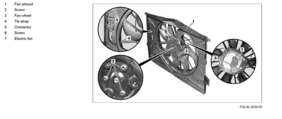

I have seen where the fan motor loose their strength and become weak not being able to pull the air through the radiator.
Here is a guide to show you what you are in for when changing out the fan motors.
https://www.2carpros.com/articles/replace-electric-fan-motor
and here is what it is like on your car (below)
I would change the thermostat out as well just to be safe.

Hi yes this is the same suction fan above in photo,
I bought a temperature gun and what I figure out is while driving on highway high speed I stop onside of the road and check upper hose is 87c and lower is 82c this is good and now I tired idle the car for long time and checked the hose temperature upper is 90c and lower is also 90c suction fan is spinning and upper and lower hose are in pressure and because of too much pressure coolant not circulating properly at idle while opening heater temperature goes down to normal quickly is now radiator not doing his job to cool the coolant?

I figure out the problem already it’s the suction fan not spinning on time and when it spin speed is slow need to be fast too to control increasing temperature. In my climate control there is secret menu in that option 10no blower control speed, in that I can see my suction fan speed running at 25% at idle but when I accelerate the speed increase but not much and then when I change the speed manually from there to 60% temperature goes down to normal at idle so maybe it kind of some sensor issue or it’s fan like fan need to be reprogrammed through computer??
