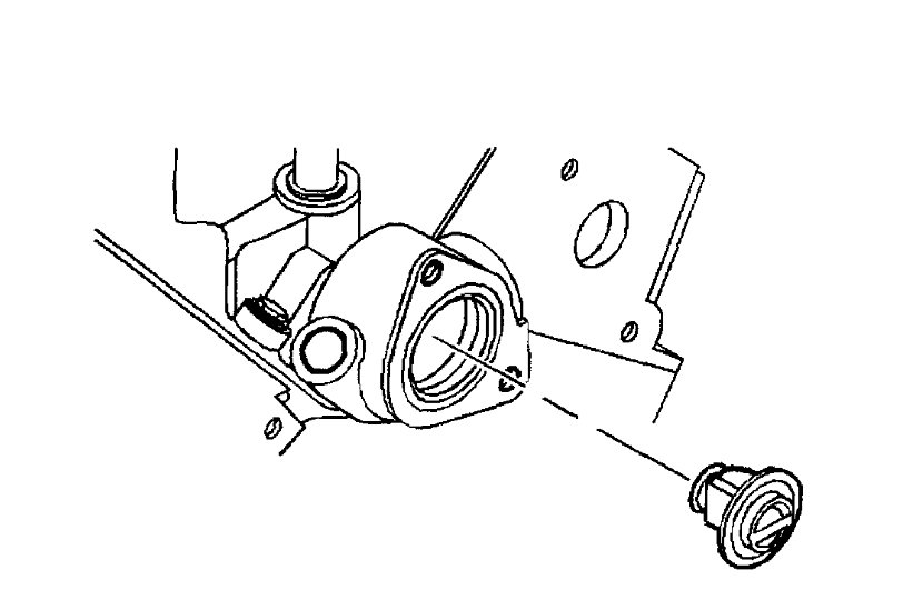

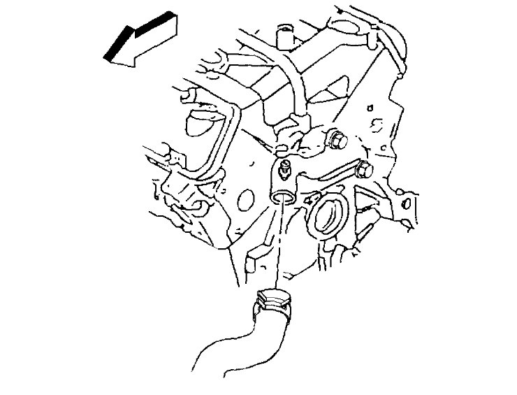

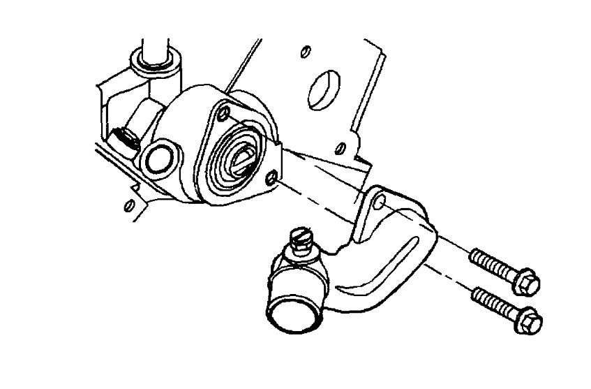

I have had it checked with the Chevrolet dealership they cannot find anything wrong with it. They said it needs to be getting hot but they will not let it get hot. It still overheating, it heats up real fast even when I go four blocks that goes halfway up on the needle. I am thinking it might be one of the cooling fan module but I cannot find the relay on my car. I need to know where it is at and how to remove it and it has got a new one. One of the fan seems to be working but the other one does not when the engine is hot. I also like to know how to change the thermostat if I could do it on my own.

Thermostat Replacement (3.4L)

1. Remove the air cleaner intake duct.
2. Partially drain the cooling system.
3. Use the J 38185 to reposition the hose clamp from the water outlet housing.
imageZoom/Print
4. Remove the radiator inlet hose from the water outlet housing.

6. Remove the water outlet housing bolts.
7. Remove the water outlet housing and the gasket.

8. Remove the thermostat.
9. Clean the water outlet mating surfaces.

I would start by changing the thermostat. That may take care of the entire issue.
