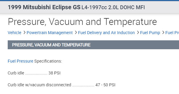

When I drive it seems like it does not want to accelerate. I push the gas and it is slow to get up in speed. I feel some vibration in the steering wheel, but RPM is normal. I changed spark plugs, wires, camshaft sensor, cleaned throttle body, changed air filter and some vacuum hoses. Mounts seem good. What can be going on? Thanks in advance.

This could be the result of a few things. Anytime there is a power loss, I always check to make sure the catalytic converter isn't partially plugged. Take a look through this link and let me know if anything seems to mirror what you experience:
Next, have you checked fuel pressure to see if it is within the manufacturer's specifications?
Here is a link that explains in general how it is done:
If you look at the attached pic below, it includes the manufacturer's fuel pressure specifications.
Try these two things. Also, let me know if the check engine light is staying on while the engine is running.
See pic below.

The mechanic told me it was at 50. He said it had perfect pressure. Recommended me to put an octane additive. I did and drove it for a while. Didn't really see any change.
Sep 10, 2022 at 3:03 AM
  • 110,240 POSTS
That is on the high end of pressure when the regulator is disconnected. So, yes, it should be fine. By chance, did he write down on the receipt if that was the pressure with the regulator vacuum disconnected? Just to confirm. With the regulator connected it should be approximately 38 PSI at idle.
If that is good, it's tuned up, the check engine light doesn't stay on, and you already did all the things you mentioned in the first post, I have to ask. Is the timing belt original? It shouldn't be bad at 80,000, but it does have several years on it.
