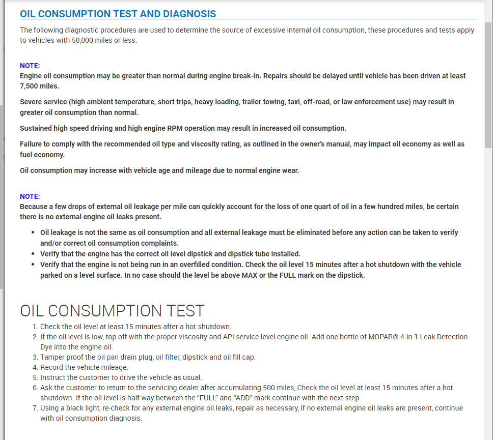

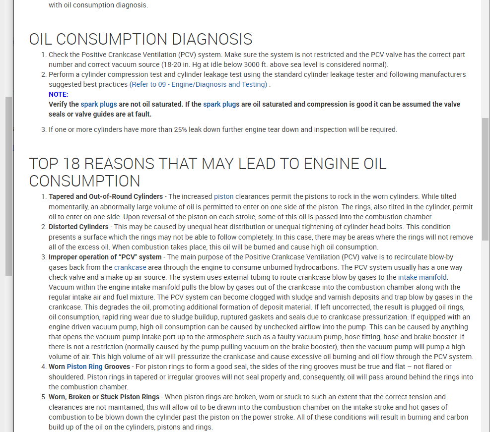

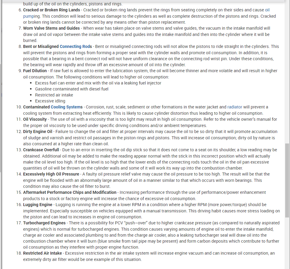

The only thing you need to keep an eye on is oil consumption. I attached the info on this below but I suspect you will be just fine.
