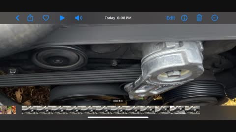

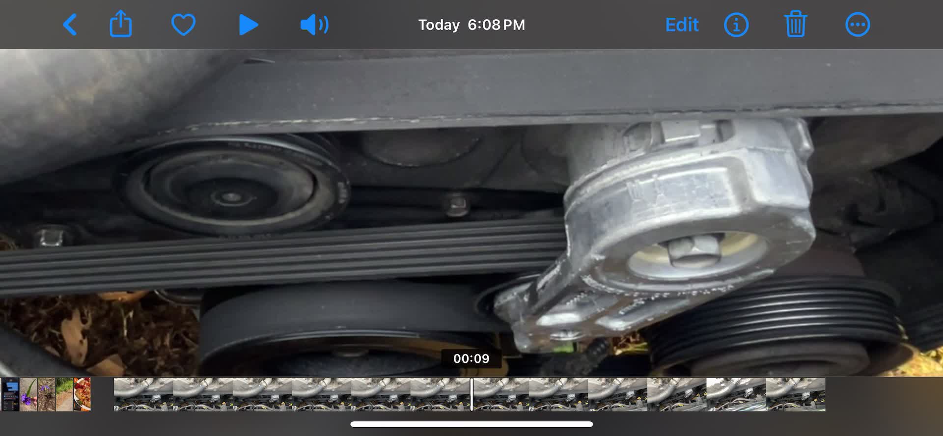

I replaced the spark plugs, the fuel pump, fuel sending unit, the water pump, the serpentine belt and serpentine tensioner. It also has a new battery in it. i also replaced the timing belt and made sure all my timing marks are lined up. i replaced the harmonic balancer and the ignition switch, but when i start my car, it idles and shakes rough, and it feels like it stumbles and wants to shut off. i can't even go a few feet when driving before it completely shuts off on me. i lifted the hood and i saw that my serpentine belt slips to the side of my serpentine tensioner, and it burns the side of the belt and the tensioner gets really hot.

Is everything aligned properly as far as the belt is concerned? In other words, can you tell if any of the pulleys are out of alignment? The tensioner is likely getting hot from the friction produced by the belt rubbing the tensioner.
Next, have you checked to make sure there are no engine vacuum leaks? That can cause a poor idle.

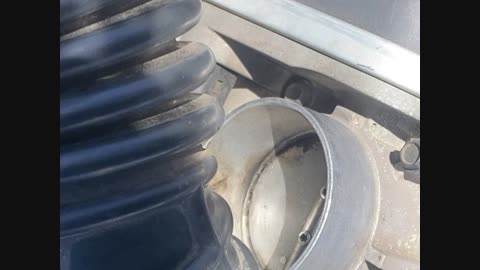

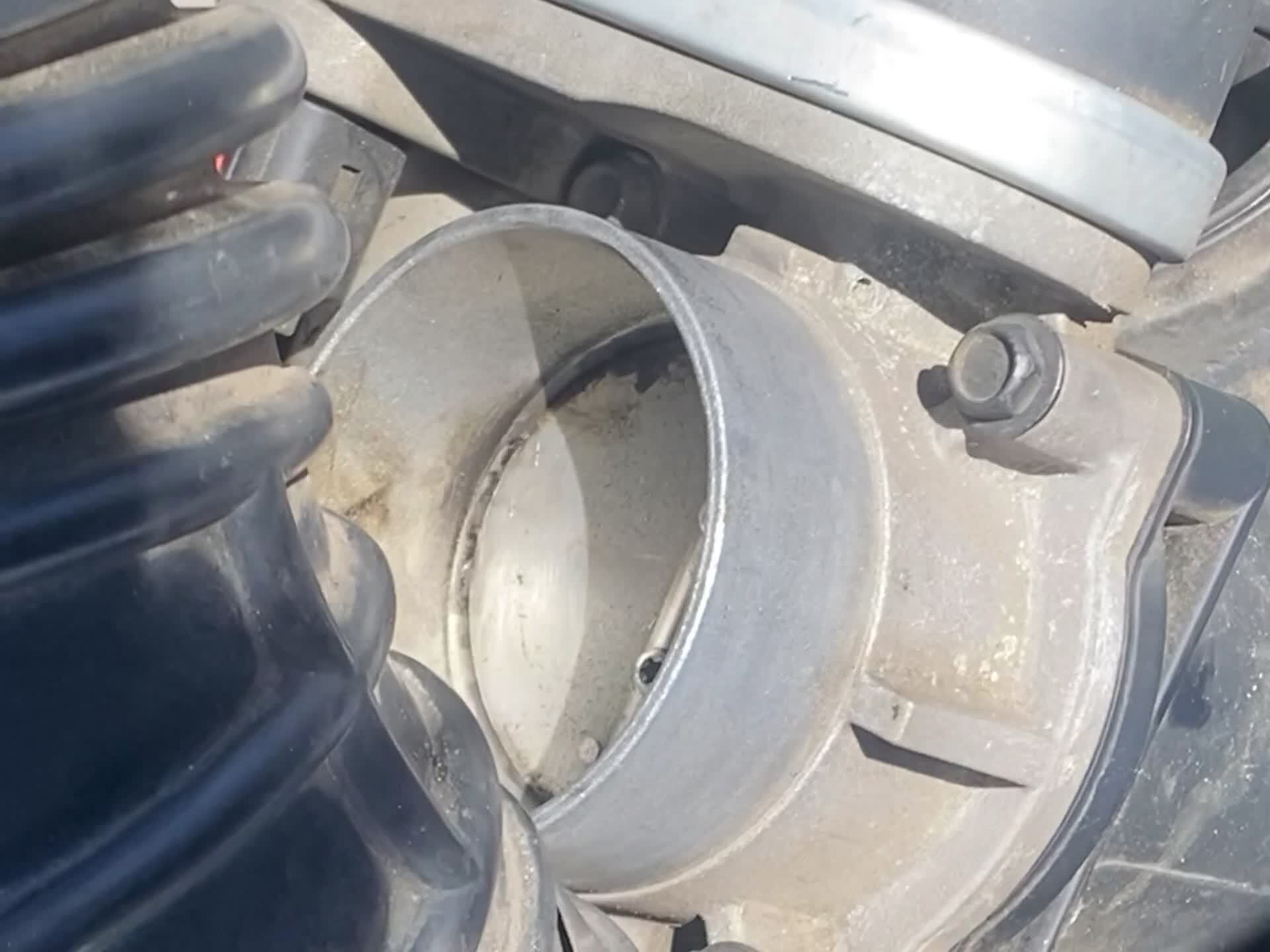

I'm going to have to check when i get home but i also have this going on as well. i don't know if it should open fully or not.

I checked the codes and i got one for p2314 but when i turn my engine on my check engine light goes off i checked the pulleys and all of them seemed to line up besides the crank a little bit i pushed it further back than i can and the belt is still slipping to the side of the tensioner and it gets really hot. i don't have any vacuum leaks as well.

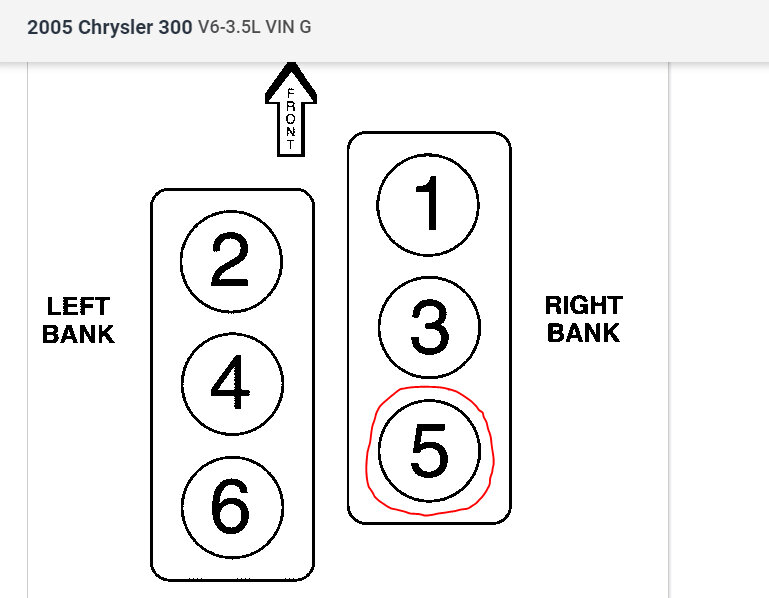

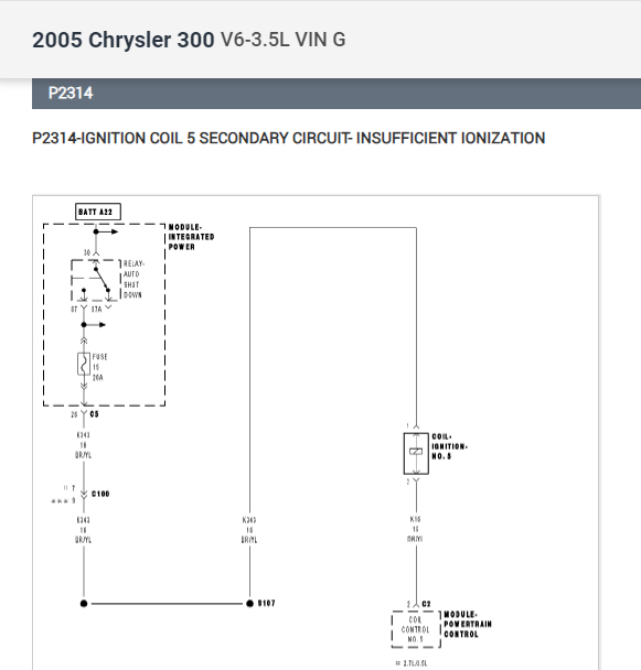

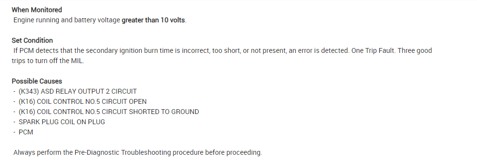

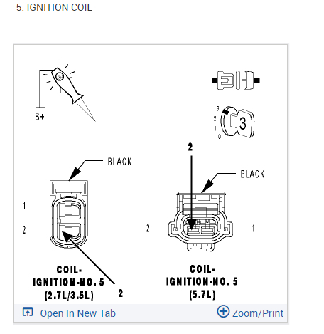

The code indicates an issue with the cylinder 5 ignition coil. Here is what I want you to do. Remove the ignition coil and switch it with a different one on the vehicle. If the coil itself is bad, the code will change to a different cylinder.
As far as the belt is concerned, how tight does it feel? The tensioner itself may be faulty.
See pic below for cylinder 5 location.
Mar 14, 2024 at 1:04 PM

i will check and i replaced the tensioner and the belt feels real tight just enough for me to turn it a little bit but my crank still seems like it's not lining up with the others it ripped my serpentine belt, so i bought a new one and it was starting to rip that one, so i got a new one and I'm not going to put it on there yet.

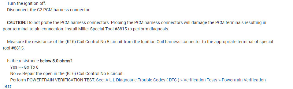

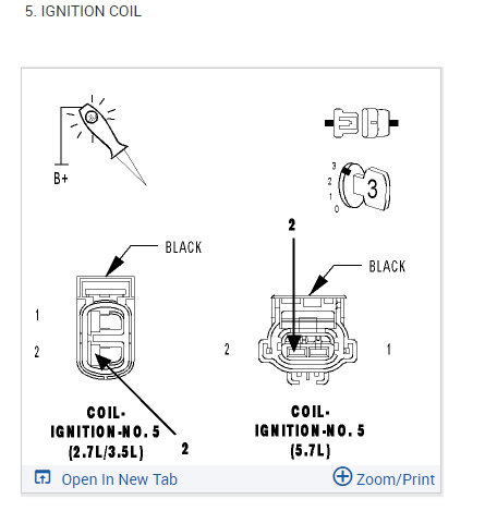

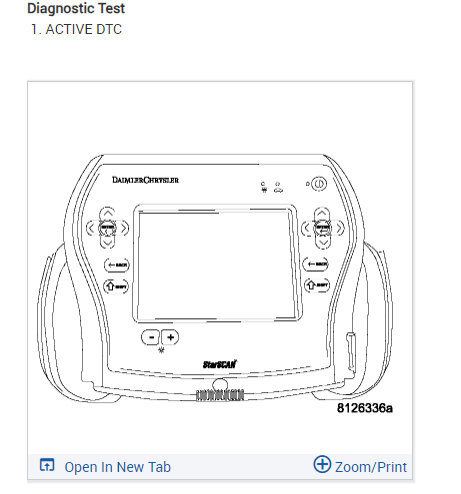

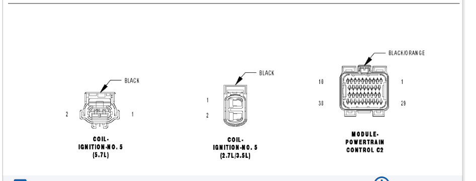

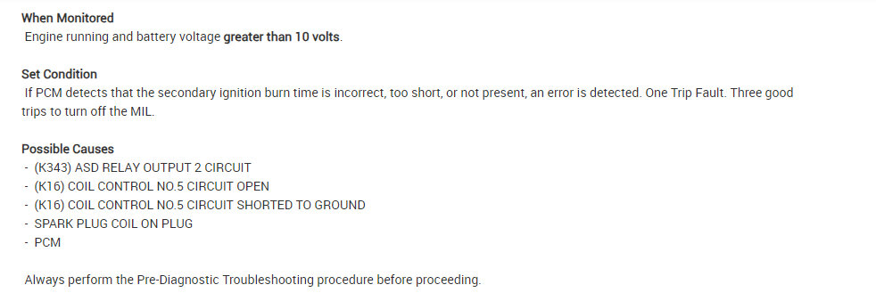

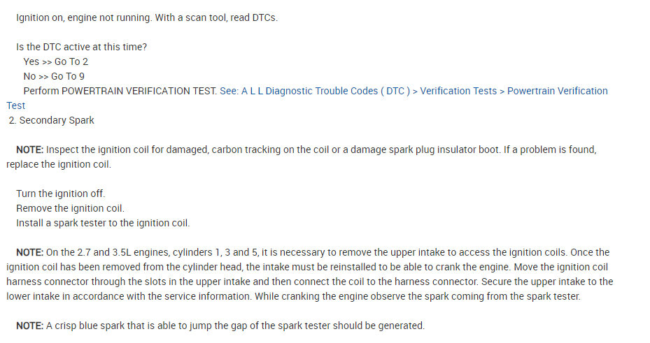

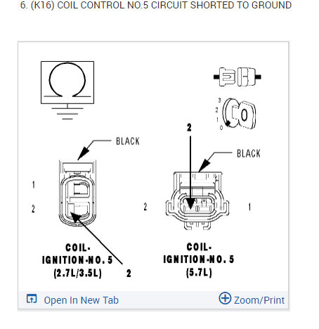

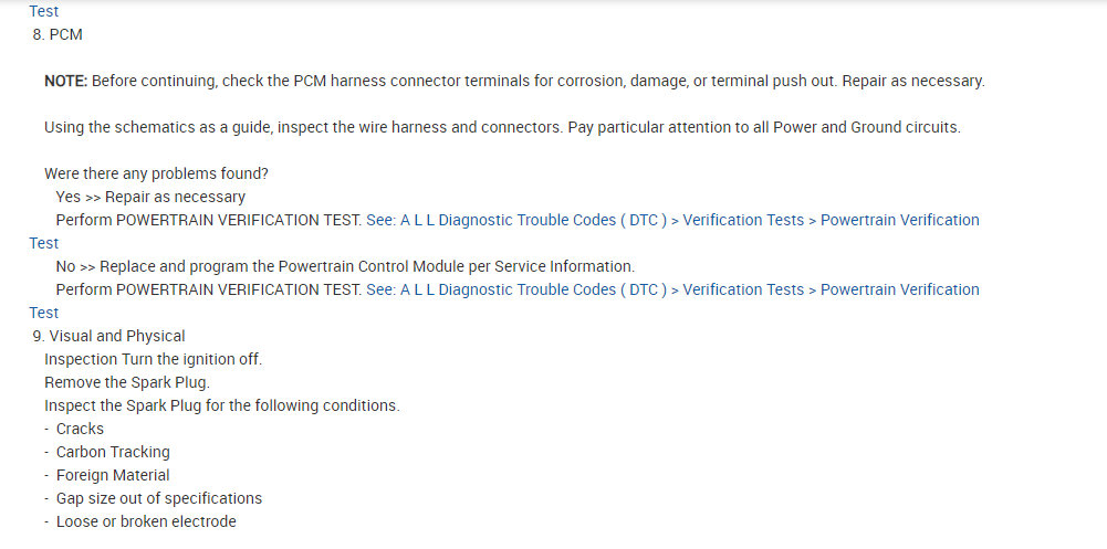

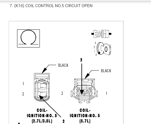

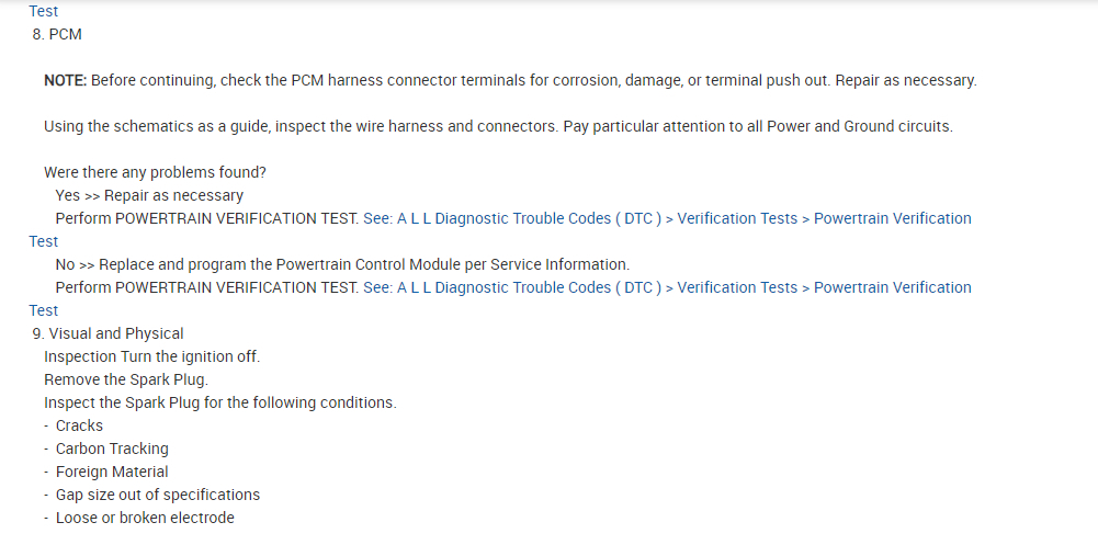

  • 110,244 POSTS

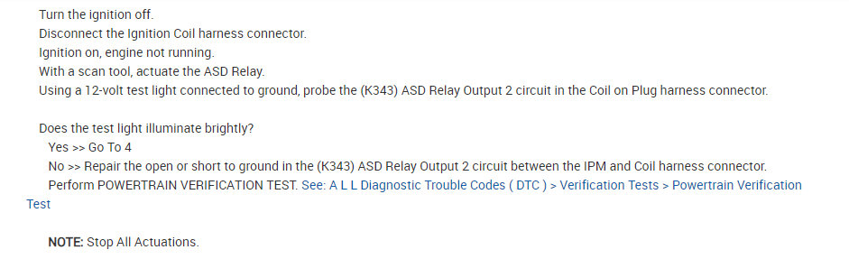

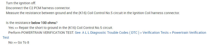

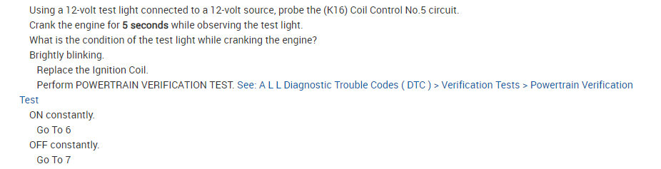

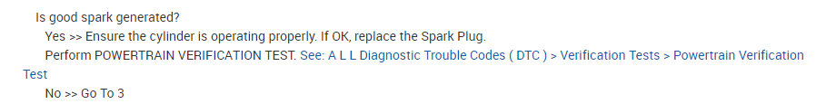

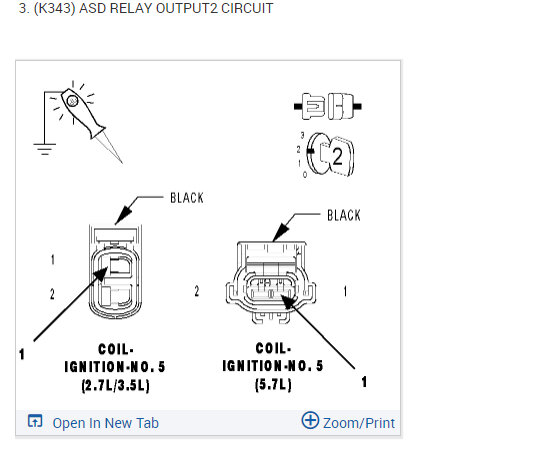

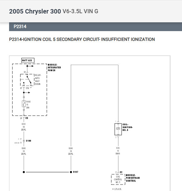

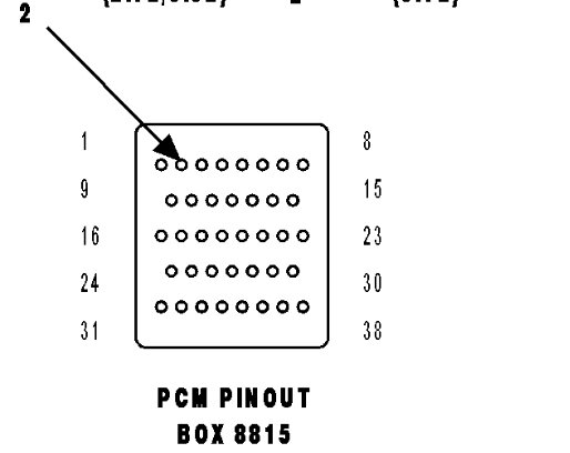

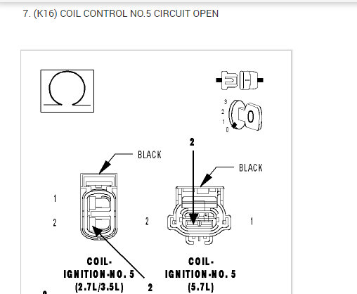

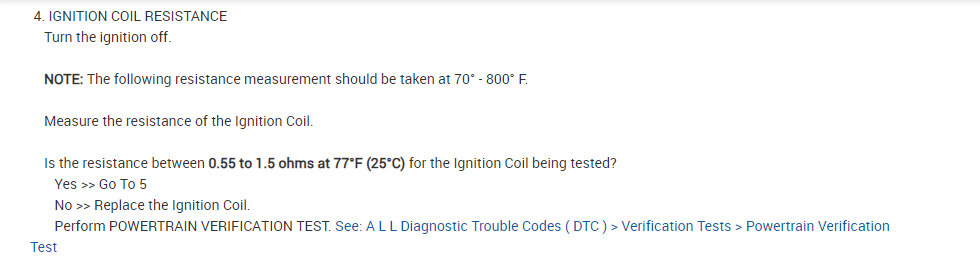

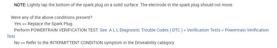

If the spark plugs are good, then we need to start chasing wires. If you look below, I attached diagnostics for the code. Take a look at them and let me know if you are comfortable performing them.
Also, I made the assumption that you cleared the code and then it returned. If that isn't the case, clear it and see if it comes back.

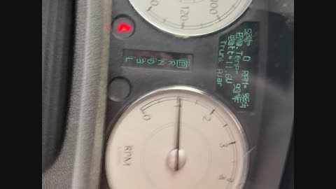

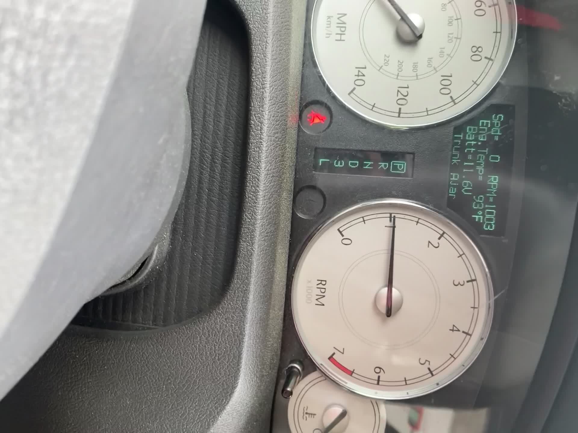

  • 110,244 POSTS
Is the engine running? It looks like it is based on the tachometer. If that is the case, the first thing to address is the voltage issue. Check to see if it is actually 11v running. That should be around 14v. All you need is a multimeter or voltmeter.

i don't have the serpentine belt on so the alternator isnt charging the battery but my car idle at 1000 and sum but then drops when i put my car in drive and it starts idling very rough and cuts off on me when i release the gas.

Don't run the engine too long with that belt off. The lower voltage can be playing havoc with the electronics. Also, the rough idle is likely still related to the cylinder 5 misfire. By any chance, are you comfortable performing the tests I listed above?
Make sure the belt, when reinstalled, has a good bit of tension on it. Also, before you install the belt, spin all the belt driven accessories to see if there is an excessive drag or play in them.
