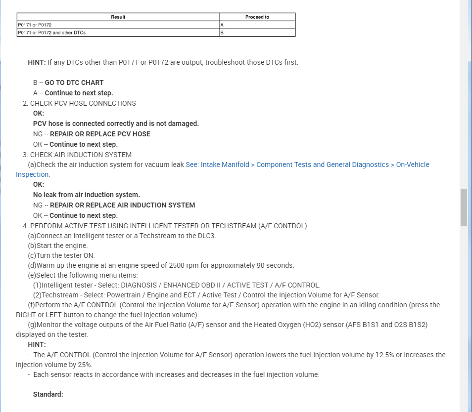

Also, we need to check for a vacuum leak and see if we can find anything as that is the most likely cause of what you are seeing. Here is a guide that talks about this.

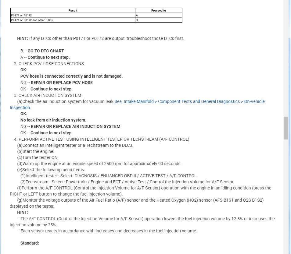

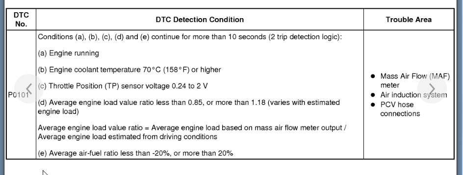

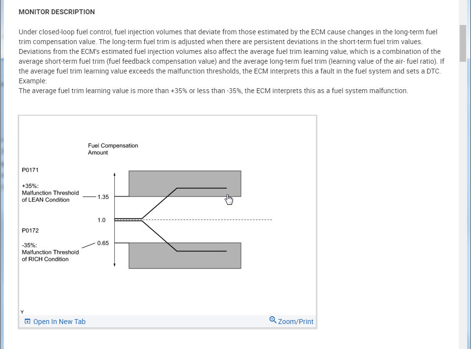

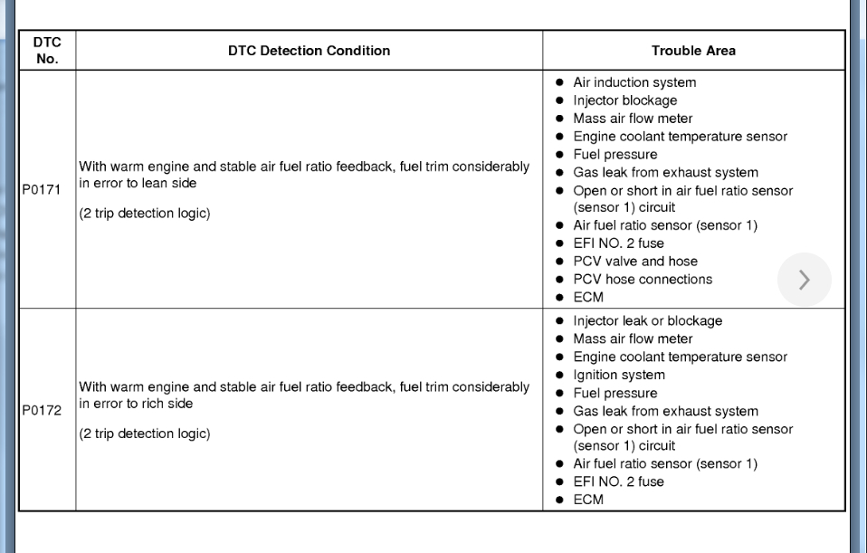

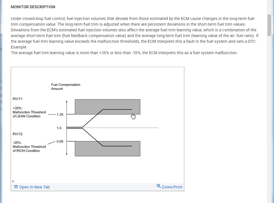

Yea, I tried the spraying carburetor cleaner on the hoses and nothing changed. The codes it gives now are P0172 and P0101.
Jun 15, 2020 at 6:38 AM
CHILLY08XB
Also, my spark plugs were really black so I changed them.
Jun 15, 2020 at 10:14 PM

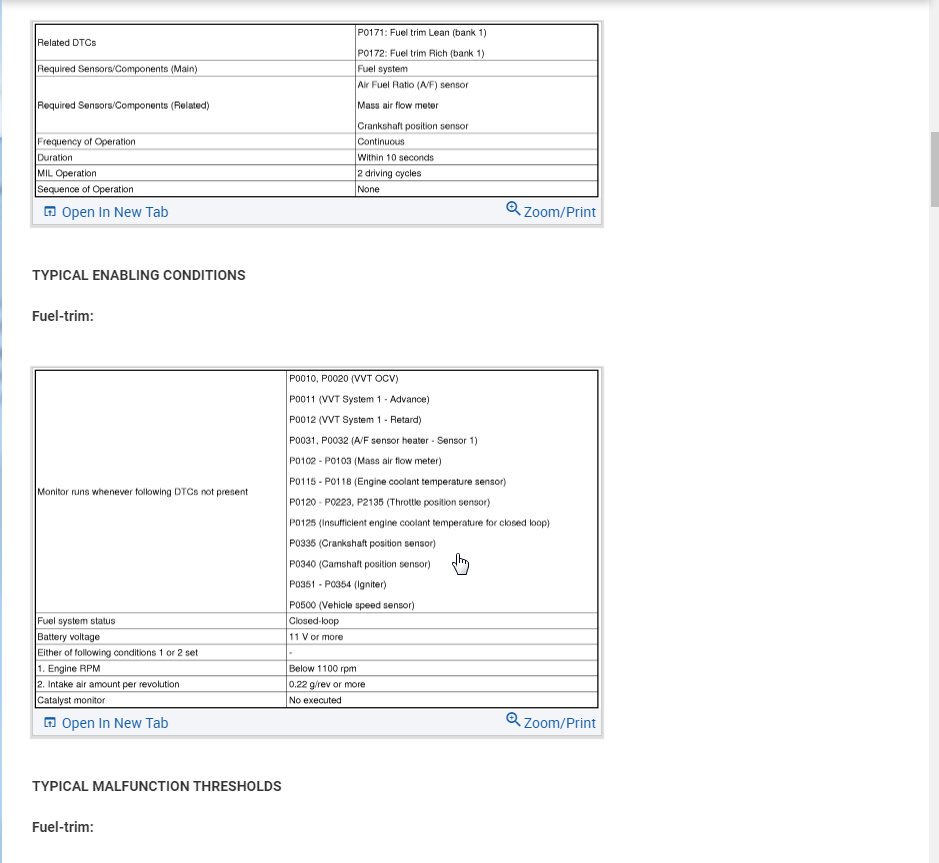

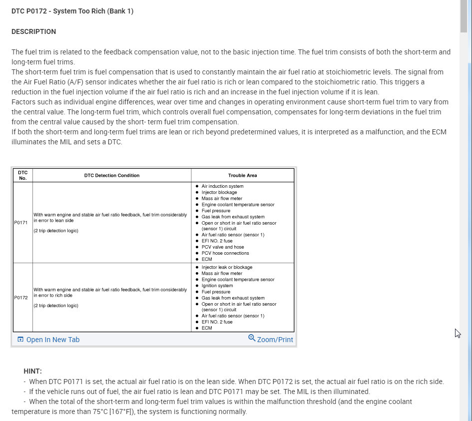

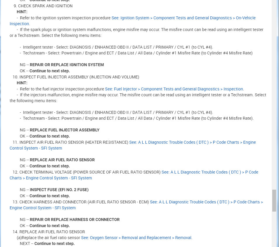

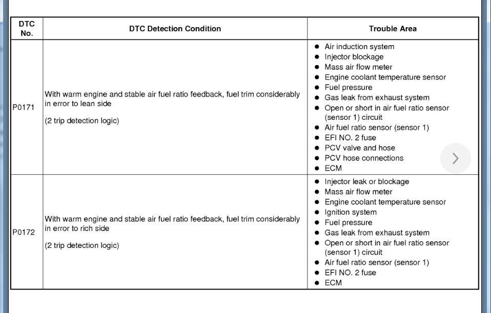

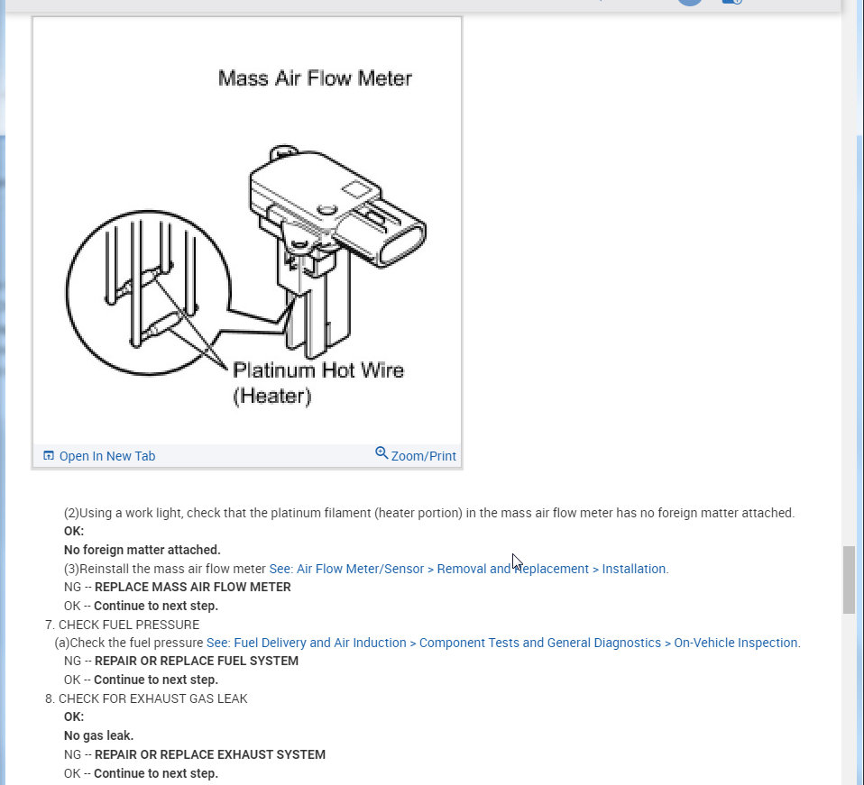

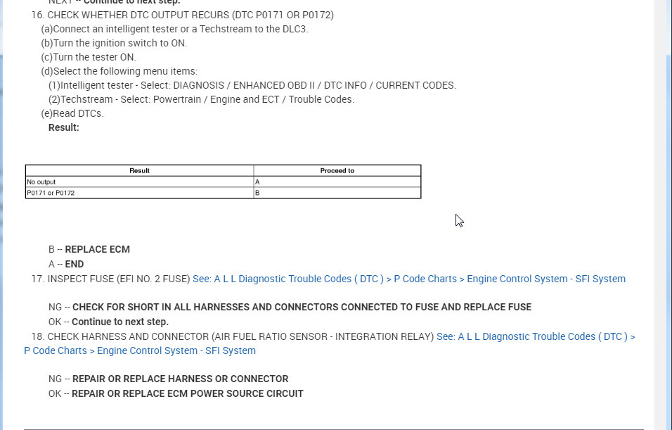

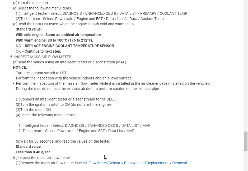

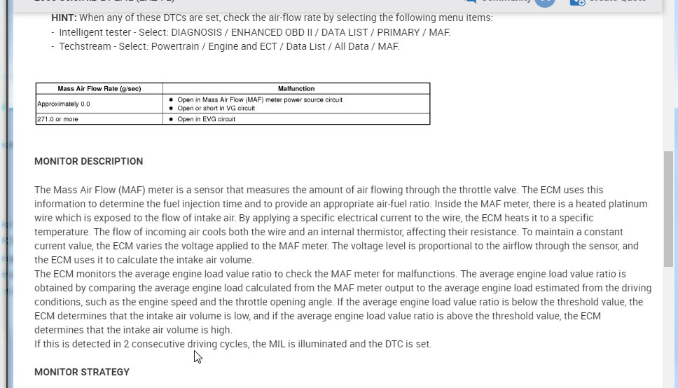

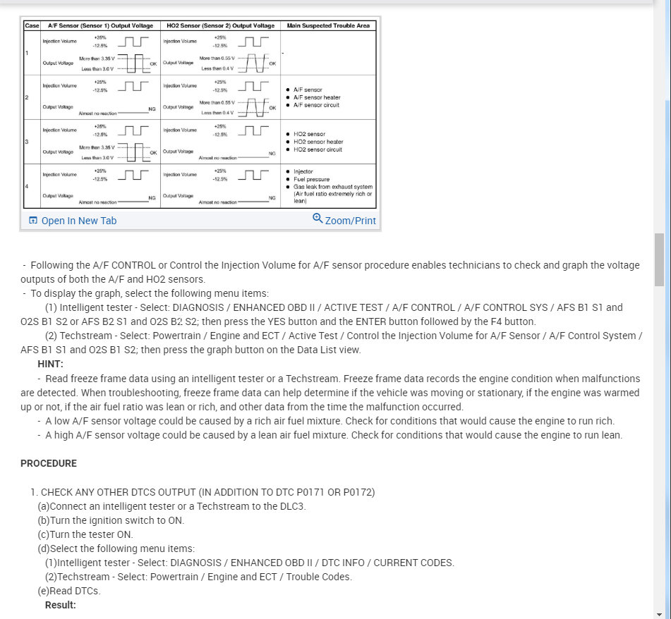

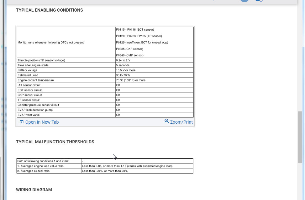

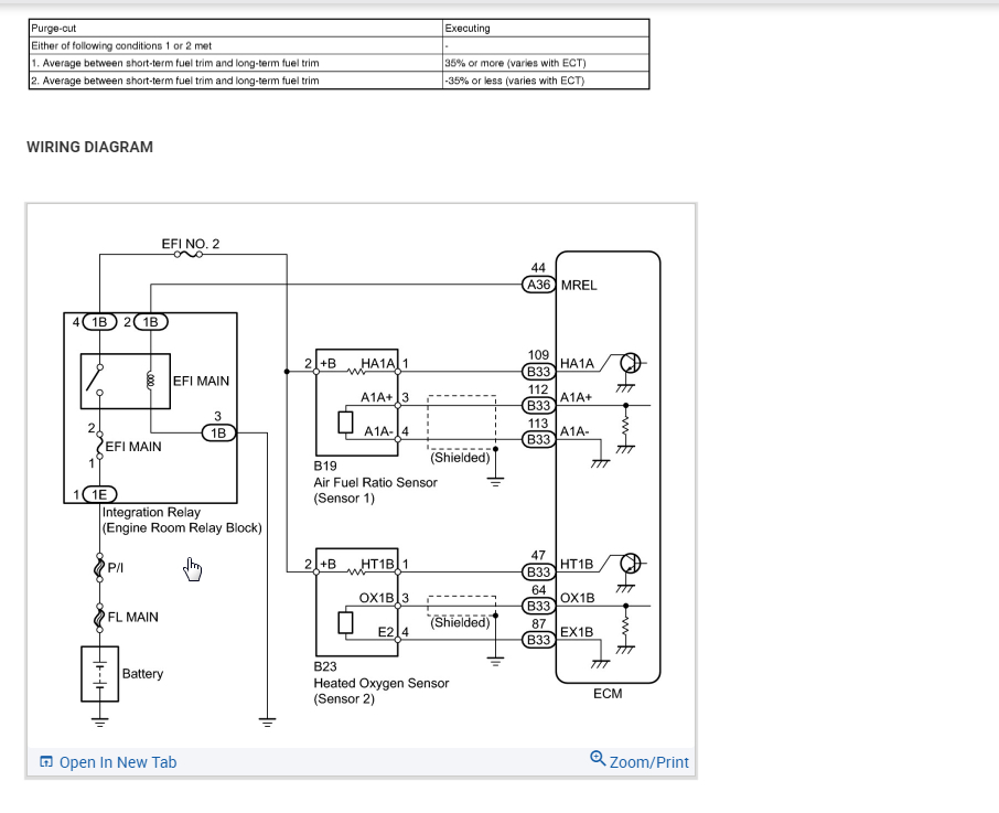

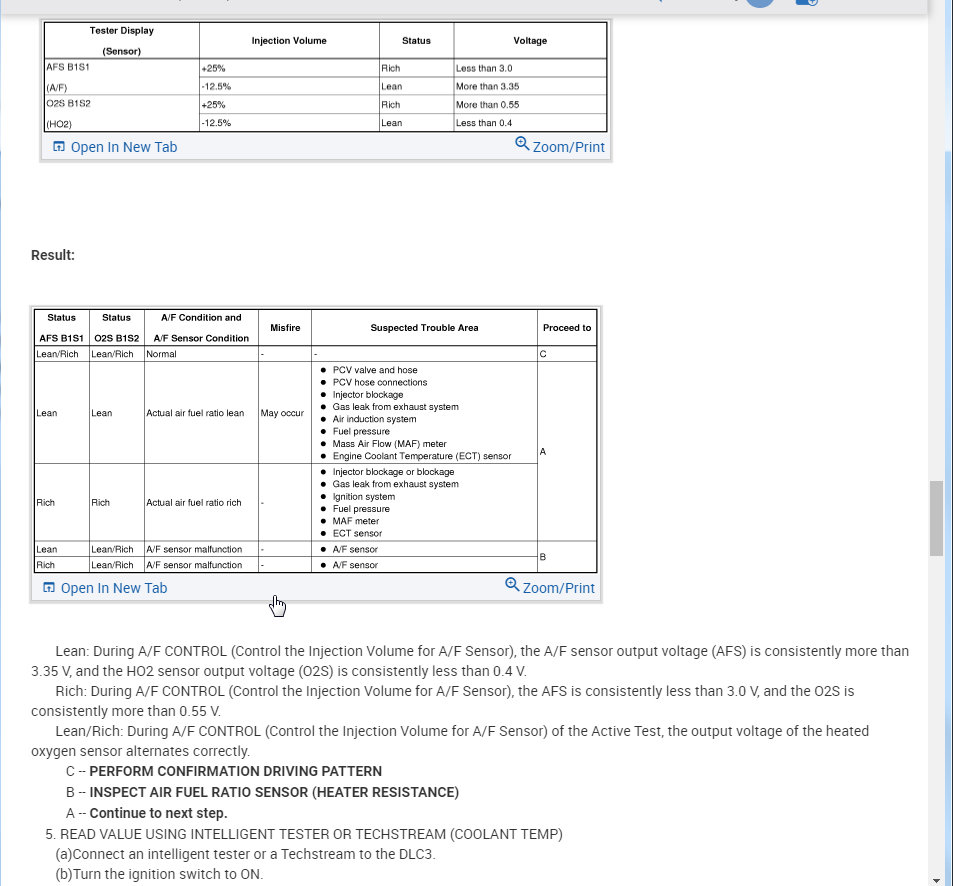

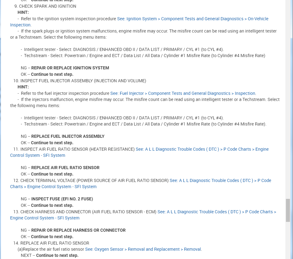

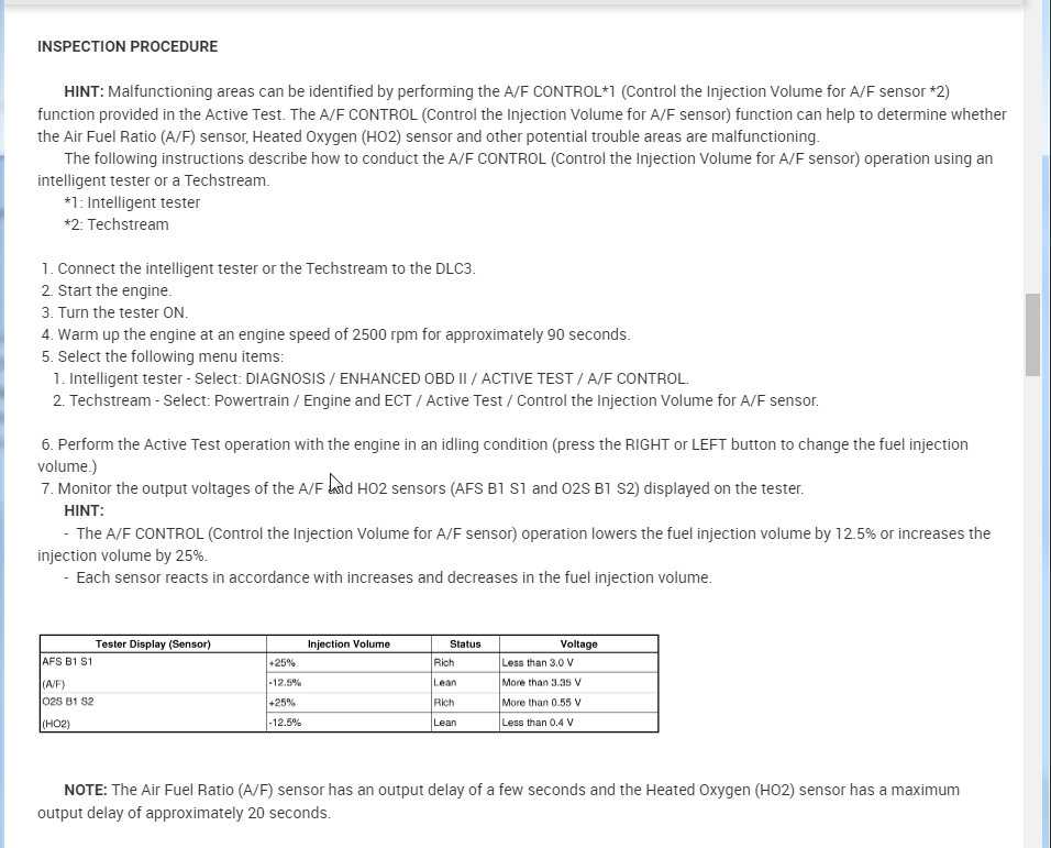

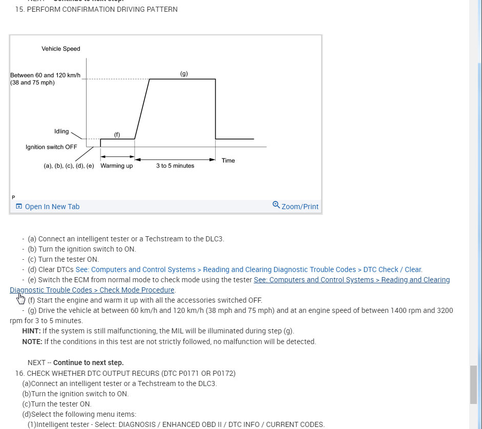

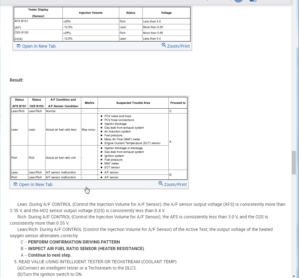

Okay. That is great info. You don't have a vacuum leak because the P0172 is actually a rich condition not a lean condition. So this means you have too much fuel. The black spark plugs would confirm this so I attached the testing for this code which is what we need to run through to find the issue. More then likely we have leaking fuel injectors or a MAF sensor issue but we will figure that out with this testing.

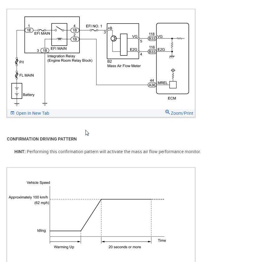

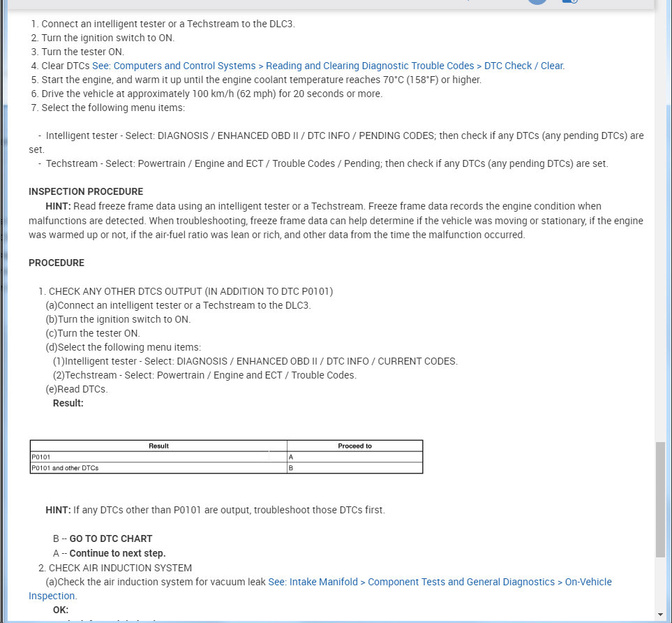

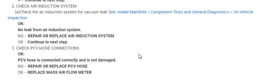

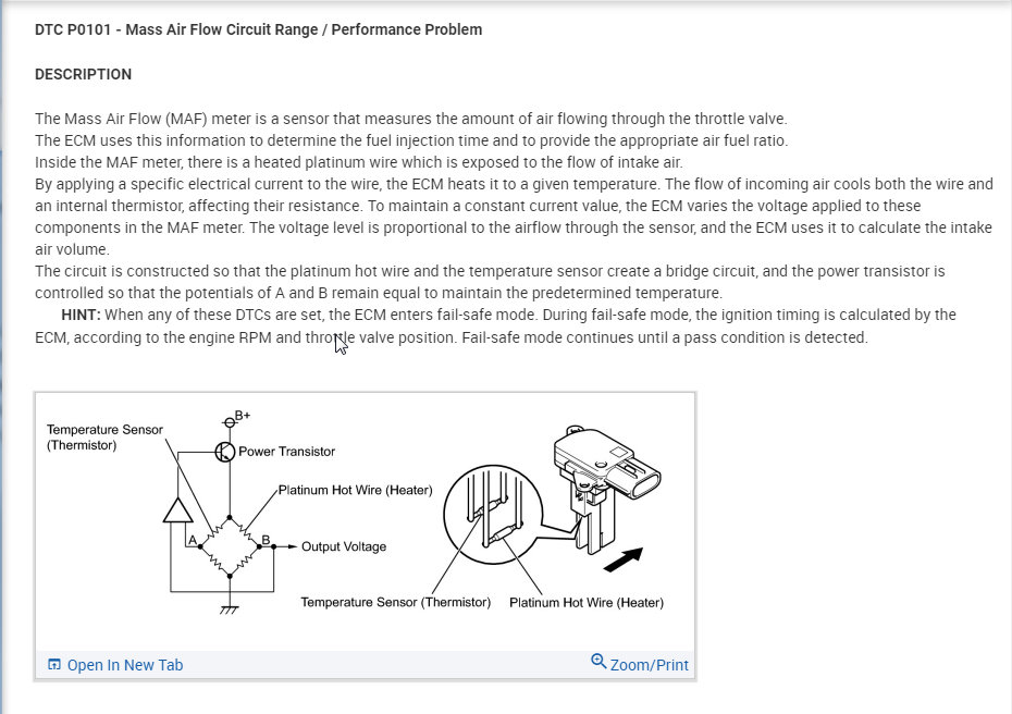

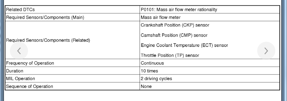

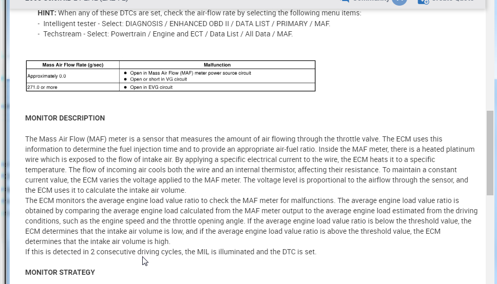

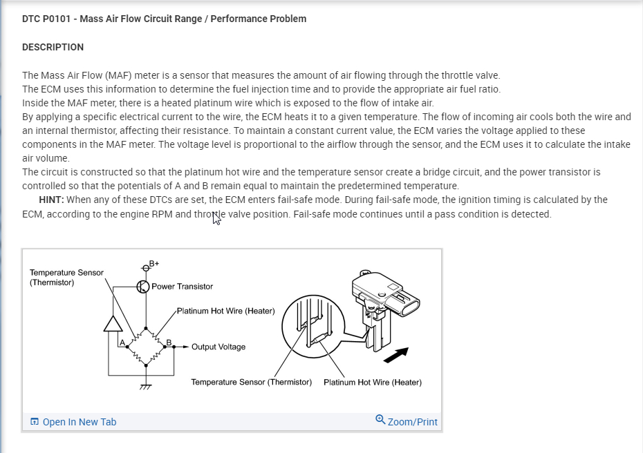

Due to the P0101 I am going to suspect we have a MAF sensor issue but since you replaced it is most likely wiring issues or a control module.
Jun 17, 2020 at 9:16 AM
Sorry. I forgot to attach the testing for the p0101 which is where I think we will end up going so you can actually start with this. If it is not wiring then the testing points to a PCV issue so we have a number of things to check.
Jun 17, 2020 at 9:20 AM
