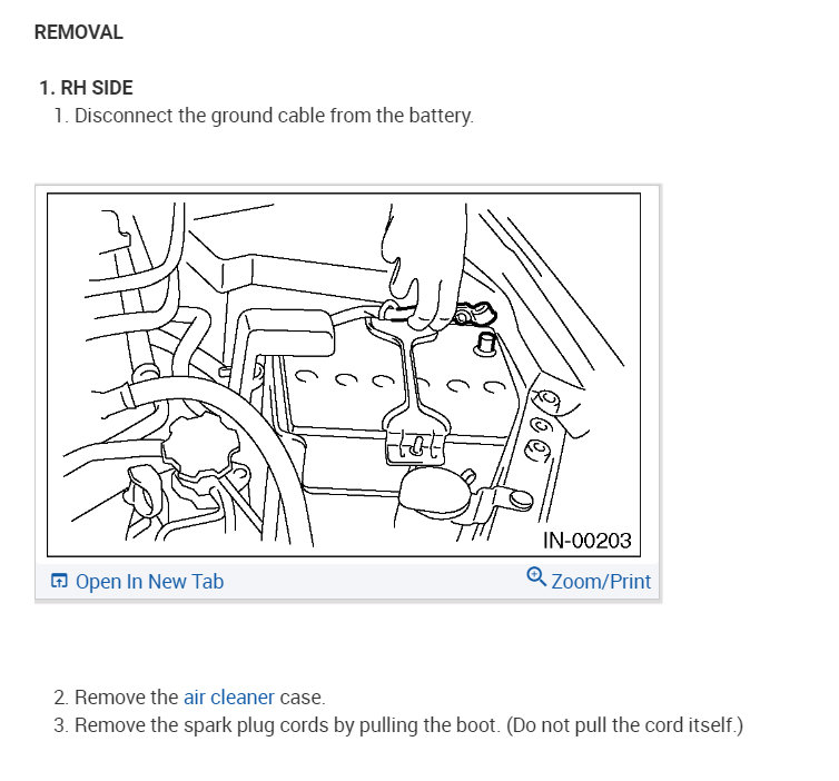

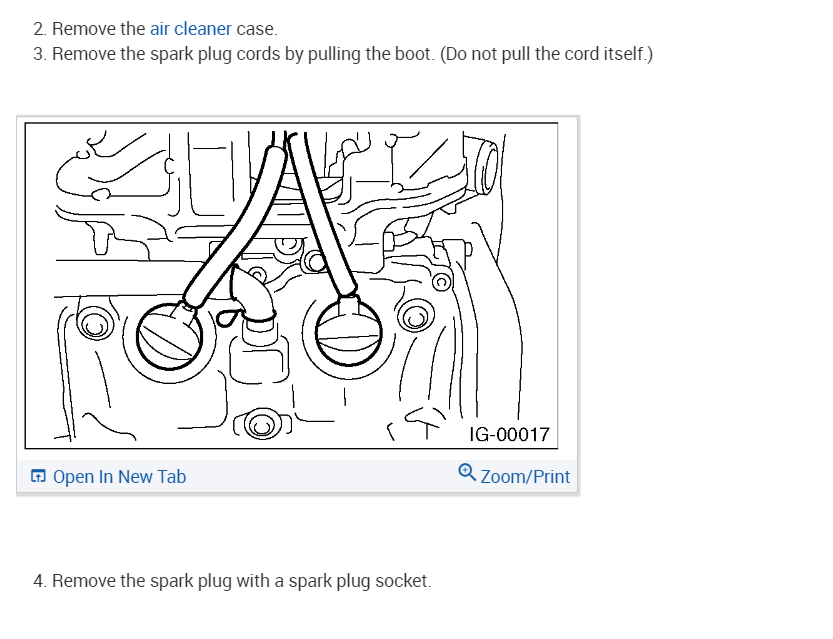

Hello.
The check engine light flashes and the anti-skid light comes on. The lights only stay on while the car is bucking. Once the bucking stops, the lights stop flashing.
The car also completely stalls when cold and won't restart right away.
I've tried to have my mechanic look at it, but I can never get it to do this when he is looking at it (of course).
Any help is greatly appreciated!

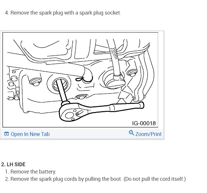

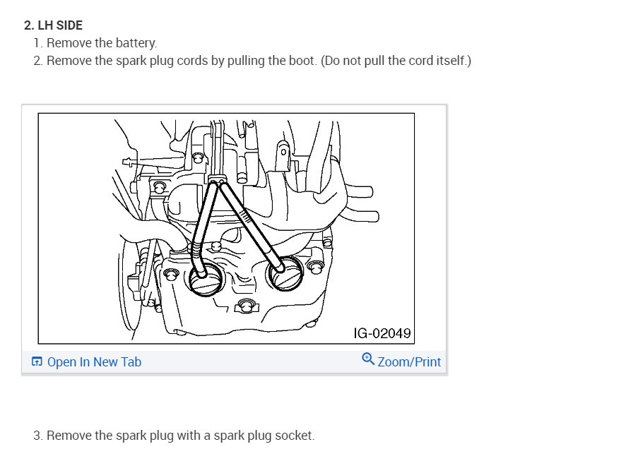

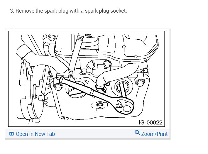

This sounds like a typical engine misfire, but we should run the codes to see what comes up. You can get a code scanner from Amazon for about $20.00.
Here is a guide/video to show you how:
Here is a scanner link:
https://amzn.to/3Qi1SS6

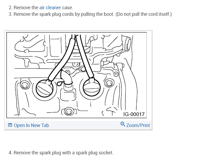

This will tell you which cylinder is having the issue. I have also included how to change out the spark plugs in the diagrams below.
Manufacturer and type .................... NGK: FR5AP-11
Thread size (diameter, pitch, length) mm .................... 14, 1.25, 19
Spark plug gap mm (in) .................... 1.0 - 1.1 (0.039 - 0.043)
Electrode .................... Platinum
