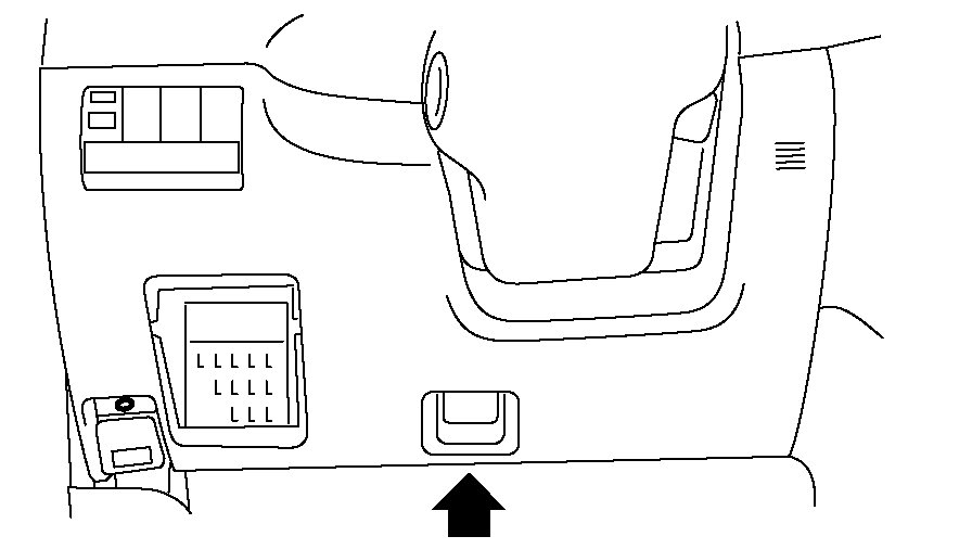

4. When using Subaru Select Monitor, refer to the following.
1. Insert the cartridge to the Subaru Select Monitor.
2. Connect the Subaru Select Monitor to data link connector.
Picture 1
3. Turn the ignition switch to ON, and Subaru Select Monitor power switch to ON.
4. Select (Each System Check) in the Main Menu.
5. Select (Engine) in the Selection Menu.
6. Select (Current Data Display & Save) in the Engine Control System Diagnosis.
7. Select (Data Display) in the Data Display Menu.
8. Start the engine, and read engine idle speed.

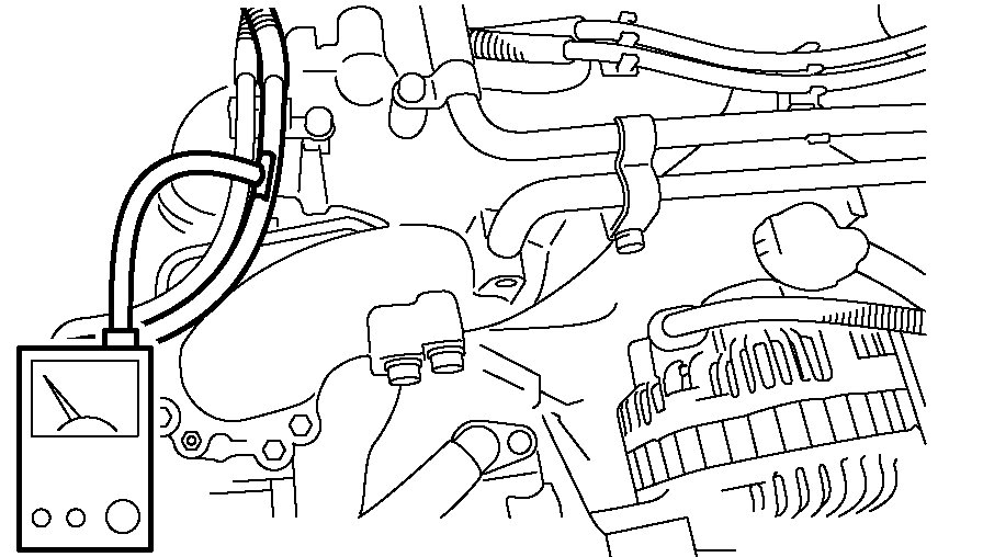

5. When using the tachometer (Secondary pick-up type):
1. Attach the pick-up clip to No. 1 cylinder spark plug cord.
2. Start the engine, and read engine idle speed.
Picture 2
NOTE: This ignition system provides simultaneous ignition for #1 and #2 plugs. It must be noted that some tachometers may register twice that of actual engine speed.
