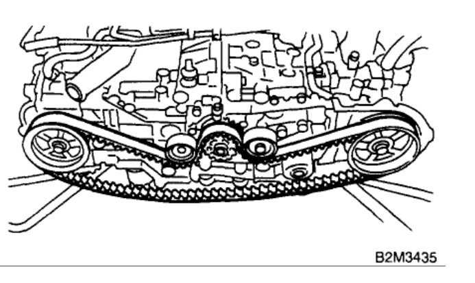

I bought a used Subaru Legacy Outback VDC. It has been a nightmare car so far as I have invested way too much money in repairing it so far. I recently had engine work done as well as a new transmission installed. Engine work comprised of replacing the intake gasket due to low compression on cylinder 6. The car seems to run fine now, however, I am noticing a highpitched whining noise as I drive. It goes up and down as I accelerate and decelerate. It almost sounds like I can hear the engine through my car stereo. Although it is not really loud, I can hear it whether the stereo is on or off.
any ideas?
Apr 9, 2008 at 7:17 AM
  • 55,395 POSTS
Check the serpentine belt to make sure it is not glazed or an accessory bearing is having a problem. Here is a page that will help you get the job done.
https://www.2carpros.com/articles/serpentine-belt-tensioner-replacement
and
https://www.2carpros.com/diagrams/subaru/outback/2002
If all checks you okay what happens is the timing belts were installed without a new tensioner making a whining noise even though everything runs okay it will take out the timing belt soon.
I have included timing belt replacement procedures for you. With diagrams (BELOW)

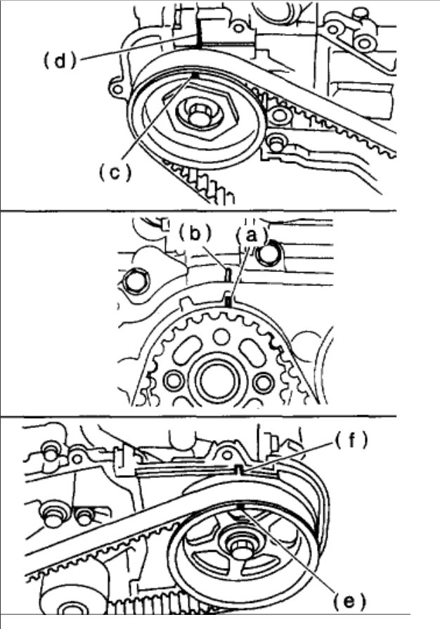

REMOVAL
TIMING BELT
1) Remove V-belt.
2) Remove crankshaft pulley.
3) Remove belt cover.
4) Remove timing belt guide. (MT vehicle only)

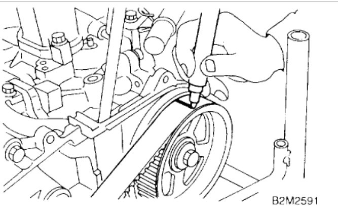

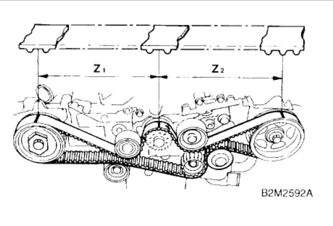

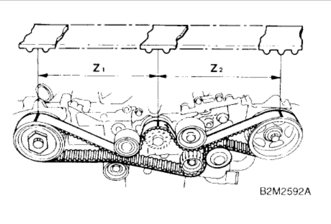

5) If alignment mark (a) and/or arrow mark (which indicates rotation direction) on timing belt fade away, put new marks before removing timing belt as shown in procedures below.
(1) Turn crankshaft using ST. Align mark (a) of sprocket to cylinder block notch (b) and ensure that right side cam sprocket mark (c), cam cap and cylinder head matching surface (d) and/or left side cam sprocket mark (e) and belt cover notch (f) are properly adjusted.
ST 499987500 CRANKSHAFT SOCKET
(2) Using white paint, put alignment and/or arrow marks on timing belts in relation to the crank sprocket and cam sprockets.
Specified data:
Z1: 46.8 tooth length
Z2: 43.7 tooth

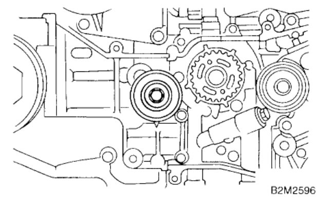

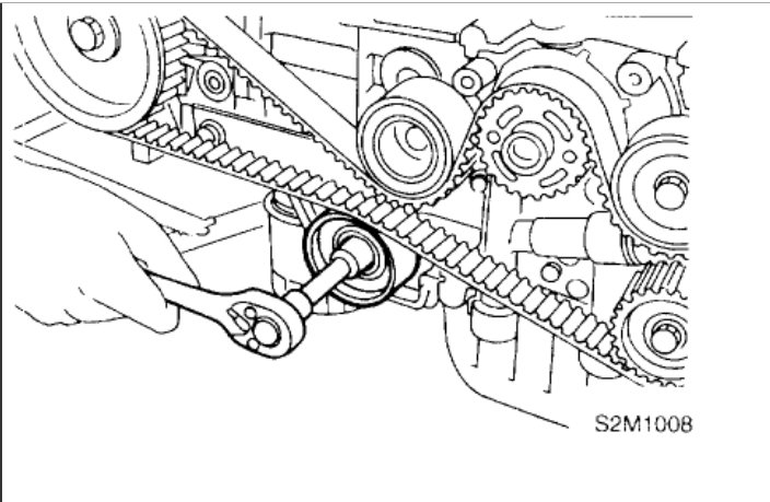

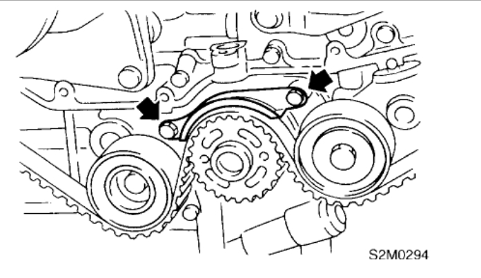

6) Remove belt idler (No. 2).
7) Remove belt idler No. 2.
8) Remove timing belt.
BELT IDLER AND AUTOMATIC BELT TENSION ADJUSTER ASSEMBLY

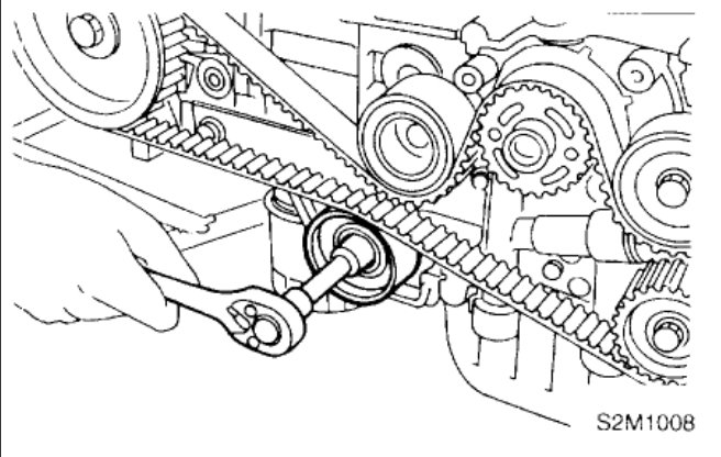

1) Remove belt idler (No. 1).
2) Remove automatic belt tension adjuster assembly.

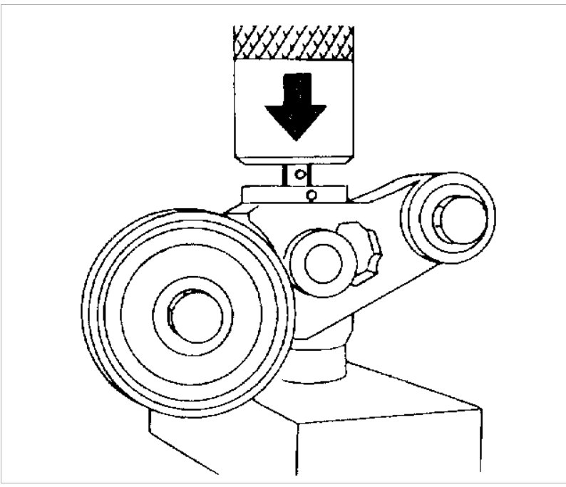

1) Preparation for installation of automatic belt tension adjuster assembly;
CAUTION:
Always use a vertical type pressing tool to move the adjuster rod down.
Do not use a lateral type vise.
Push adjuster rod vertically.
Be sure to slowly move the adjuster rod down applying a pressure of 294 N (30 kgf, 66 lbs.).
Press-in the push adjuster rod gradually taking more than three minutes.
Do not allow press pressure to exceed 9,807 N (1,000 kgf, 2,205 lbs.).
Press the adjuster rod as far as the end surface of the cylinder. Do not press the adjuster rod into the cylinder. Doing so may damage the cylinder.
Do not release press pressure until stopper pin is completely inserted.

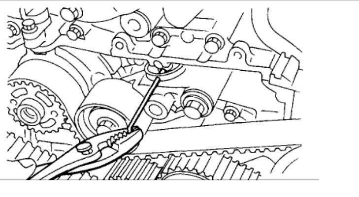

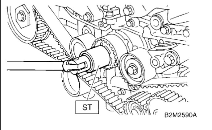

(1) Attach the automatic belt tension adjuster assembly to the vertical pressing tool.
(2) Slowly move the adjuster rod down with a pressure of 294 N (30 kgf, 66 lbs.) until the adjuster rod is aligned with the stopper pin hole in the cylinder.
(3) With a 2 mm (0.08 inch) dia. stopper pin or a 2 mm (0.08 inch) (nominal) dia. hex bar wrench inserted into the stopper pin hole in the cylinder, secure the adjuster rod.

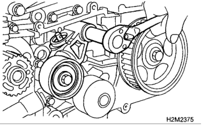

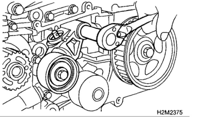

2) Install automatic belt tension adjuster assembly.
Tightening torque: 39 Nm (4.0 kgf-m, 28.9 ft. lbs.)
3) Install belt idler (No. 1).

3) Install belt idler No. 2.
4) Install belt idler (No. 2).

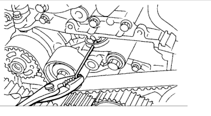

5) After ensuring that the marks on timing belt and camshaft sprockets are aligned, remove stopper pin from belt tensioner adjuster.
CAUTION: After properly installing timing belt, remove rocker cover and ensure that the valve lash adjuster contains no air.

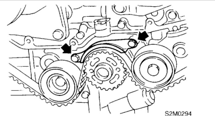

6) Install timing belt guide. (MT vehicles only)
(1) Temporarily tighten remaining bolts.
(2) Check and adjust clearance between timing belt and timing belt guide by using thickness gauge.
Clearance: 1.0 ±0.5 mm (0.039 ±0.020 inch)
(3) Tighten remaining bolts.
Tightening torque: 9.8 Nm (1.0 kgf-m, 7.2 ft. lbs.)

2) Check that the adjuster rod does not move when a pressure of 294 N (30 kgf, 66 lbs.) is applied to it. This is to check adjuster rod stiffness.
3) If the adjuster rod is not stiff and moves freely when applying 294 N (30 kgf, 66 lbs.) , check it using the following procedures:
(1) Slowly press the adjuster rod down to the end surface of the cylinder. Repeat this motion 2 or 3 times.
(2) With the adjuster rod moved all the way up, apply a pressure of 294 N (30 kgf, 66 lbs.) to it. Check adjuster rod stiffness.
(3) If the adjuster rod is not stiff and moves down, replace the automatic belt tension adjuster assembly with a new one.
CAUTION:
