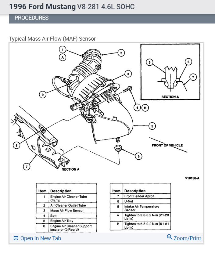

Car has replacement used engine runs great except when the car shifts and it doesn't matter which gear, it lugs and lunges like it was a standard shifting car with a rookie on the clutch. It doesn't do it so bad if you are accelerating quickly. It idles fine doesn't miss otherwise.

I have seen the MAF sensor go out causing this problem. here is a guide to help walk you through the replacement with diagrams below to show you on your car:
https://www.2carpros.com/articles/how-to-replace-a-mass-air-flow-sensor-maf
