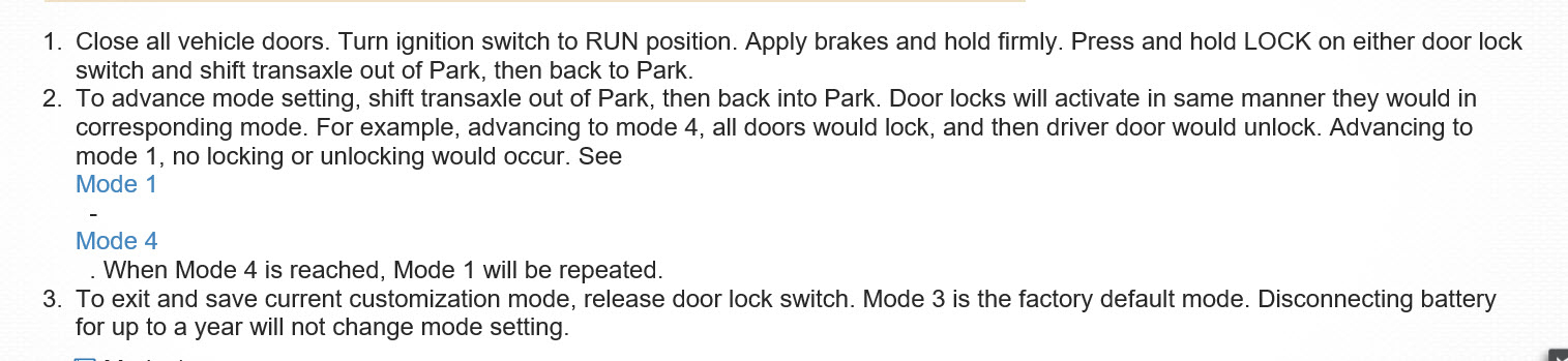

Doors will not unlock elecronically

Doors have always automatically unlocked when put in park after driving, but since having in shop to fix blown head gasket now stays locked. Noticed battery had been off while car was worked on--time on clock was off. Could some switch have been turned off and not turned back on?

Try what i'm sending you to reprogram your door locks you will want mode 3 which will go by dings or beeps
