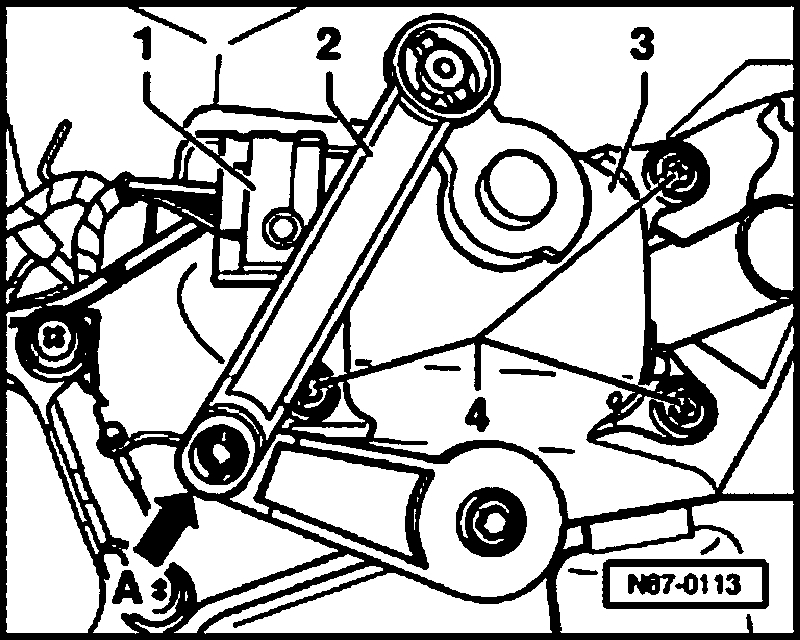

Here is what I suggest. First, confirm the coolant isn't low. If it is full, start the engine, turn the heater on high and wait for the engine to reach operating temperature. Next, locate the two heater core hoses which run between the engine and the firewall under the hood. Feel them. Other than a slight variation, both should be hot. If they are, suspect the air temperature actuator I mentioned above. If only one is hot, suspect a plugged heater core.
If you find the actuator is the issue, here are the directions for replacement specific to your vehicle. The attached pics correlate with the directions. If the coolant is full, I have a feeling something has come disconnected at the actuator, so check for that as well.
___________________________________
Temperature flap motor -V68-, removing and installing
First do the following:
- Remove glove box.
- Remove trim under steering column.
- Remove center console.
- Remove connecting duct
Removing
pic 1
- Disconnect electrical connector -1-.
- With screwdriver, carefully unclip operating rod -2- from lever -arrow A-.
- Remove screws -4-.
- Remove flap motor -3-.
