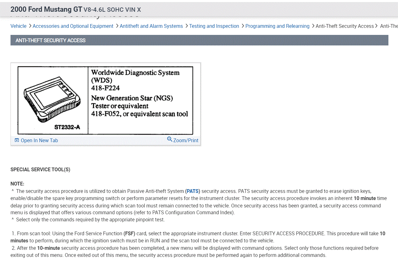

It sounds like it isn't recognizing the key. Do you have more than one key? If so, try a different one.
IF there is no change, the next step requires a scan tool that can communicate with the different modules in the vehicle to gain access to the anti-theft system.
Take a look at the attached pic below. I'm not sure what you have as far as scanners but let me know if this is something you can do.
See pic below.
Apr 7, 2022 at 6:24 AM
This sounds like a defective key or a transponder module. Basically, what this does when it doesn't start, and the light flashes is the key is not recognized.
So, we need to start with checking for codes because if we have some then that will give us the testing that we need to follow in order to figure this out.
Once we know if there are codes, we will be able to take better action but if there are no codes then most likely the module is the issue because it doesn't know there is an issue. However, the fact that the light flashes and the engine doesn't start means the module is most likely functioning. However, we need to start with this and go from there.
