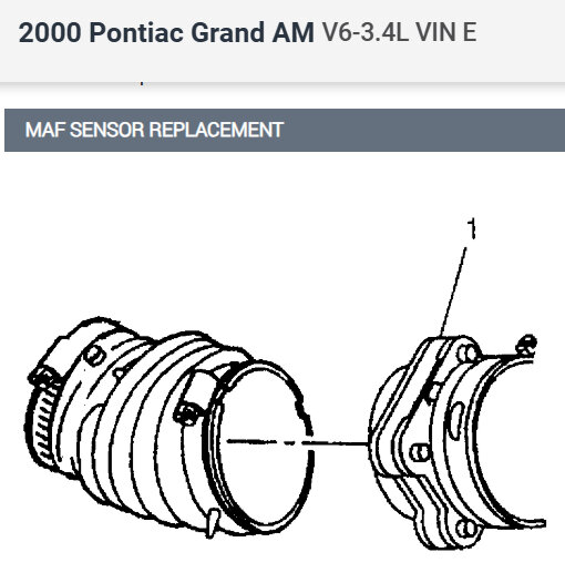

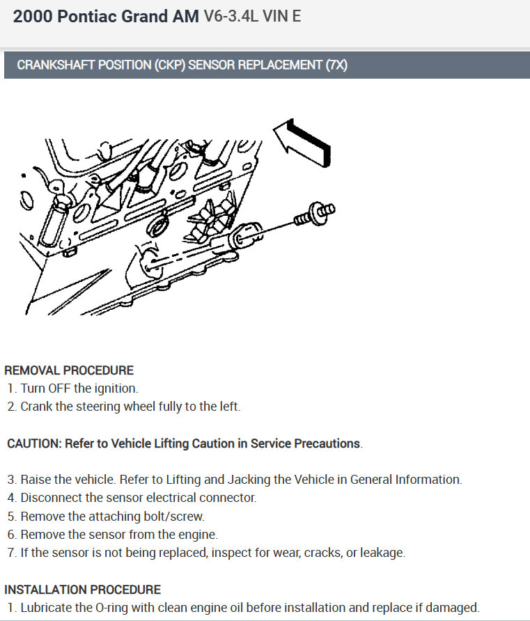

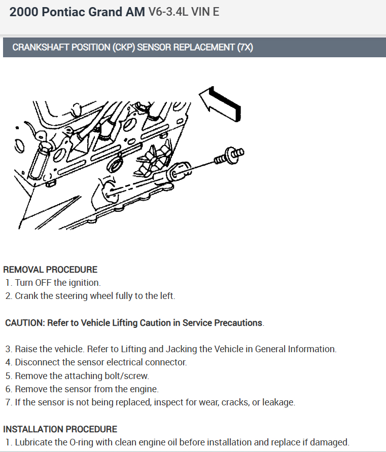

Yes, it sounds like the crankshaft sensor needs to be replaced, but can I ask if you have any codes? Also, a fuel pump locking up will cause the engine to stall like you turns the key off which the GM products of this year range had. When it will not start try to use starting fluid which can help us see if the problem is fuel related. I have also seen the MAR stop reading which tells the PCM to shut the engine off. There is also an engine oil switch that can shut the engine off as well, so make sure the engine oil is full, or the switch can go bad as well. I would go over this video to see if it can help us. As you might know there are about 10 items that can cause this.
https://youtu.be/lXLJbuAZ4CE?si=h1ySI5qDwV3M44ug
and
https://www.2carpros.com/articles/engine-stalls
Here is the location for the crankshaft sensor and MAF sensor. Check out the images (below). Please upload pictures or videos in your response of any problems so we can see what to help you with.
