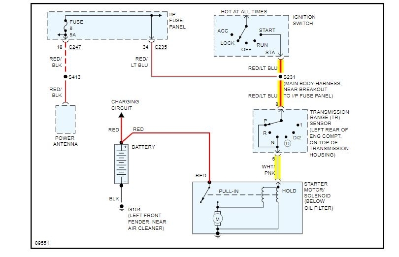

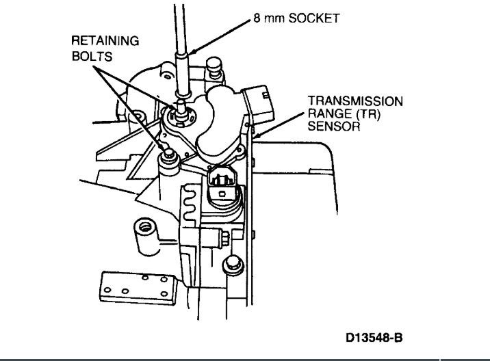

It could be the neutral safety switch. That is what you are moving by changing the shifter location. The PCM needs to see park or neutral before allowing the relay to pass current to the starter.

How can I check that (neutral safety switch)? Or do I have to take it to a mechanic? I wonder if there's a way even I could troubleshoot it? I haven't tried it in neutral. Should I? Thanks a lot.

Yes, try it in neutral and see if it starts.
You would need a voltmeter and someone to help you while you check voltages.

I have a multi-meter but to be honest, don't know how to use it. Sorry. I don't even know where that switch is. Thanks for your expertise.
Monday, August 12th, 2019 AT 5:10 PM
  • 52,797 POSTS
It is on top of the transmission.
It may be better if you had someone check it for you.
