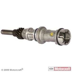

So, here is what I have now. Found the problem(s).
1st problem discovered. Camshaft Positioning Sensor -- destroyed.
2nd problem eith cause of first problem or result of 1st problem I don't know...damaged Camshaft Syncronizer. (some stores call it different names -- I have attached a photo of the part.
https://www.2carpros.com/forum/automotive_pictures/524367_Image2_1.jpg
If you look at that picture -- there is a metal part at the top that parallels the body, where the sensor is attached. I hope that is clear -- but that part was bent.
I am thinking that one of the two parts wore out and destroyed the other. Probably the syncronizer. They are original parts.
So -- I replaced the syncronizer and the sensor. Theoretically -- I figured problem would be solved.
Reality -- still same problem. I am wondering:
1. Did it maybe throw an error to the computer and the computer is preventing the car from starting (maybe damage control?) I don't know -- I am not a mechanic -- and don't know if the computer would do such a thing. Like maybe the error needs to be cleared before the car will do anything.
2. There is yet another problem that I am not seeing.
I double and triple checked fuses -- attempted a jump start...and no improvement. Now it does sound like normal when you try and start it with a jump (it needed juice.) but it still just turns and doesn't start up.

Camshaft Synchronize is what we call it too
should have no effect on the spark
very common for the cam sensor to fail and in result the sync fail
disconnecting the battery should reset the PCM (computer )
at the coil have 4 wires
check for power with key on
should have power at the white/LT blue wire
PCM pulse yellow /black, red and white
if so have a bad coil
Tuesday, May 11th, 2010 AT 9:17 PM
