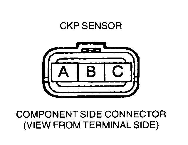

RESISTANCE INSPECTION
1. Disconnect the CKP sensor connector. See picture 3
2. Measure the resistance between CKP sensor terminals A and B using an ohmmeter.
Specification: Approx. 550 Ohm
- If not as specified, replace the CKP sensor.
_______________________________________________-

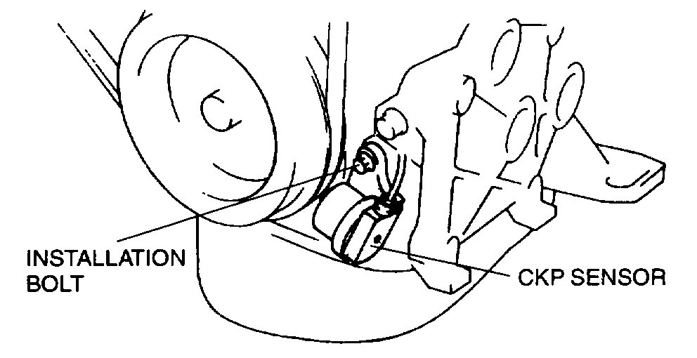

Here are the directions specific to your vehicle for replacing one. The attached picture correlates with the directions.
CRANKSHAFT POSITION (CKP) SENSOR REMOVAL/INSTALLATION
CAUTION: When foreign material such as an iron chip is on the CKP sensor, it can cause abnormal output from the sensor because of flux turbulence and adversely affect the engine control. Be sure there is no foreign material on the CKP sensor when replacing.
2. Remove the undercover.
3. Remove the CKP sensor installation bolt.
4. Install in the reverse order of removal.
Tightening torque
7.9 - 10.7 Nm (80 - 110 kg.cm, 69.5 - 95.4 in.lb)
5. Reconnect the CKP sensor connector.
CAUTION: Do not forcefully pull the wiring harness of the CKP sensor. Doing so will break the harness.
6. Adjust the air gap. (Refer to CRANKSHAFT POSITION (CKP) SENSOR ADJUSTMENT.)
See: Crankshaft Position Sensor > Adjustments

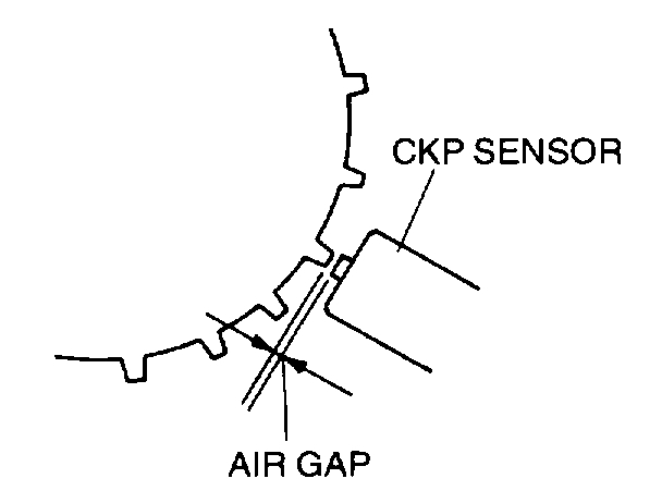

Here are the directions for adjustment of air gap.
Crankshaft Position (CKP) Sensor Adjustment
1. Loosen the CKP sensor installation bolt.
2. While moving the CKP sensor, adjust the air gap between the CKP sensor and the plate teeth on the plate using a feeler gauge.
- If not adjusted within specification, replace the plate behind the crankshaft pulley or CKP sensor.
Specification: 0.5 - 1.5 mm (0.020 - 0.059 in)
3. Tighten the CKP sensor installation bolt.
Tightening torque

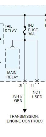

Hello again, wanted to let you know that I have the vehicle running again. Your help was greatly appreciated! To let you know the ckp sensor passed all the tests which let me to start from scratch and had found out that I had over looked the “INJ OR FIP” 30 amp fuse. This was the cause of my problems as I had replaced it and the vehicle started right up. Any chance you could give me information on what that fuse is for and possible causes of it failing?
Aug 4, 2020 at 5:17 AM
  • 110,251 POSTS
That is good news. Honestly, the fuse may have been old. However, it powers the main relay and transmission. I attached a section of the schematic for you to see. Other than that, a bad ground, the relay is going bad, or a short.
